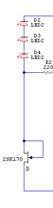

If you are talking the V1.0 that has a single Jfet local CCS for the 3 Leds, substitute a 10K 1W for that Leds Jfet, then it will take -50Vin -40Vout. With the Jfet, 35V out, 45V in max, still making it hot. Also put something on your PNP BCxxx error amp BJT, something to take some heat away, especially if to stay in a tubes amp box. For such an application you will not need more than 50-100mA current, and that to just keep the Mosfets happy. The grids won't draw. So you can up the setting resistor.

how about using semisouth R550 :redhot: ? so the best way forward to getting +45vdc out with 200-300ma is biasing with resistor? could a string of 3-4 superbright white high VF LEDs work for high V ref? I dont mind ridculous solutions for stuff, but of course will just go the resistor and regular LEDs if its the best way forward.
this is with V1 for the D1 mosfet IV
see I could double this as backlighting for a front panel feature i'm planning, where I will mill out a 80mm diameter circle in the front panel and mount my rather special momentary push button in a slightly recessed 10mm thick piece of frosted clear acrylic as well as the lemo headphone connector and titanium volume knob. the white LEDs could illuminate this rather nicely at the same time as providing power indication and high quality referrence. is this insane? :crazy:there are some nice ones from CREE at 10.7vf they will possibly need a heatsink of their own I guess
Talking about that Jfet. That one to replace with a resistor so to take the elevated input voltage and dissipation. I use a ring of two 65V Vceo BJTs there in V1.0 shunts for applications beyond 40-45Vin.
No don't use weird LEDs for Vref, they are possibly noisy.

OK got it, i'll just use a regular blue or white LED as part of one of my other circuits power on indication to provide back lighting then, was just trying to kill 2 birds with one stone (poor proverbial birds always cop it) BJTs it is, I prefer an active to passive CS
