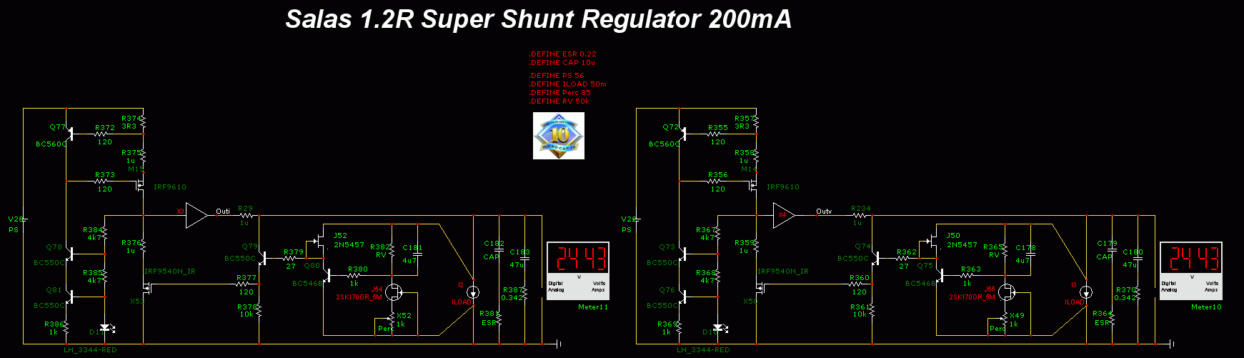

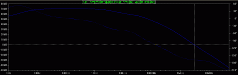

Salas - would you please post a simulation of OL gain and phase vs freq.

Phew, lots of drawing.

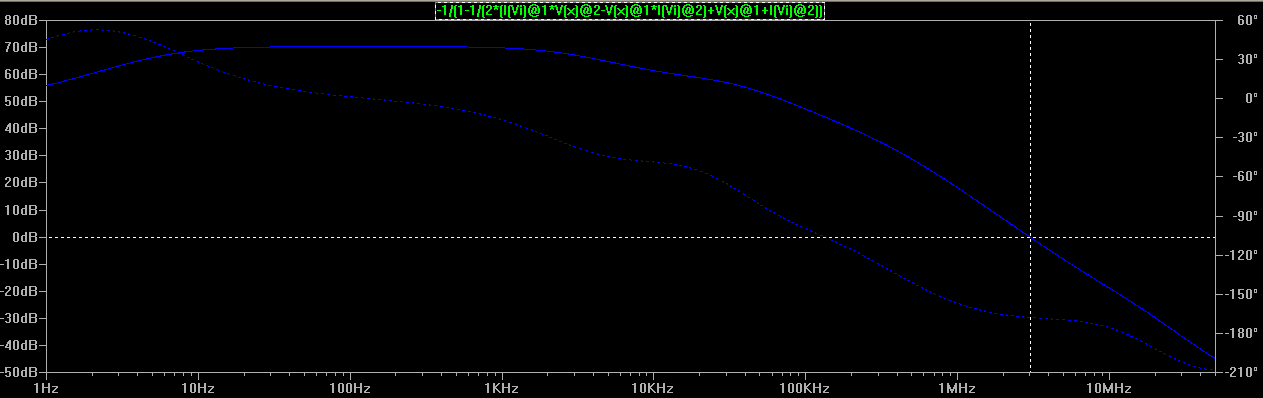

Best
/IR
The phase can't be right. It would oscillate it's head off on any small push when its steadier on scope and in use even more so than before.
Efcharistå!
Hmmmm....I guess you are correct about the phase. It would oscillate if I farted in the room

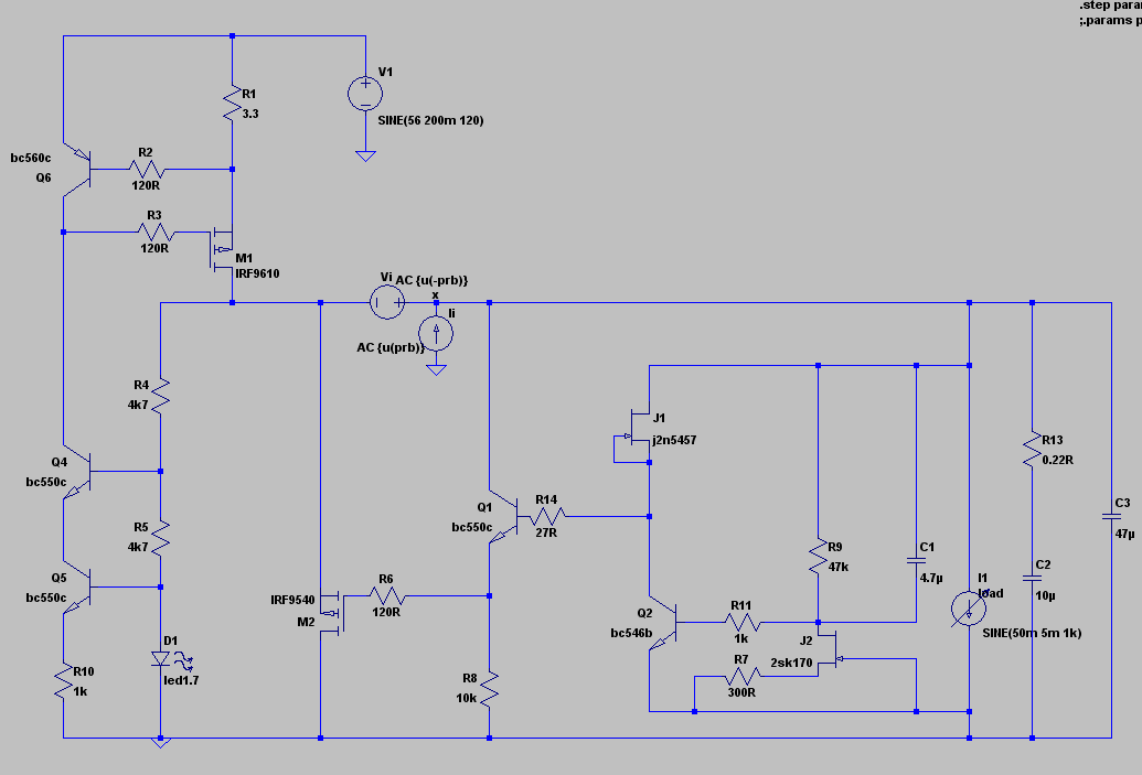

May I ask you to supply the schematic you used for the sim?

The 47u has 0.342R. I made and used this also beta tested it with other guys as you saw in back pages before I simulated it. So my modelling sucks.😀

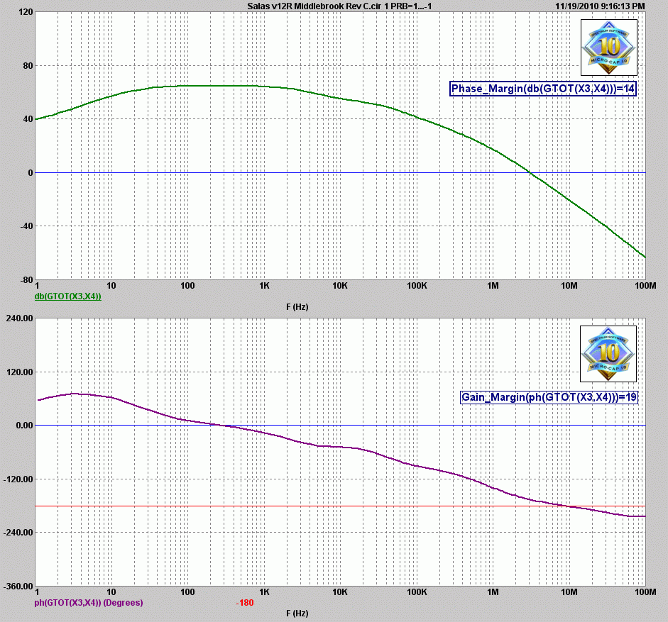

Salas,
nothing wrong with your simulation skills, IMO, but the real world is hard to
simulate.
I simmed your schematics in MicroCap10 using Middlebrook's method of stability check, and I got 14 degrees pahse margin and 19 dB gain margin.
See attachments.
/IR
simulate.
See attachments.
/IR

Hi Salas. Is the simmed a new version? V1.2 R(evisited) R(evised)? 😉
C2 10 uF(4,7) R4&R5 4,7 kohms (5,6)
That above is the R yes. The 1.2 is there: http://www.diyaudio.com/forums/powe...-voltage-shunt-regulator-190.html#post2103493
Salas,
simulate.
See attachments.
/IR
Looks like that real world layout and components in the MHz for this R mousetrap need a much more sophisticated modelling to show why it works good, repeated in different builds by other members even. Best to know would be to really measure the OLG in a lab and then see what's missing from the modelling. Our results are -2deg the same. Its better I made it first and then simulated it, because I would have thought it would not work, and would have been unfortunately skipped.🙂
