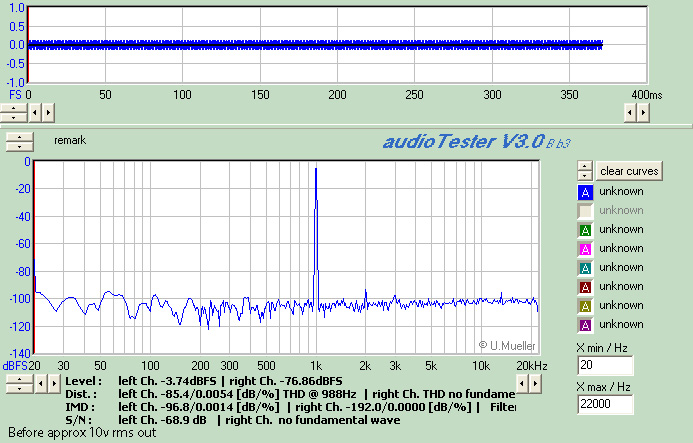

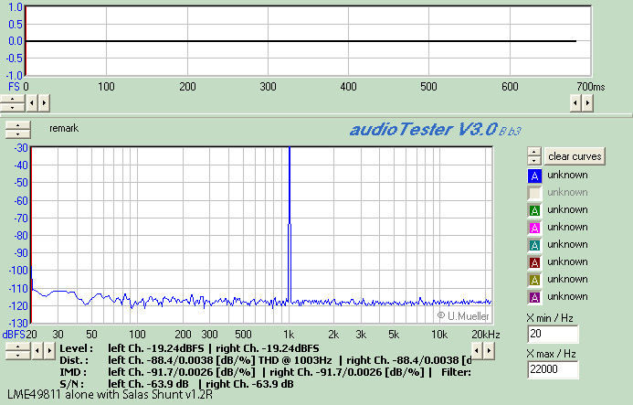

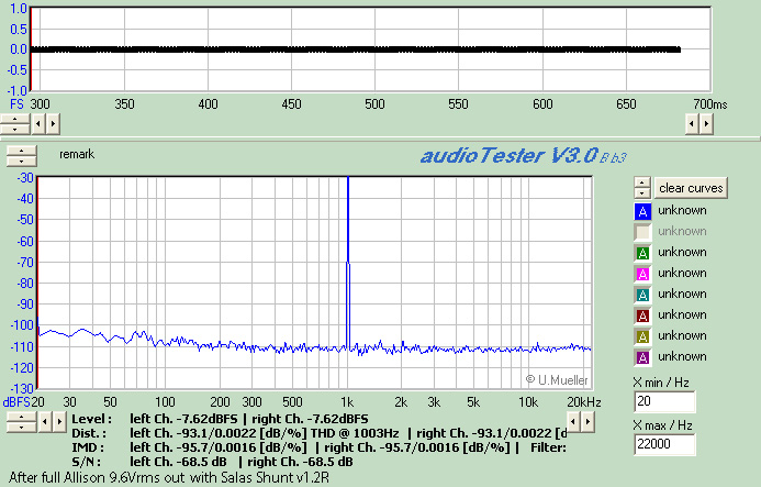

I haven't attacked the voltage rise yet, rather jumped ahead and hooked this bad boy up. The whole point was to drive an LME49811 driving a modified Allison configuration current amp output. The 49811 is driven at 60v, the output stage is driven at 32v. The before and after results tell the story.
The before was with the 49811 driven off the same 32v supply through 20ohm resistors and a boat load of MKP and litic decoupling caps.
The after show two different outputs the 49811 terminated into 100ohm resistors and no decoupling caps. The second after image is the full amp at 9.6v rms out into 8 ohms.
How does it sound. More bass, better attack, very, very nice.
Ken

10dB lower noise floor on the PSU alone? Do I get it right? What is the PSRR? Does it compute? I had reports that op amps are also subjectively affected by the reg, especially in dynamics and smoothness, it seems that the trend continues in this is larger scale chip too.

Salas,
My test setup procedures are relatively consistent, I have been able to return and re-test with consistent results. Though this time my original front end did not re-test well at all. It's been in use for 6mnths or so in an open shop environment and has degraded in performance somewhat. That said, I believe these test results. Before the shunt implementation, I was pretty proud of the performance of the chip and the entire amp and had been able to consistently get the results shown in the before shunt graph.
I'm attributing these results to the complete isolation of the VAS stage (the LME49811) power supply from the output stage power supply with it's large current swings. I expected good results from the shunt implementation, but these results are more than expected.
The application notes for the chip place a lot of emphasis on proper bypass of the power supply, recommending a combination of film and litic caps both as the power comes to the board and also at the chip itself. Along with these recommendation they also recommended separate power wires from the supply caps to the chip and to the output section of the amp. All these recommendation suggest that the chip is sensitive to the implementation of the power supply.
As this is still a prototype, I will definitely include a heat sink for the error amp bjt in the final version.
Again, thank you for all your kind words and help.
Ken

Well, your suspicions were right, a bit to good to be true. 😱 I'm using Pete Millets sound card interface. When the range is set to 20v, it jumps the scale up by approx. 10db. So the measurements were not taking at the same range settings. I got the non-shunt chip running well again, (the input wires were a bit tired) and it measures close to the shunt version. More later.

It can be subjectively better because of other parameters in the reg, or bit cleaner FFT, but the straight 10dB difference was suspicious to me with such PSRR chip.
I still believe that their is more bass and faster attack. I've concluded that the noise level/THD is below the resolution of my sound card set up. So, I'm off to order Bob Cordell's distortion magnifier.
