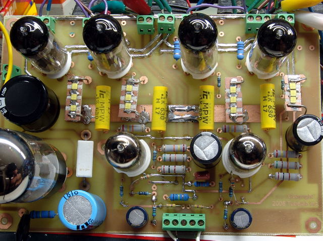

I am building a new amplifier that will look very "different". I am sure that it will look ugly to many traditionalists, but I am tired of making "tubes and transformers on a metal plate with wooden sides" amps. This one draws its cues from a variety of non traditional objects, including some photos I took of blinged out import tuner cars at a recent show. There will be pictures when I finally finish it.
During the development of the Simple SE I tried the LED bias approach suggested by SY. I found some white LED's that were used as the flash in a camera phone and wired 3 of them in series and placed one string in the cathode of each output tube. The sound quality improved (bass and transients were better) and the output power went up. What's not to like. Well, at least in my case there is just too much light. My new amp uses two Simple P-P boards each wired in PPP for a two channel amp. This makes 8 EL84 tubes, each with 3 to 7 LED's.
I have been conducting some experiments on my Simple P-P boards. The camera phone LED's are surface mount, and I only had a few of them, so I started searching for something else. The Simple P-P builder used Fairchild MV50152 LED's, but they aren't in stock anywhere. I went through the digikey catalog and ordered a few different LED's based on their calculated dynamic resistance. It seems that 3 to 5 ohms per LED is typical. A series string could have from 10 to 40 ohms. I didn't want to order 50 LED's yet until I tested them.
I also ordered a few parts to make a "CVS" circuit. What is a CVS? Well, it is an anti CCS, a Constant Voltage Sink. A perfect CVS should be like a perfect zener diode. The voltage across the device should remain constant regardless of the current through the device. It would be really cool if you could adjust the voltage with a twist of the screwdriver too. It is possible to make such a circuit with an opamp and a pass transistor, or it can be built entirely with transistors, but there is a better way. How do you make the mythical CVS? It is too easy. Look at the attached data sheet and turn to page 7. Figure 13 is what you need. Just eliminate the Vi terminal. Connect the bottom terminals to ground, and Vo to the cathode, adjust the pot for desired tube current.
Preliminary tests of the CVS reveal a dynamic resistance of way less than 1 ohm. Unfortunately I only got enough parts for 2 circuits (and I blew 1 up), but stuff for 20 more are on their way. The LM431 is specced for up to 36 volts and up to 100 mA. It will NOT do both at the same time, even if you mount it on a heat sink. How do you think I know this! The transistor should be a decent quality device with good beta. I wanted to use a row of shiny steel 2N3055's that I have had since 1969, but they didn't work as good as the little junk box TO220's that I used.
More science when the next Digikey box arrives.

What about a Vbe multiplier?
That is what I meant when I said "or it can be built entirely with transistors". I should have said transistors and resistors. The VBE multiplier works. The chip has a lower dynamic resistance (specced at 0.2 ohm). The chip with an external pass transistor is higher than 0.2 ohm, but less than 1 ohm. I will make more detailed measurements when I get more chips.
I use the TL431 all the time at my job, but did not consider it seriously for my voltage source because of its limited voltage rating and its habit of wonky modes of behavior when confronted by RFI. I decided I wanted all the circuit elements out where I could see and control them, and designed a voltage source using 3 transistors and a mosfet (4 transistors if I use a reverse BE junction as reference) that can be scaled to any reasonable voltage and current level I desire.
You can see an example of the circuit in my "Mighty Mite" thread. In that circuit, a TL431 was used as a reference (with reference pin connected to anode) for its low idle current requirement, but I've made that go away.
What would constitute a "good" CVS for this application?
Well, first lets examine what we are trying to replace. In a cathode biased amp there is a resistor and a capacitor in parallel from one or more cathodes to ground. The capacitor attempts to provide a low impedance to ground for all AC frequencies of interest. The resistor provides the bias voltage for the tube and incorporates a built in operating point stabilizing feedback.
If we remove the RC network and substitute it with an ideal voltage source (zero output impedance) we have done two things. We now have a zero impedance path to ground for all AC frequencies, and we have a fixed bias point that does not change with drive level or overload. The bias stabilizing feature provided by the resistor is gone, and we now have essentially a fixed bias situation. This allows pushing the tube harder without bias shift. The G1 resistor should now meet fixed bias specs to avoid grid current related runaway.
Now we can't get ideal voltage sources from Digikey, so we would like to make something that is as close as possible. What "ideals" are important to us?
You mention "stall current". The chip in this design, or the discrete components in the designs you linked to all require a minimum current to operate. This is the "stall current" if you connect a CVS to a single tubes cathode and that tube is in cutoff this current will not be provided so the CVS will stall. A finite recovery time will be required to restart. This condition must be avoided. As with LED bias, the solution is simple, a resistor from one of the supplies is used to provide a bias current that is greater than the stall current. Another option exists too. It is possible to run one CVS to both tubes in a P-P pair since one will always be conducting, thus eliminating stall current issues, but matched tubes may be required. I tested this, in fact I wired all 8 tubes to the same CVS and it worked reasonable well.
Low Z is important. In fact it is the reason for doing this. Ideally we want a zero output impedance for all frequencies. In reality the output Z will increase at the frequency extremes.
