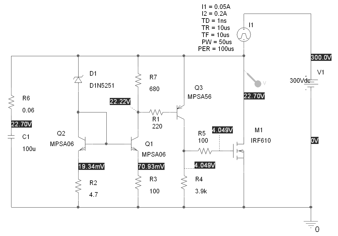

Here is the first in a series of discrete shunt regulators for cathode bias duty. This one is similar to a circuit that I'm using to power a JFET RIAA preamp in the works. This regulator absolutely dotes on a lage shunt capacitance - the capacitor and regulator work synergistically together, resulting in low output impedance and fast, stable response. Just imagine the regulator as replacing the resistor in a traditional RC cathode bias network. Capacitor C1 and resistor R6 represent the capacitance and ESR of a good quality electrolytic - the values were taken from those typical of a Panasonic FM series 100uF, 50V capacitor. The circuit is hammered with a current pulse with a quiescent value of 50mA and a peak value of 20mA, with 10usec rise and fall times. Even George would be hard-pressed to hammer that hard on an amplifier. Simulation results are shown in the next post.

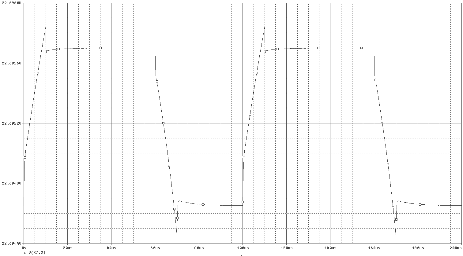

Attached here are the simulation results. The DC delta V for an excursion of 50mA to 200mA is 1.05mV. Since the current excursion is 150 ma, the DC output resistance is 1.05mV/150 mA = 7 milliohms. The transient voltage excursion is 1.4 mV, making the transient output impedance 9.3 milliohms.
This is of course a simulation, so that actual results can vary due to actual vs real parameters, and due to implementation (layout, etc). Still, the simulation looks promising. Next up, I'll try eliminating the big electrolytic by using an internal compensation cap.

Wrenchone, is your q3 buffering your current mirror to the shunt fet? I think it will cause dynamic changes in the loop gain shape and stability margin as the current goes up and down beyond being beneficial on lowering in value and opening in frequency the impedance. Did you simulate the transient without q3?
Well, the circuit I posted first is a bit scary and slippery and probably way higher octane than anyone needs for either SE or P-P applications. This is not to say it won't work, but it's probably ambitious overkill. I was backtracking this afternoon and took a look at the bias circuit I did for my "Mighty Mite" SE amp, which does address your concerns. It clocks in at about 0.5 ohm impedance, which is still better than an LED array, and in a much smaller package. I may throw in a small bone to Stu and post a version of that circuit using a single LED as the bias reference. If I remember correctly, I already posted one in my "Lafayette LA-234" thread. We could call it the "One Light District". At any rate, use the search function to get to the "Mighty Mite" thread (also in the tube section), and you'll see the circuit. Any of these electronic bias options, even the TL431, will need some keep-alive current when used in an SE amp. With the Mighty Mite, I used a resistor from B+ - ugly, but sufficient. I used a TL431 as the voltage reference, as it had a low incremental impedance with only 1 mA of current flowing through it. Since I was using an SMPS that already had a 13V filament supply, I could have used a green or deep red LED instead and given it 10mA or so from the filament supply to bias it up.
Salas - Q3 is a voltage gain element. Of course it will cause changes in the loop gain and stability margin. It also drastically lowers the output impedance. Hanging a largish low impedance cap across the regulator does the trick for stabilizing the circuit. The shunt regulator doesn't allow the cap to charge up during transients, and the cap pads down the HF gain. It's kind of a win-win situation. Fed with a current source, this is the regulator I use for my latest RIAA amp.
