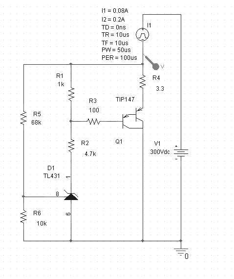

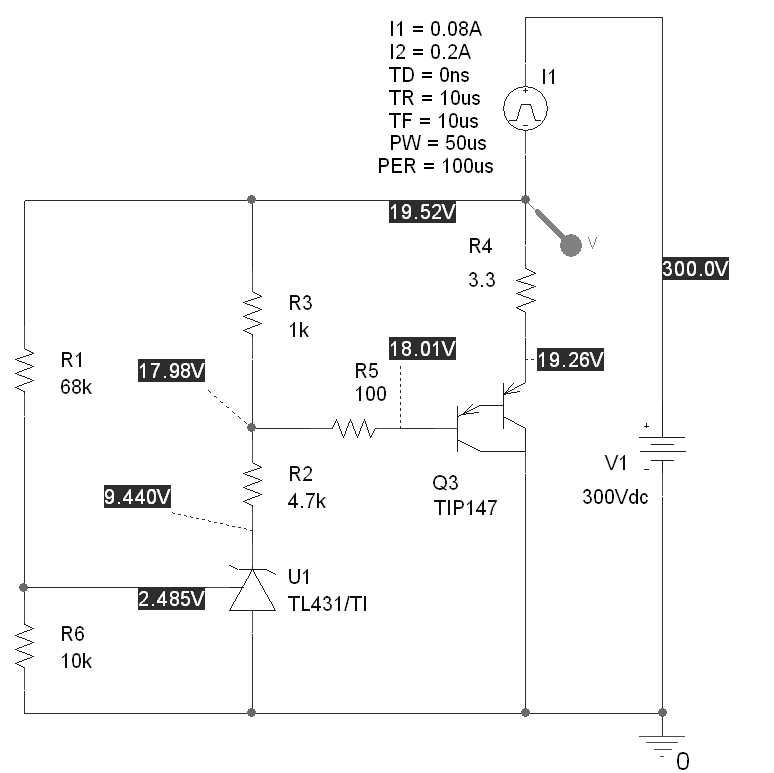

Today I looked at a simulated cathode bias regulator using a TL431 (the model used was from the TI library in PSpice) and a TIP147 pass element (uggish 100V, 10A PNP Darlington in TO-3P package from TI and many others, readily available). The results were surprisingly ok (though I subscribe to Sangamon's principle and don't really trust models of more than a few components). Results were better in simulation without a compensation capacitor.
George - since you brought this one up, it may be useful to hang a probe across your TL431 cathode bias network with AC coupling and catch some waveforms of your amp banging out some square waves. I'll post my simulation results when I get back to work next week, though I will say up front that they looked fairly benign. I'm very interested to see how the real deal compares to the simulation. In the simulation,a lot hinges on how much emitter degeneration resistance you place on the Darlington pass element. It's be a compromise between zippiness and low impedance vs. good pulsed behavior.
For people that don't need a lot of bias voltage (I would draw the line at about 25V or so), this may be a perfectly ok way to go. I reserve judgement a bit, as I want to see how the regulator handles the tube and the transformer leakage inductance.

Here is the simulation schematic for the 431 shunt regulator, set for about 20V. The ratio of R1 to R6 adjusts the output voltage.

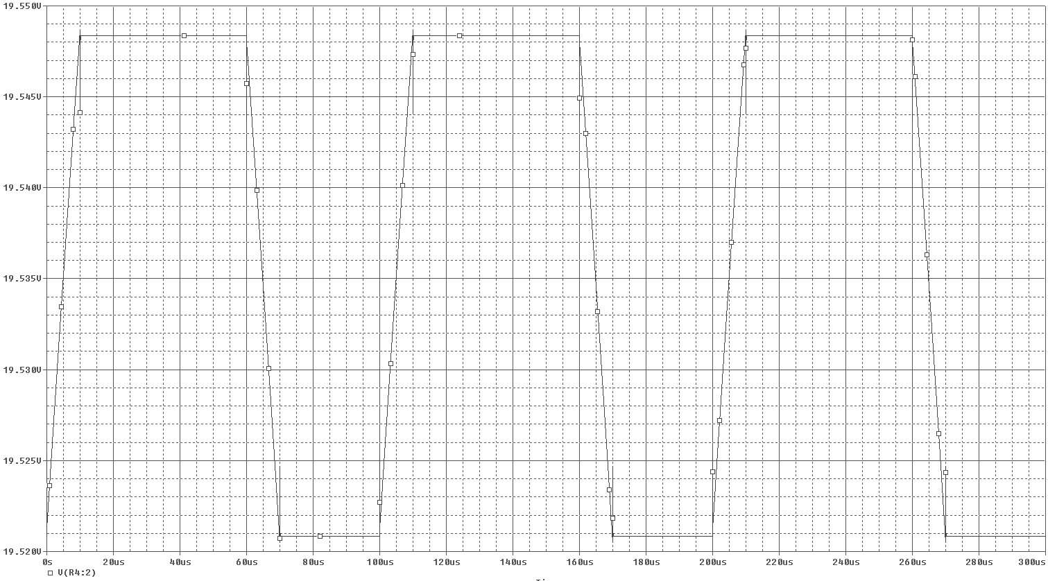

This is the simulated response to a healthy whack in current. Adding compensation in the usual way just screws things up. Keep in mind that this is the response of the TL431 model - the real deal may act differently, expecially under large signal excursions.
