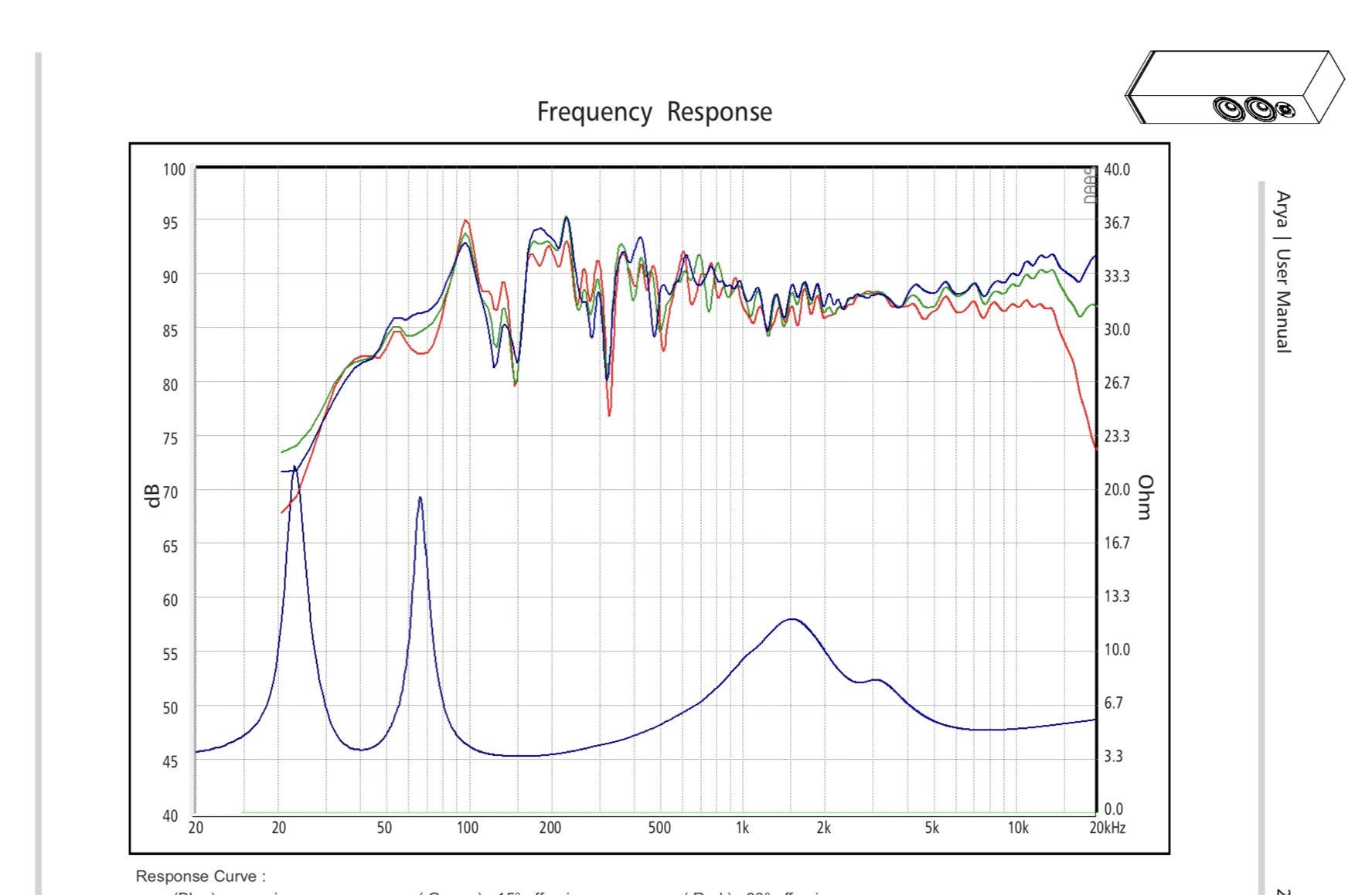

The SB Acoustic Arya kit is a great one that fits your setup i think. I know people who use it (strlctly classical music) with a 35w tube amp (older Prima Luna EL34 based amp) in a decent size living room and they don't lack nothing they say. They also got a few subs that are now living in the attic as they don't need it anymore in their living room ...
That kit is sold here (from NL): https://www.soundimports.eu/en/sb-acoustics-arya-rosewood-hg-kit.html (and probally other places also, google it for the best price). It's all in one, and the cabinet is already finished i thought.
It's a popular design, and when i heared it it sounded very neutral and clear without being sharp. I did not see measurments of it yet, but i don't think it's very coloured or bad designed. It's good at short distances (like you wish), not for a very big space at loud volume.

It's hard to tell wihtout seeing the room, but it looks a lot like it's the room mode from their measuring room. You also see that in the spec sheets of the individual drivers. But at least they don't smooth the graph out like most do to hide resonances. The woofers i used from that barand are solid performers, on the higherst level of hifi drivers (comparable to Scanspeak and Seas and so).
