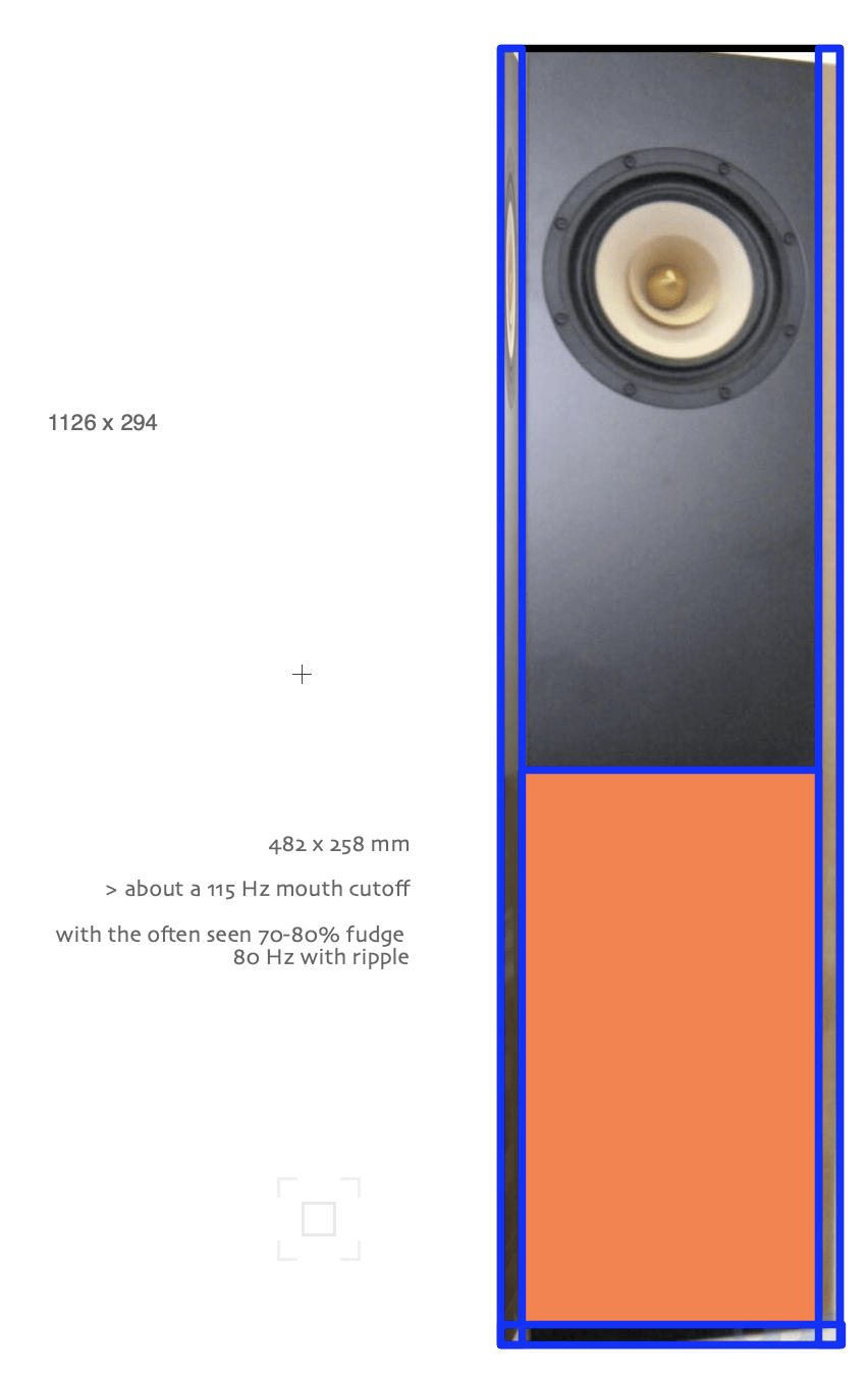

A quick estimate suggests any response below 80-115 Hz is “transmission line” action (sitting on the floor). The ripple is a sihn it is turing into an undamped transmision line.
.. And..? Does that explain why your speakers are a horn? Hint :it doesn't. At least this speaker works as a horn above the frequency. Which you can also see at the spl. And the coupling to the ground is something you ignored at your estimate on the TB horn.

- A horn is a pipe that expands toward the terminus. Period. It may or may not be impedance matched down to its QW cutoff frequency (determined by the actual terminus size when any relevant intended boundary loading is factored in). Ideally it is, many are not. In the latter case, the BW betwen the QW cutoff frequency & the point at which the effective terminus size results in impedance matching is supplied by resonant action. Some never are, over their functional operating BW -some of hm's interesting designs are good examples of that. The point of commonality is that they all to some extent share some basic 1/2 wave characteristics. Rocket science this ain't but it's a point / a few points often overlooked.
- In simplistic terms, a bass horn should only be functional up to the mass-corner frequency of the drive unit, providing a/ an effective acoustic LP is designed in (at least 2nd order, preferably 3rd order), b/ that mass corner frequency is no higher than 300Hz, and c/ [related to b/ previously] the expansion path length is not so great as to introduce audible GD in the intended operating BW. If it is, then you are going to be either accepting that as a compromise over xyz BW defined by the expansion pathlength and the acoustic LP, need to shorten your bass horn & accept a higher tuning as a result, or provide an acoustic LP at a lower frequency and introduce some form of short, BW limited midrange horn to 'fill in' the resulting amplitude gap, which is what you see in something like a Tannoy Westminster & other compound designs.
- Some bass horn designs may have abrupt (or not so abrupt) discontinuities deliberately inserted into their expansion path to provide a low-pass filter effect. This can be achieved in various ways, ranging from bend profiles to dedicated features. This goes back to the dawn of hi-fi and horn design, so is a very long way from being either news or even unusual. An efficent designer (in my view, so this sentence is purely opinion & you can form your own views about how little / much that may be worth) will always attempt to achieve 'the most with the least' assuming there are no other considerations at work, so when possible, they may exploit a folding scheme or the features of an OA configuration to help provide that if / when desired.
- The amount of gain needed (note all horns that expand in only one dimension [e.g. have parallel sidewalls] are technically parabolic if you do the maths) should be determined in the design process & for practical purposes within the target range of driver specification / specifications is essentially a function of the QW tuning, the available enclosure bulk and the intended gain boundary operating conditions (the 'actual' bulk). Ideally you'll provide as much as you can & then damp out what you don't require, on the principle that too much is always a good thing to have as you can do something about it. Unfortunately, that tends to run into the brick wall of practical realities, so when designing a generic enclosure where size is limited, I personally aim to provide a reasonably balanced output within the design requirements as there isn't sufficient bulk to provide an excess unless tuning is raised to some unreasonably high frequency.
