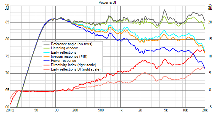

...In post 309, what technology/software did you use to measure the Infinity IL10? You plotted Listening Window, Early Reflections, and Sound Power. You also plot the Directivity Index. How did you do that?
In Toole's book he discusses a robust method of averaging the curves from a number of angles and this is equivalent to "listening window"... a different set of angles is "early reflections", and yet another set of many many angles is "sound power"... When one compares sound power to listening window, one gets the DI. Is this what you did? It seems very time consuming...
Thanks....... Jim
Jim, that graph is from audiosciencereview.com. Amir has a Klippel NFS.
Well crud, right there on the plot is says audiosciencereview.com... I missed that... 😕
Sounds like there is interest play around with CTA2034 spinorama or diverse other type of directivity plots etc on ones own computer for IL10 in this case, then for info Amir share a zip-folder at each acoustic review into post 1 that include two txt-files covering hor and ver anechoic spin in 10º steps, free VituixCAD can handle that spindata after converting those two txt-files of Amir to 72 times selective txt-files (one per 10º step hor/ver), a MS Excell 2010 spreadsheet with macro can handle that conversion in one click per hor/ver txt-file of Amir's and is avaiable including guides in this link over at ASR site Quick start guide for spinorama presentations in VituixCAD using Amir's shared spindata | Audio Science Review (ASR) Forum.
Below is Amir's IL10 spindata presented and printed from VituxCAD and so was the polar prints into post 314.

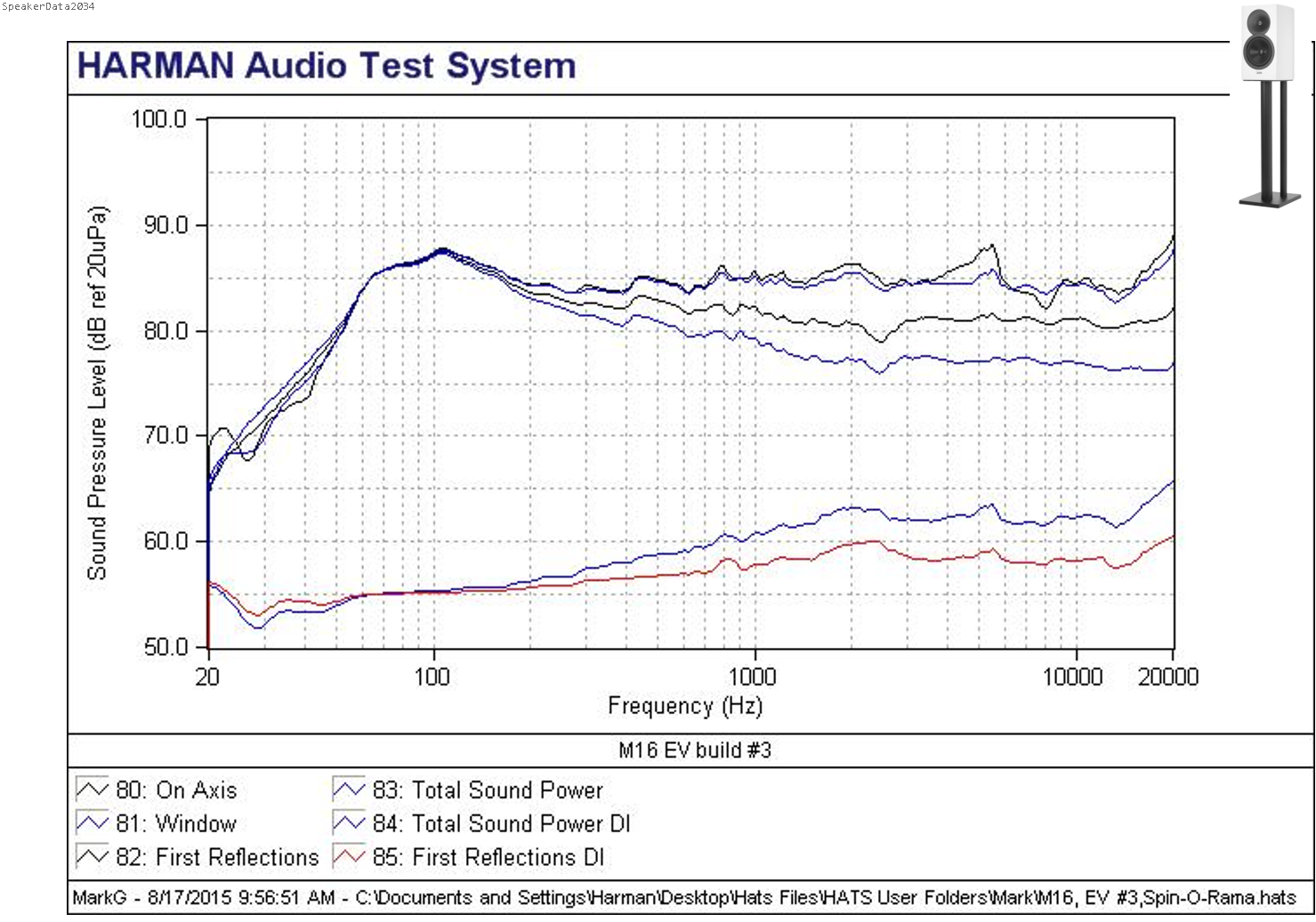

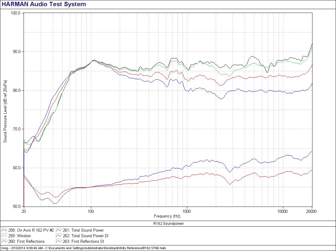

I personally think in terms of differentiation rather than handicaps; manufacturers color their products to make them sound different, which consumers interpret as "better" just because they hear something different. However, in those cases you get a lot of marketing associated with the coloring: you can hear the warmth, experience the air, it's musical and gives me a shiver up my leg.
The R162 is marketed as a reference so my intuition is they did not handicap -- or color -- the speaker. The R162 is also a lower priced model so I wouldn't expect it to be colored. I'd expect them to design it so it performed as well as possible within price constraints. Personally, I'd be inclined to think a more expensive speaker is colored rather than a less expensive speaker. But you made me curious so I searched for spinoramas.
They look really close and the differences are probably just due to component quality/construction. I freaking LOVE that. It's like finding an inexpensive wine that tastes like an expensive wine. Good job, Inifinity.

"Personally, I'd be inclined to think a more expensive speaker is colored rather than a less expensive speaker."
I think I'd go one further and say that I want to see performance graphs on any expensive speaker. At $500 the Revel M16 looks like the tippy top of the high end to me. If a company wanted more than $500 for a similar product I'd want proof of magic (e.g. the lovingly fabricated Wilson TuneTots @ $9,800/pair.)
Yes, it's nice to know they are in the same ballpark. There are some nice PEQ coeffecients available for them on the ASR review thread. I can easily implement those at home, not so much at my girlfriend's.
I have a hard time believing the driver spacing was a choice to 'colour' them in any positive way though. Unless I'm missing something then I don't see the purpose for wave lobing. In the R253 three way the spacing is tighter, likewise with the center channel.
