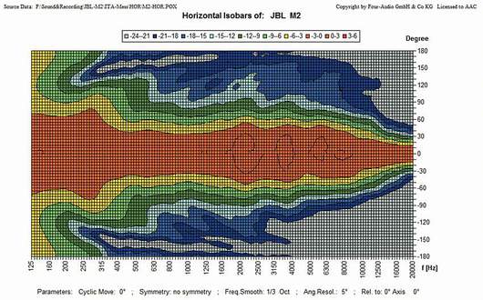

On another note, more directly related to the opening post, I can't help but wonder whether the M2's off-axis response is as good as the published curves imply. Let me explain:
If you look into the throat of the M2's horn, you'll see "knuckles" at north, south, east and west. These knuckles are presumably diffractive devices which spread the high frequency energy far wider than it would otherwise spread, at least in a fairly narrow north-south wedge and another fairly narrow east-west wedge. At other angles - those which don't illuminate the "knuckles" - there is little or no such pattern-widening diffraction. So the shape of the radiation pattern along the diagonals will be significantly different; it won't be so wide and uniform all the way to the top of the spectrum (not that I'm advocating aggressive use of diffraction; just making a speculative observation).
In other words, I suspect that the impressive off-axis curves of the M2 are only valid within a fairly narrow range of angles. I'm not claiming this alone EXPLAINS the results of the shoot-out, but it might be a small contributing factor in the discrepancy between the M2's impressively competitive measurments and disappointing subjective performance vs the Salons.
I think preference for the Revels is primarily because their wider pattern results in more late-onset, spectrally-correct reverberant energy, which contributes liveliness and spaciousness. "Late" in this context meaning "more than 10 milliseconds behind the direct sound". This figure is somewhat arbitrary but it was mentioned by Geddes, and it corresponds with my own observations from many years with dipole speakers (mainly SoundLabs but also Maggies and Quads and Martin Logans), as well as bipolars (my own). When dipoles (and bipoles) are far enough out from the wall behind them (ballpark 5 feet), they sound much better than when they are too close to the wall. This difference is the arrival time of the backwave.
Regarding the stronger early reflections of the wide-pattern Revels: Toole finds the increase in spaciousness and "apparent source width" from fairly strong early same-side-wall reflections to be a net benefit, while Geddes disagrees because it comes at the expense of imaging precision and clarity. Later reflections contribute to spaciousness (and timbre, assuming they are spectrally correct) without much if any controversial downsides, given decent room acoustics.
So at the risk of over-generalizing, I think that, in this case, the increase in beneficial late reflections from the wide-pattern Revels more than offsets any detriment from the increased energy in the early reflections.
My personal preference is to use narrow-pattern speakers with a lot of toe-in to avoid strong early same-side-wall reflections, and space them a bit further apart than normal to recover a bit of soundstage width. Then I like to add a bit more energy to the reverberant field in a way which doesn't contribute any more energy to the early reflections. Bill Waslo describes one way of doing so:
I recently added rear "ambience tweeters" aimed to reflect off the walls and ceiling behind the main speakers and fed from a ~20msec delay. That preserves the solid image while livening up the overall sound...
Imo this is a fascinating topic which goes to the core of the perceptual differences between competent designs which embody competing schools of thought. Wish I had seen this thread earlier; I don't get over here as much as I should.

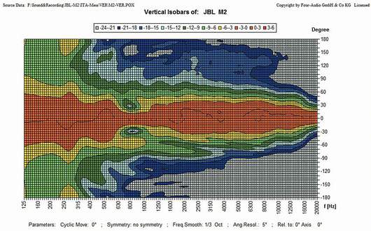

I wouldn't call the M2 off-axis response impressive. JBL has had horn speakers way back that measured a lot better off-axis.
Were they diffraction horns? Diffraction horns can give really nice-looking off axis response... the downside being, they introduce a lot of diffraction.
I'm still trying to wrap my head around the M2's horn geometry. Haven't figured out all the implications of that complex internal topography. Somebody much smarter than me has probably already written an analysis somewhere and I just haven't seen it yet.

The current JBL waveguides, including the M2, are simply diffraction horns where the diffraction slot is diagonal.
The reason that it's diagonal, is that it allows you to widen the beamwidth on the horizontal AND the vertical axis. A vertical diffraction slot only widens the beamwidth on the horizontal.
See : JBL M2 for The Poors
The key to all of this, was that JBL wanted to create a waveguide with beamwidth that's much wider than they used to use. The M2 waveguide has a beamwidth of 115 degrees. The old JBL waveguides had a beamwidth of 75 degrees.

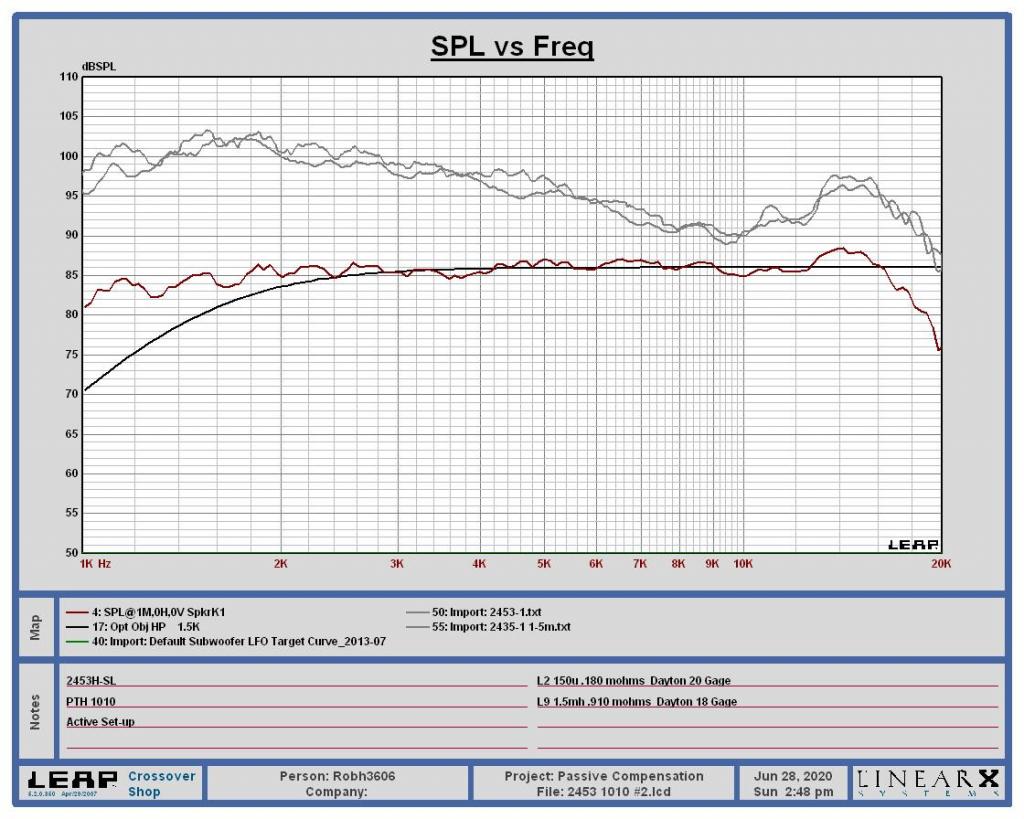

There might be something else going on as well. For them to get that spectacular flat on axis response it takes a good deal of narrow band DSP and it's all for the driver. If you drop a large format driver on the M2 waveguide it's not hard to get a passive solution that requires much less EQ. The older large format drivers are much smoother. Take a look at the EQ used in the M2 for the 2430.
This from GT
"The 2430 needs to be used an octave below where it is happy (as in the M2) and has an increased amount of 2nd harmonic distortion between 750 Hz and 1500 Hz as a result. It is not horrible, but it is about 10 dB higher than the 476Mg in that range and up to 20 dB higher than the 476Be over the same octave. The increased second comes from the 2430 being a ring radiator with no suspension. It is just difficult for it to move below 1500 Hz."
We have had several of M2 clone users switch over to the 245X series drivers because they were subjectively better sounding than the 2430.
This from GT
Rob 🙂

Wouldn't that triple the price of the speaker?
That's a big price to pay for a 10dB reduction in distortion.
Because the 475Mg can't reach 20khz; the diaphragm is too big. So you'd have to add a super tweeter. That turns the M2 into a three way instead of a two-way. The M2 is active, so you'd need another channel of DSP and amplification.
As they say, "there's no free lunch." In the grand scheme of things, the M2 is relatively affordable.
Hello Patrick
It would greatly increase the cost and the older drivers cannot match the SPL or power handling dual coils of the 2430.
I wasn’t saying they should change over just that this could have something to do with how the shootout ended up with the SALON on top.
The 476Mg actually goes out to 22K and in the speakers where it is used they just let it run out. It does not need a tweeter. Even a 2453H SL which is a much less expensive 4” does better up top that you would think.
I agree about the no free lunch and JBL made the right driver choices for the M2.
Rob 🙂
Rob 🙂
