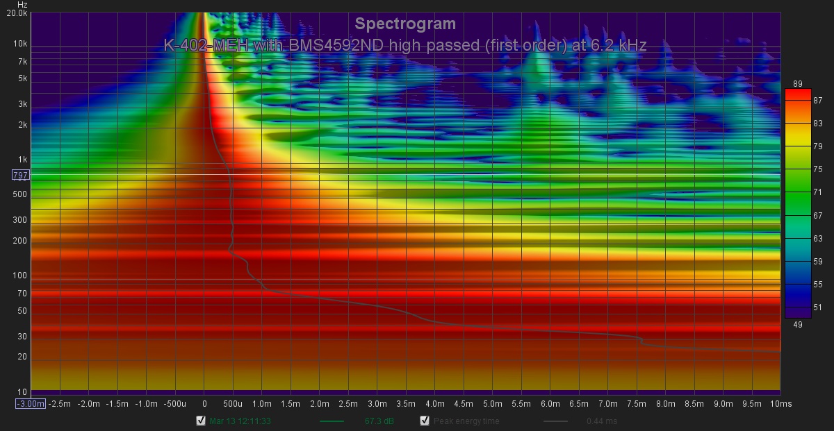

Same thing for the K-402-MEH using a BMS 4592ND dual diaphragm driver high passed at 6.2 kHz and first order crossover at 450 Hz using IIR filters only:
attachment.php
I understand about the small room thing. You've done a magnificent job for your listening room and its size.
Chris

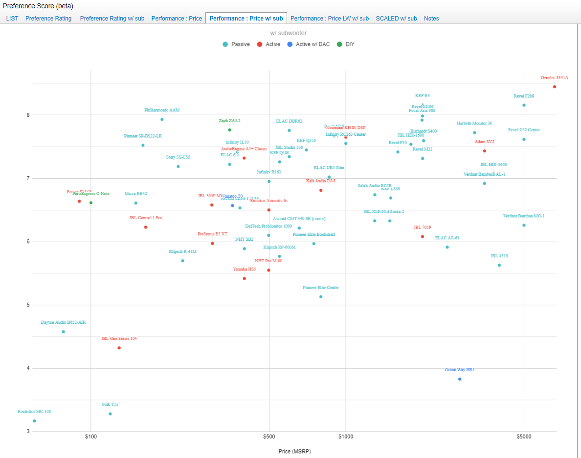

Sean Olive from Harman / Samsung / JBL published a really interesting study on listener preferences recently:
Preference Score (beta) - Google Drive
A lot of data to process, but the map of "preference" vs "cost" is really interesting.
Speaker Data 2034: 2020 - The speaker data revolution
2020-01-26 – MZKM released an open “Master Preference Ratings for Loudspeakers” database based on the patent and formulas by Dr. Sean Olive from 2004. This database was made for the ASR Spinorama measurements.
This looks it's been taken from Audio Science Review's measurements (not listening lists) and correlated with Harman study on preferences.
