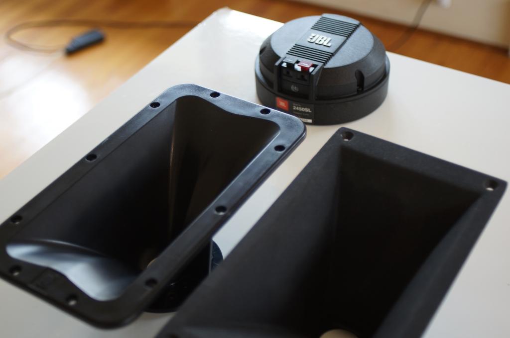

I kinda lies in the words..... guiding the waves....
I'm pretty sure that horns are not intended for domestic use - but more for outdoors, where reflective surfaces are not a problem - and you want high efficiency and beamed sound - "shot" at a row of people in larger areas
Smaller waveguides makes much more sense for small rooms, where you want to be sure that reflected sound(unavoidable) is closely relatable to the direct sound.
Theoretically yes, but JBL uses their "Waveguide" more for their SR (outdoor, venue), and "horn" more for high end home audio market.
Oh no, I'd say horns can work super in domestic use...even in small rooms.
Would also say, a single "horn" can be both a horn as an impedance transformer and also function as a wave guide, at the same time.

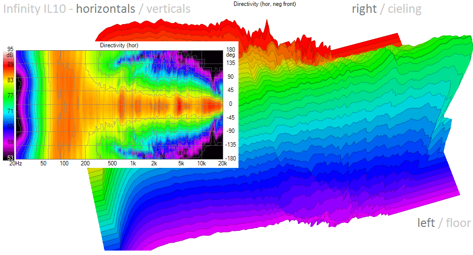

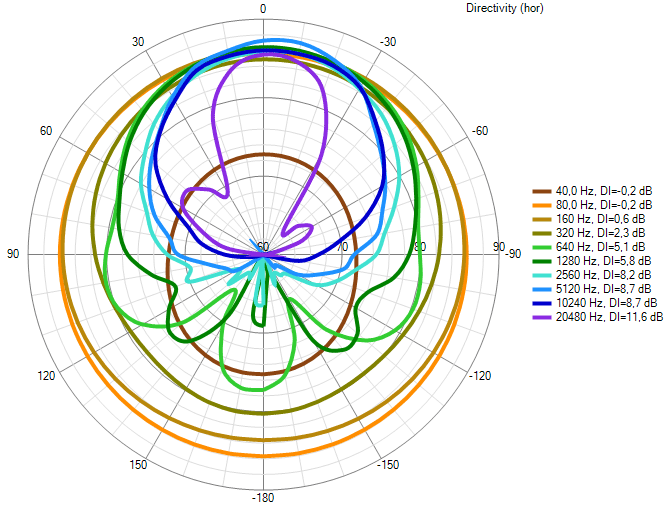

Here is some VituixCAD directivity animations for IL10 based on Amir's spindata 🙂 (click them to get intended non distorted X/Y ratios)
attachment.php
attachment.php
