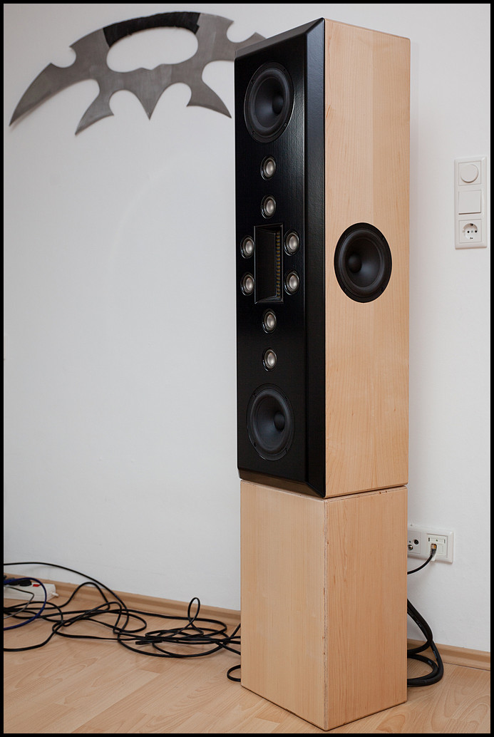

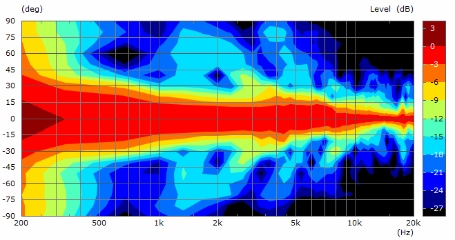

I think the thread title is a bit misleading. Direct radiator or not ist not relevant. Only the directivity index (+ the exact radiation pattern) matters.

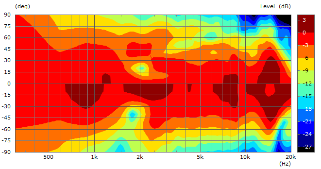

I developed a speaker (Quasikoax 1) which has a wide horizontal dispersion and a very narrow vertical one. The overall directivity index is very high. I approximated it out of the horizontal, vertical and diagonal measurements and used Tylka's formula.
The speaker uses mostly interference to create a high directivity. Only the tweeter uses a vertical long diaphragm and a shallow waveguide for the horizontal dispersion. So this speaker produces virtually no HOMs.
attachment.php
Horizontal:
694086d1532807668-pseudo-coaxial-narrow-directivity-horbach-keele-filters-abstrahlverhalten-hor-png
Vertical:
694087d1532807668-pseudo-coaxial-narrow-directivity-horbach-keele-filters-abstrahlverhalten-vert-png

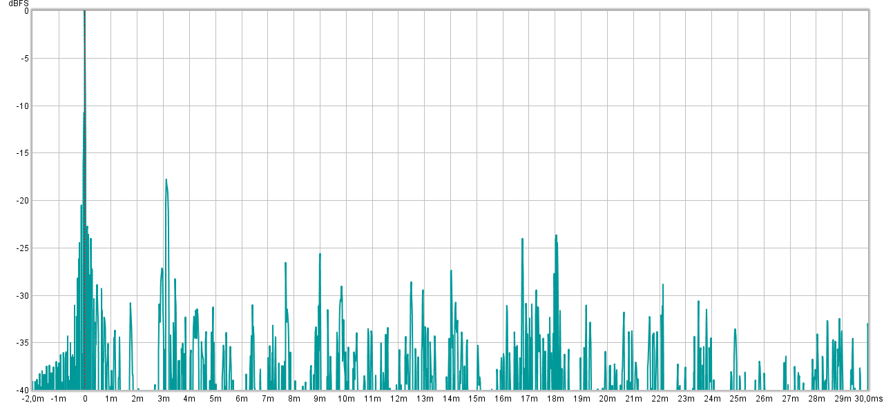

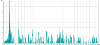

ETC on listening position:
attachment.php

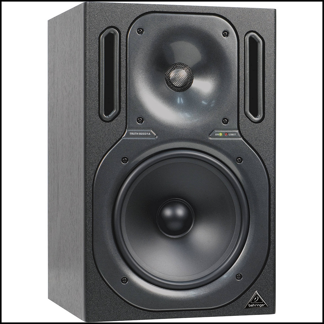

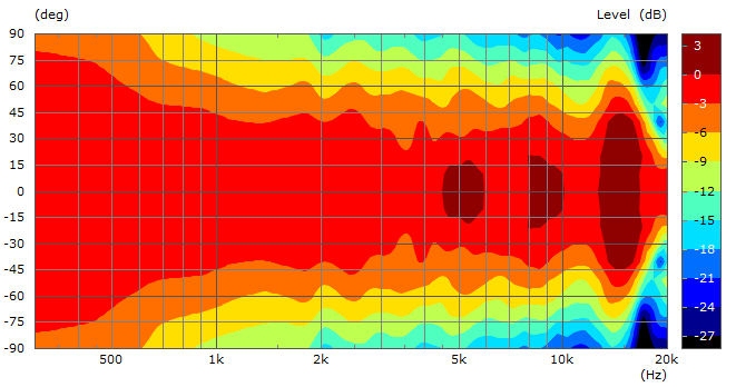

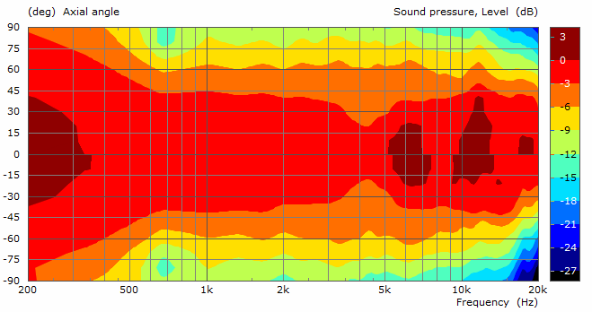

I compared it to a small 2-way monitor (Behringer B2031A). Its horizontal dispersion differs not much from the Quasikoax 1. The vertical is nearly as wide as the horizontal one. Which leads to a much lower overall directivity index.
attachment.php
Horizontal:
attachment.php
Vertical:
attachment.php

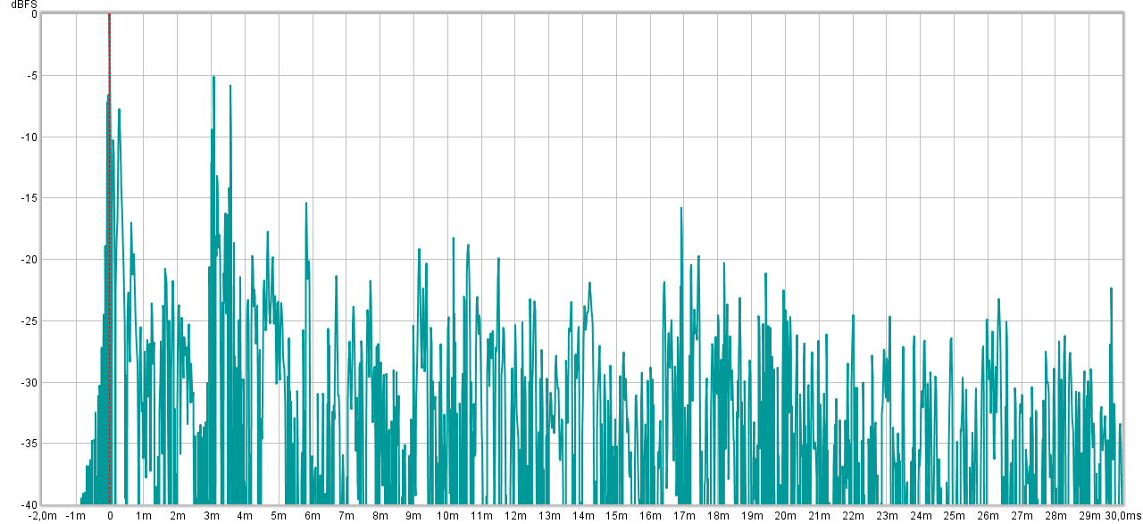

attachment.php
The perceived results are as follow:
Quasikoax 1:
- much less room interaction (look at the ETC)
- stable imaging
- sound balance is slightly dull
- sound ist localized very near when there is no room information on recording ("in your face")
- when recording transports room information (e.g. classics) it is like listening through a window into the recorded room
2-way monitor:
- much more room interaction (look at the ETC)
- localization is as far as the speaker stands away (and soundstage is very "flat")
- less stable imaging
- sounds brighter
- no "window effect". One always nows that the sound source is in the living room.
You can exchange the Quasikoax 1 with a similar horn speaker and I bet you get the same perceived differences.
And another thing: while developing the Quasikoax 1. I had several prototypes and also listened to them rotated. That means they were aligned horizontally and the dispersion pattern swapped. The difference was not that big, but it was there. Imaging in an asymmetric room was better when horizontal dispersion was narrow (not new at all). The sound balance changed a bit too. With wider horizontal dispersion it sounded a bit brighter, but not much. The difference was only subtle. In fact it was nothing compared to a speakers with overall low directivity index.
