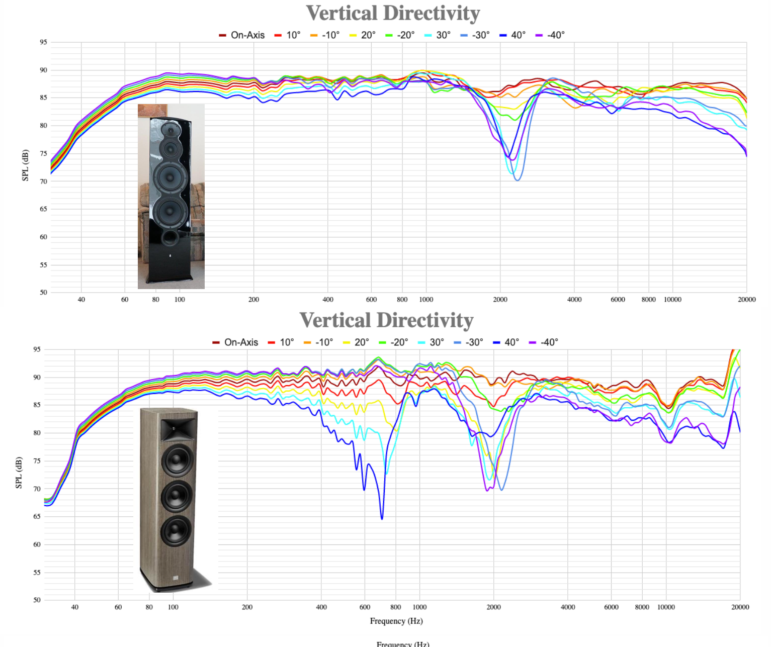

Something that's stuck with me, is the experience of listening to the JBL 4367 back-to-back with the Revel F206 at CES a couple of years ago. While both speakers sounded very good, I'd argue that the Revel sounded nearly as good as the JBL... at less than 25% of the cost.
I've been reading the data over at audiosciencereview obsessively, and something I noticed is that the waveguides with narrow directivity seem to be at a disadvantage when it comes to the power response of the loudspeaker.
attachment.php
For instance the Revel F208 and the JBL HDI 3600 have a similar configuration. Each speaker has a tweeter, a midrange, and two woofers. Each speaker is optimized using the guidance of Sean Olive, who is a student of Floyd Toole.
As I've designed speakers and waveguides over the years, I've generally focused on the horizontal beamwidth and the vertical beamwidth has basically been an afterthought. But when I look at the measurements of the vertical directivity of speakers at audiosciencereview, I see a pattern emerge, where the speakers with narrow directivity have issues with the vertical directivity.
Here's why this is, IMHO:
It's fairly easy to dial in the horizontal beamwidth of a speaker. For instance, a 7" woofer has a cone that's about 6" in diameter, and because of this, the woofer will beam at 2,250hz. If you put your tweeter in a waveguide it's very straightforward to match the tweeters horizontal beamwidth to the woofer's horizontal beamwidth.
The vertical beamwidth is much trickier.
Kef and Genelec and Tannoy use a coax, and the measurements at audiosciencereview show that this is an effective solution.
With conventional drivers, this gets trickier. The JBL uses a waveguide with about sixty degrees of vertical beamwidth. The Revel uses a waveguide with about 120 degrees of vertical beamwidth.
The JBL will interact with the floor and the ceiling a LOT less than the Revel. But if you're listening to the JBL at even 12-24" above the tweeter, it's not going to sound great. If you're listening to the JBL at a distance of two meters, and your ears are less than 0.75 meters above the tweeter axis, there's a twelve decibel hole in the response. That's *definitely* going to be audible.

I would have suspected the huge power hole in the midrange to be the problem with the JBL above., not the hole in the lower treble - which is worse than the Revel for sure, but IMHO not at all like the difference in the midrange of these two speakers. I wonder why the two manufacturers would use such different crossover points for woofer/mid? I bet the Revel is down around 200-300hz while the JBL is obviously double that.
Both dips are ugly, but note that the JBL is down fifteen decibels at just twenty degrees off axis, while the Revel is down four decibels.
Even worse, the measurement is from JBL's HDI3600. The bigger speaker, with an 8" midrange, probably is much worse in this respect.
To me, it looks like they could have improved things if they:
3) Used a smaller midrange
2) Had tighter spacing
1) Used a waveguide with wider beamwidth
The Revel is a three way while the JBL is a 2.5way. Because all three woofers in the JBL are playing at low frequency, it winds up with a narrow vertical beamwidth and higher efficiency below 700Hz.
The fact that the JBL is a 2.5 way probably drove a lot of the xover decisions. For instance, if JBL had gone with a 5" midrange instead of a 6" midrange/woofer, the midrange would have become the Achilles Heel of the entire speaker (because all three drivers are playing at low frequency and the smaller mid wouldn't be able to keep up with the larger woofers.)

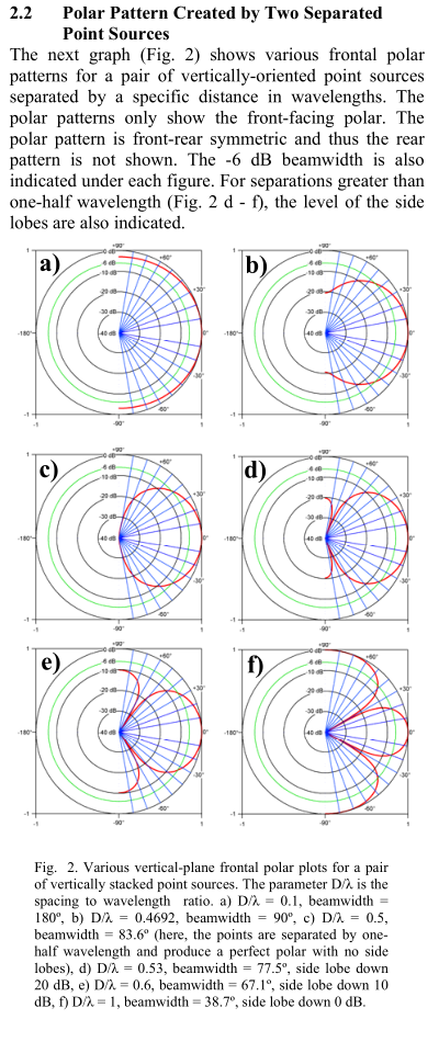

I think Patrick and the prior response re. C-C spacing are correct.
I have been thinking in my mind (need to cut wood!) about a design where the mid operates only in its piston range (Ka <= 1) to minimize its beaming in its passband with minimal spacing between the drivers vertically. It is difficult to achieve as it essentially requires a tweeter that can cross low (? Bliesma T34B?).
I found the helpful image.
Bill
This is one odd 2.5 way IMHO. The 2.5 I am familiar with cross the helper woofer/woofers much lower than 900Hz. Anyone have a schematic of the crossover???
Rob 🙂
Yep, to the idea that narrower vertical pattern in a wave guide makes it harder to achieve good polar response curves.
And more yep, to the need for tight c-to-c and matching ka's, and others' posts along same lines.
I think the biggest part of the problem is simply matching an asymmetric waveguide pattern with a symmetric single cone radiator pattern.
A single cone has same horizontal ka and vertical ka.
The waveguide by design, can't.
One of the two matchups H vs V has to give, and we all know horizontal is going to rule.
So to solve the vertical mismatch, in come designs with two or more cone radiators covering the frequency range that needs to mate with the waveguide.
They attempt to work as a line, to narrow their summed vertical directivity, to match the wave guide's vertical directivity.
So it's add drivers to make a mini-line, all the while trying to maintain c-to-c distances close enough that it all works.
And also trying to make sure a vertical directivity mismatch wasn't created on the bottom xover side of the mini-line drivers mating with the waveguide. (looks like that's a second big mismatch with the JBL HDI 3600)
You have to read that graph above very carefully because the JBL is much worse vertically in the positive direction (above the tweeter) than it is in the negative. It's only 5dB down at 20 deg below.
As noted by Amir in the review this speaker is very sensitive to the height that it is placed.
The listening window measurement is very good which shows that if it is placed correctly it will perform pretty well.
