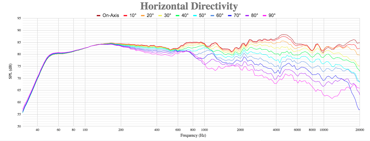

I've been following the measurements over at Audiosciencereview and it's interesting to see how speaker designers are able to get directivity control down to as low as 400-500Hz without resorting to a waveguide that's over a foot in diameter.

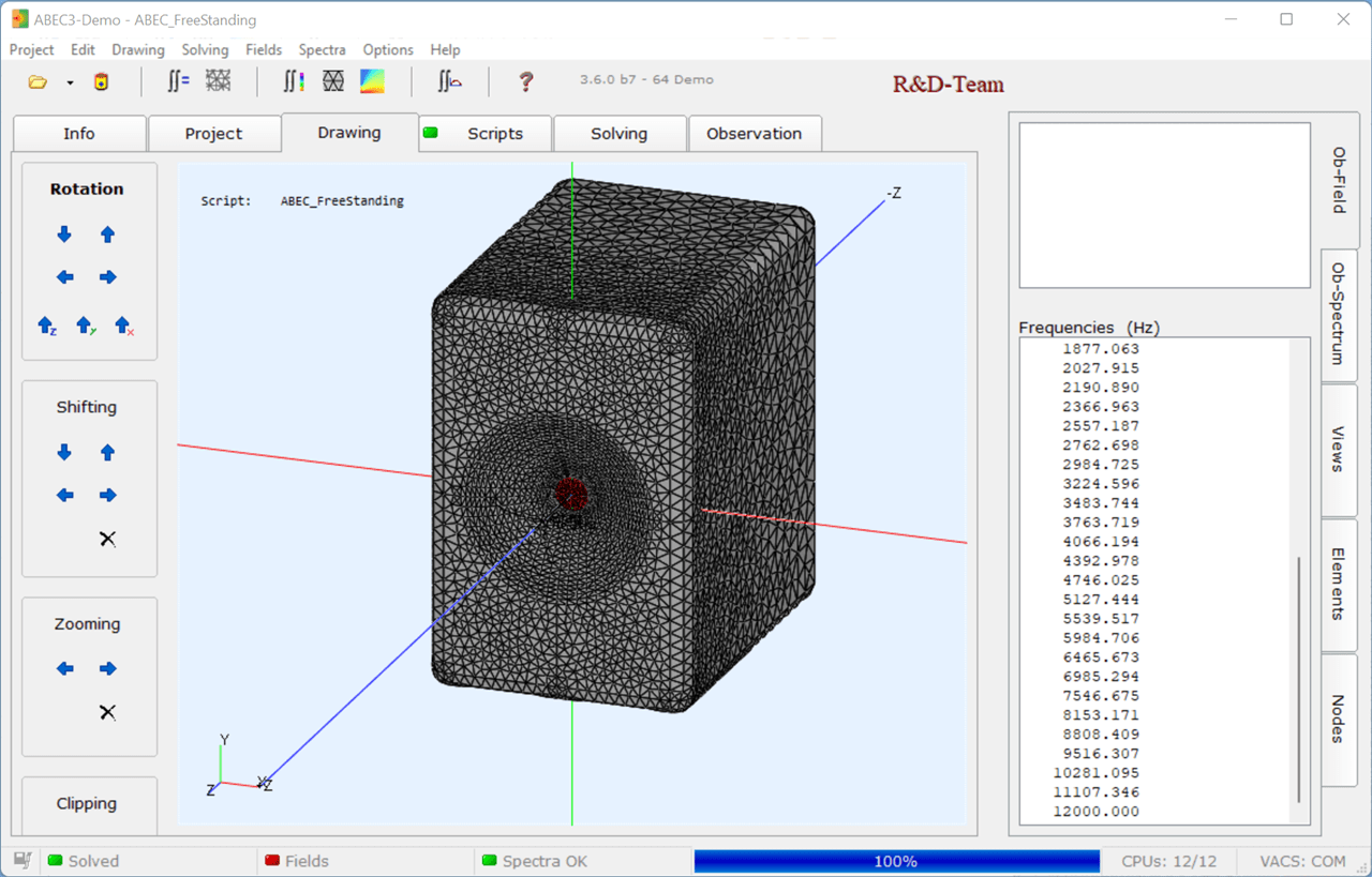

The new release of Mabat's software has confirmed this 100%, and it's also incredibly cool because you can now manipulate enclosure shape to get the directivity and response shape you're after. I can't tell you guys how amazed I am by this.

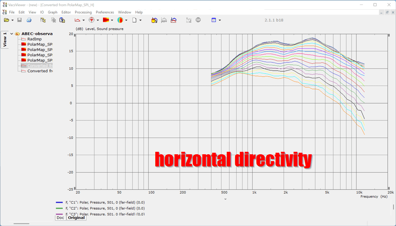

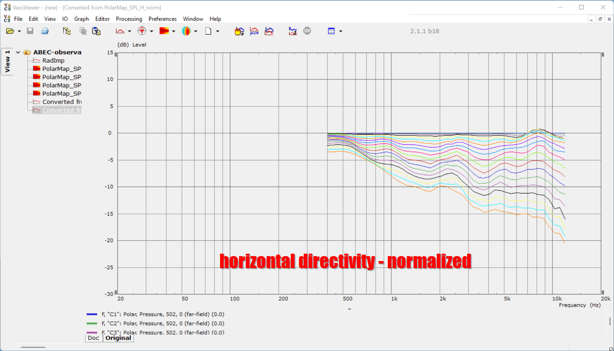

Here's a rough sim of the KEF LS50 that I did using the new version of his software. Note that this sim is ONLY for the tweeter, nothing else. So you can safely ignore everything above 1khz or so. But note how the waveguide is only 6" in diameter (2250Hz) but directivity control goes down to about 700Hz, more than an octave lower than the waveguide can control.
And note how the response shape is quite consistent with the actual speaker.
Rough estimate of the KEF LS50 made using the new version of ATH
Predicted horizontal directivity

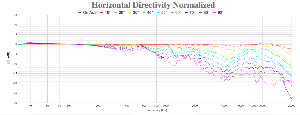

Measured horizontal directivity, courtesy of Amir from ASR
Predicted horizontal directivity (normalized)
Measured horizontal directivity (normalized)
