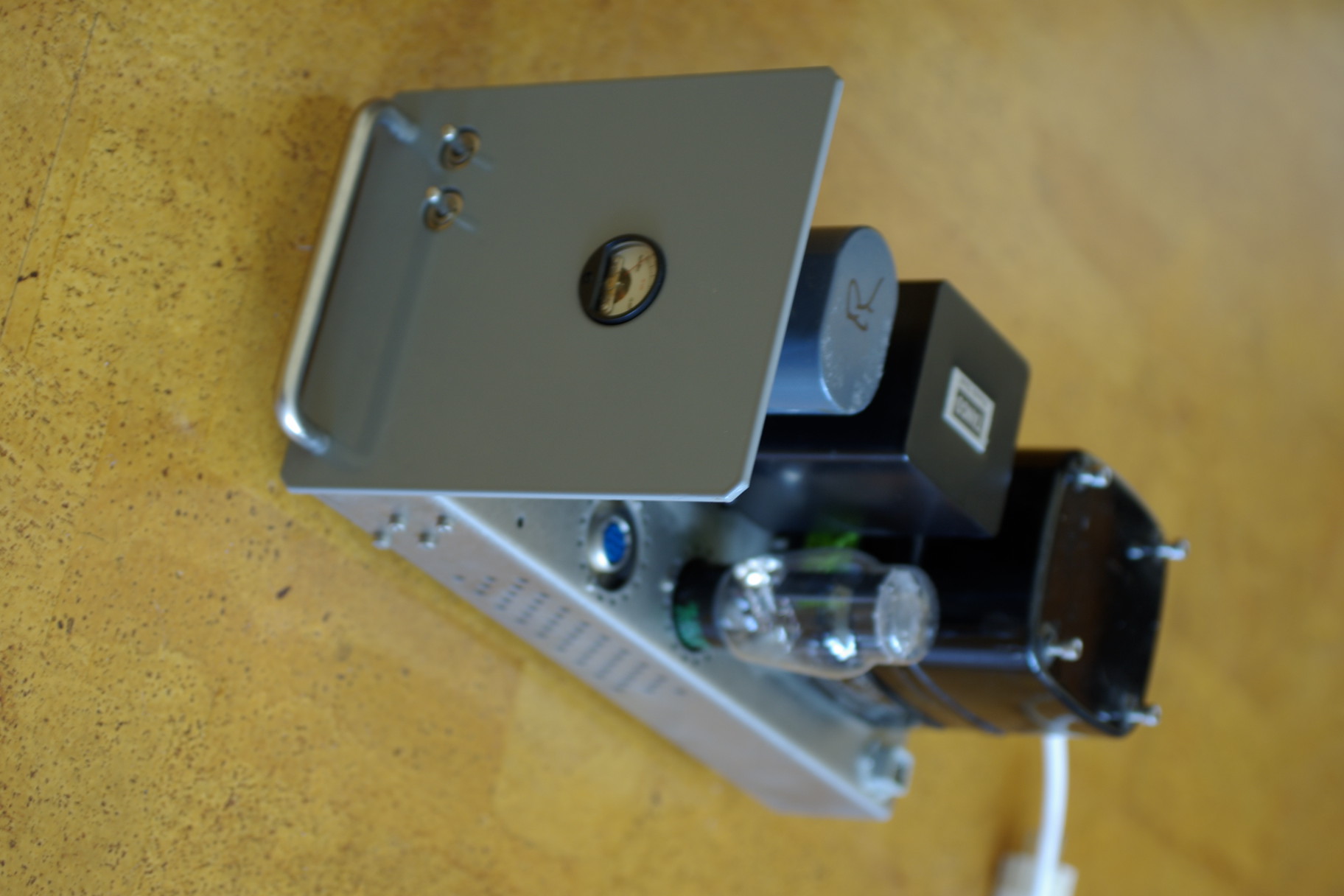

Hello,
I have dozens of 6sn7 and 6sl7 from world war 2 .
All my chassis so far have used circular holes which were closed by a circle on the inside of the chassis that could be mounted with some kind of grommet in between to isolate the tube.
BUT the main reason i used these circles was to be able to easily change it into one with a different socket hole without having to use a drilling machine.
In the attachment you can see i used these technique for other parts too like connectors.
Greetings, Eduard
