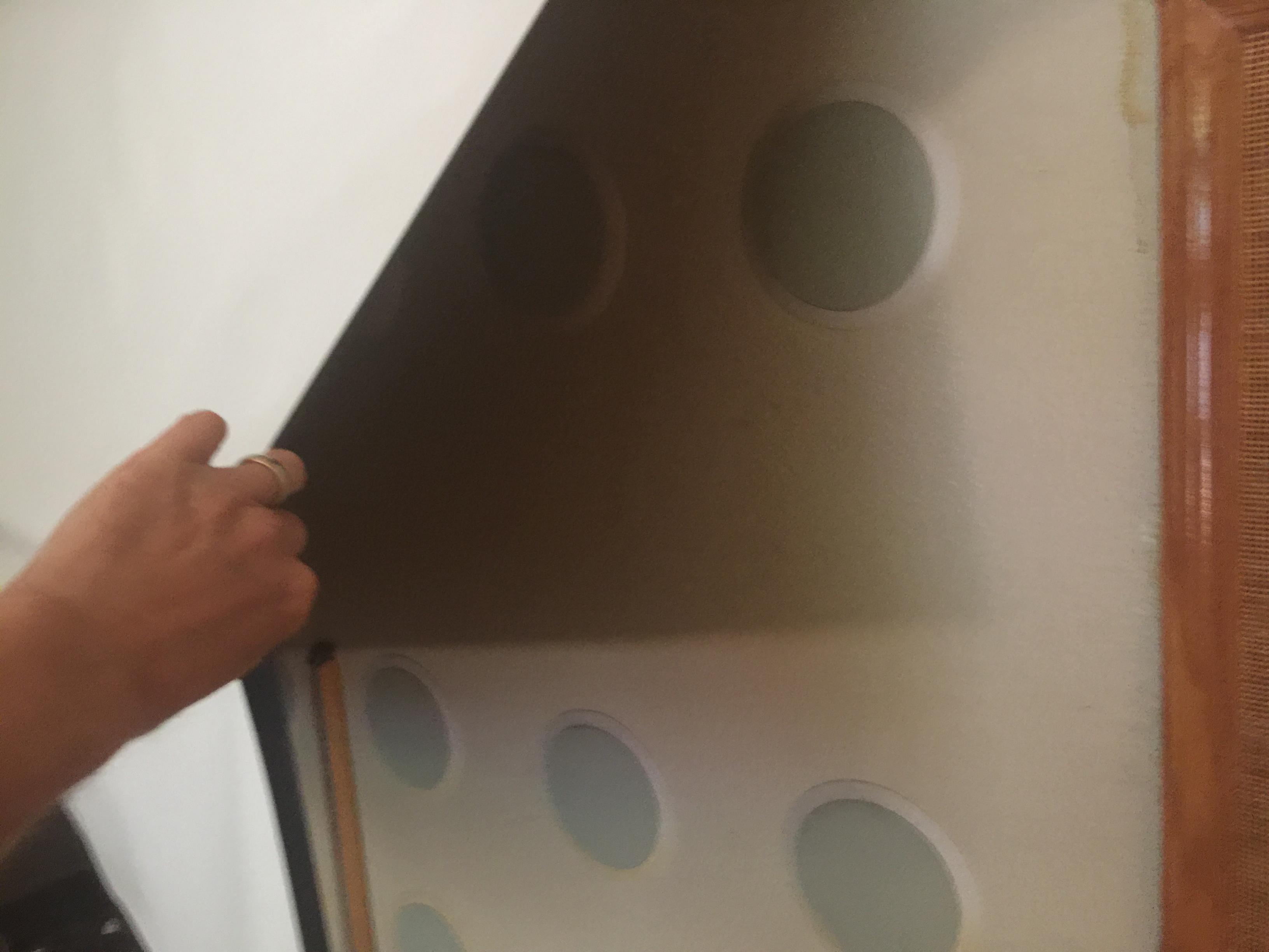

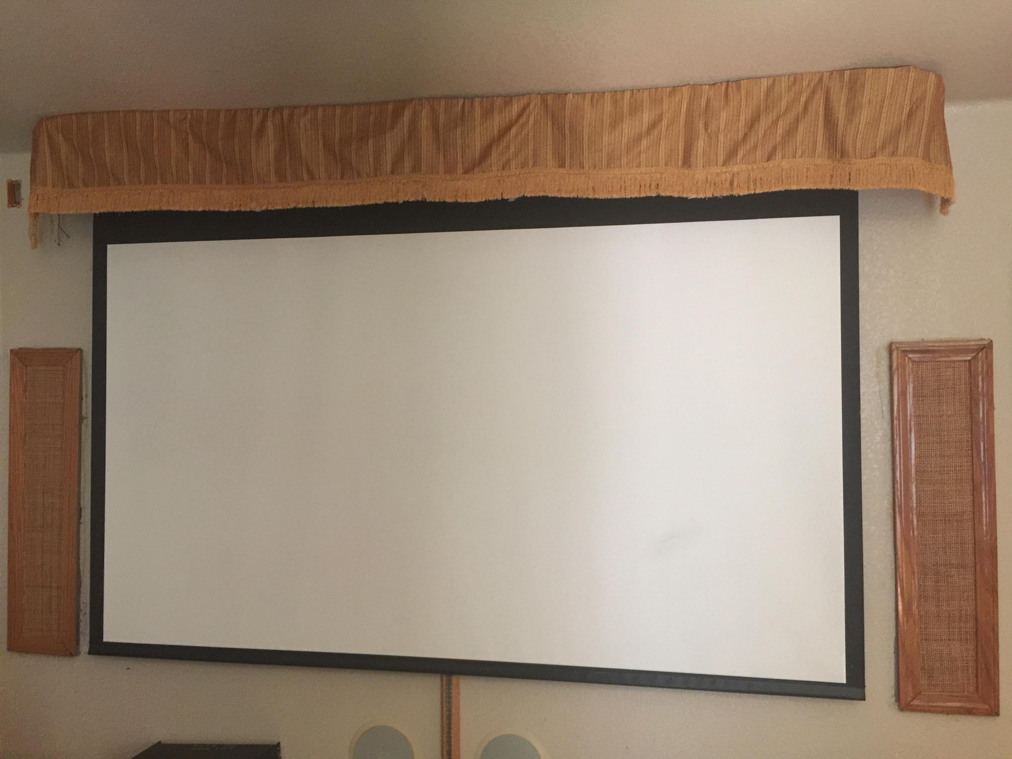

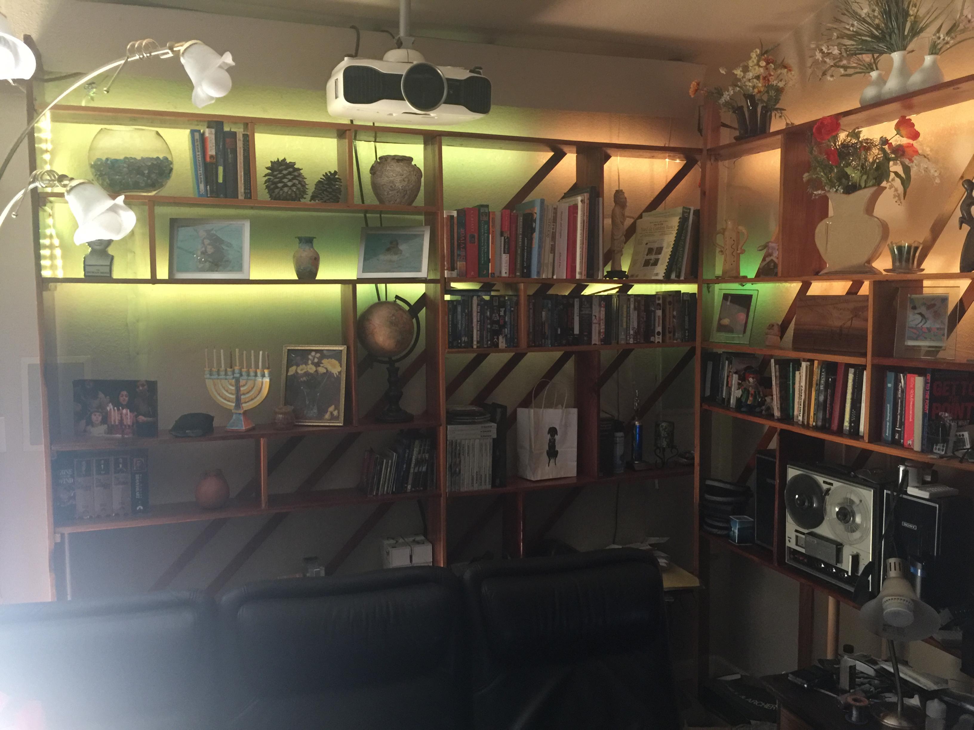

My room has own character. Bass traps behind the movie screen, a big bookshelf from floor to bottom at the rear wall, with shelves made with random golden ratio dimensions, and a mattress topper behind it. 🙂
When walking in the living room, reverberation changes in the part where sofas stand, where we watch movies. 🙂

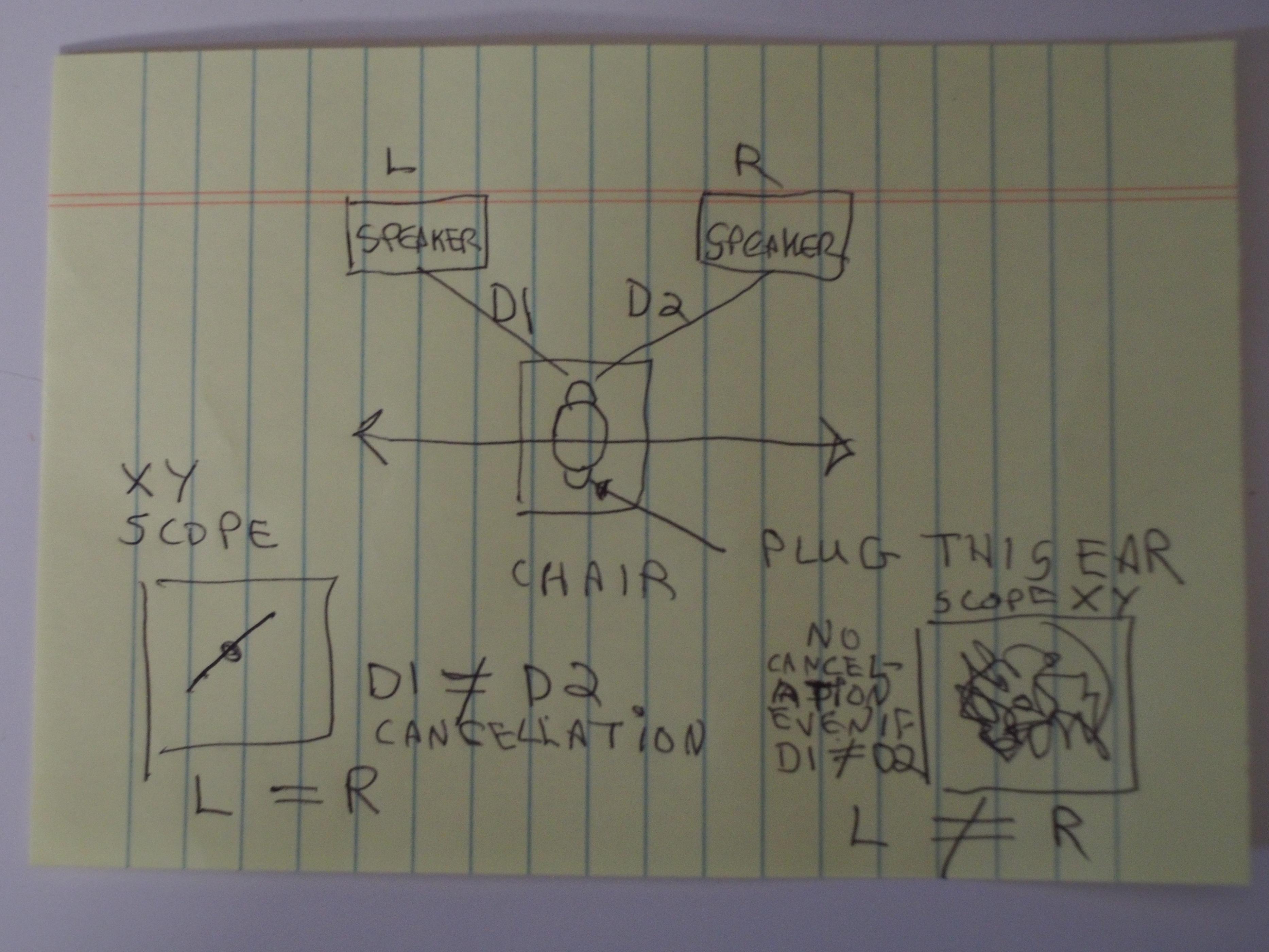

Try connecting a scope in XY to the stereo channels out. Check different recordings.
1. Some will have a spread that approaches that of a circle, with all the area filled in.
2. Some will be a 45 degree line, with very little spread. Switch to Mono, and see what little spread you had collapse to a fine line.
3. Switch back to Stereo. Use a recording that very little spread on the 45 degree XY line. Now, plug one ear. Always face the unplugged ear toward the speakers (right angle to the line you are going to walk several times in this experiment. Walk a line in front of the 2 speakers, from one side to the other. You will hear cancellations at various frequencies as you are walking near the center (between the speakers).
4. With one ear still plugged, switch to mono, and repeat #3, and listen for the cancellations again, this time in mono.
5. With one ear still plugged, now switch to stereo, and use the recordings from #1 above. Walk a line in front of the speakers again . . . What? . . . You will not hear many if any cancellations this time.
After performing the experiments, Analyze what I said above. You will get the point.

I am attaching a diagram to describe the null effect that occurs on so many stereo recordings (the ones that really have most of the L and R signals in-phase, and same instruments and voices mainly at or near the 'middle'.
The recordings of well spread and out of phase and out of time/distance L and R signals do not have nearly the same level of obvious nulls and cancellations. You can "walk" down the line across the speakers and not notice the effects of the other recordings mentioned above.
