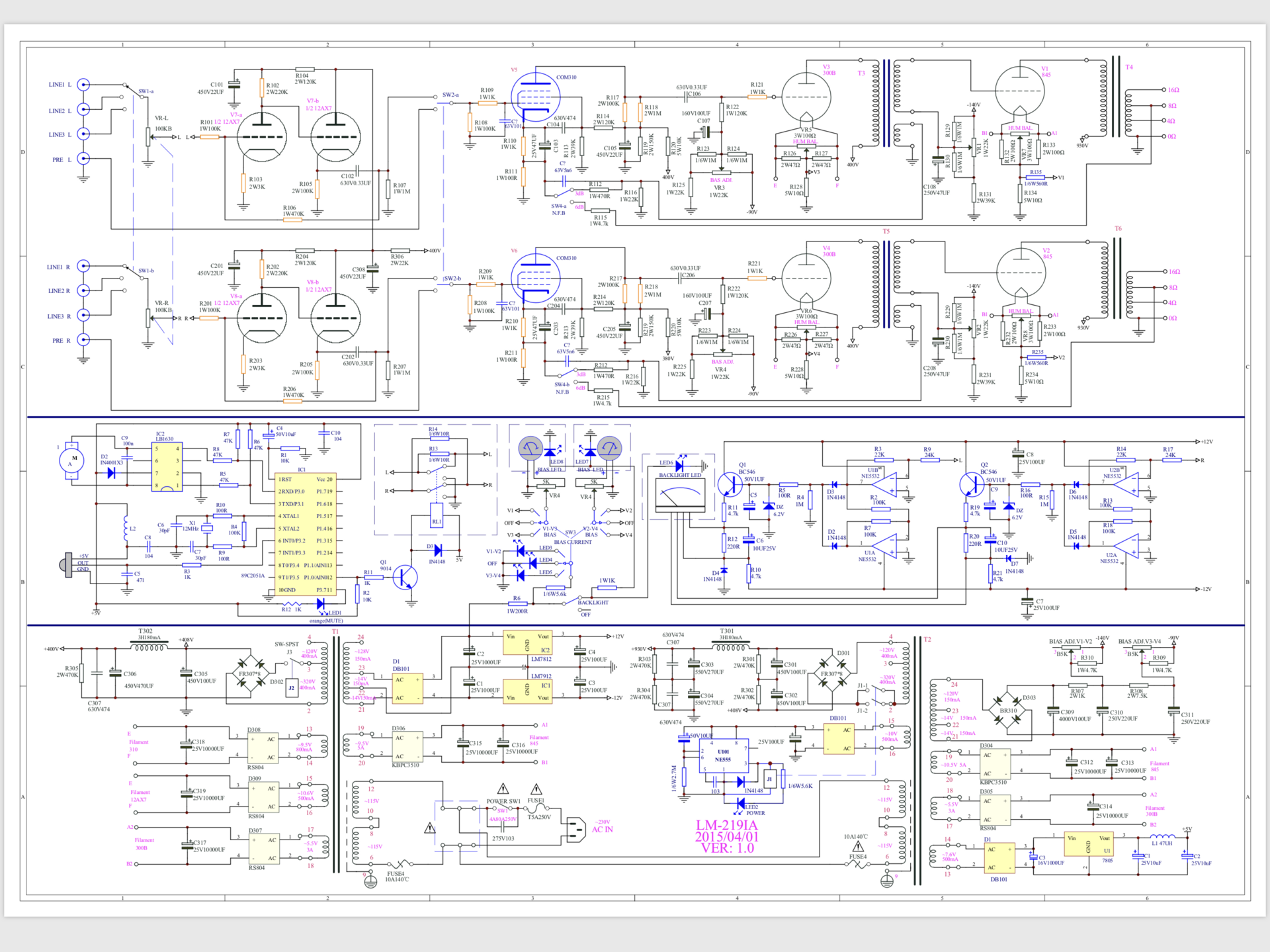

I built a clone of Greg’s amplifier after he released the design although I made a few tweaks to it and made a modern PCB layout - the result was a very neutral amplifier, perhaps the most neutral amplifier I have yet built. I have a few other solid-state amplifiers And I agree, they are perfectly adequate if not excellent for all of my music needs.

I cannot see, it is too small.

If I click the Image until it expands I can see all the parts and part numbers and part values even on my iPad, although I do zoom in when I’m looking at it. uses stacked supplies running the front end at about 400 V and the output at the usual one kilovolt . it uses a 300 B as the driver with interstage transformer to the 845 . The voltage gain stage is a 310 pentode and there are two choices of feedback, one from the interstage transformer, the other from the output transformer, controlled with a simple switch .

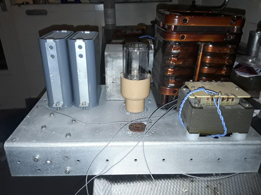

A major element in the amp is the power supply. I would always use a choke and preferably a choke input. The right capacitors are not that easy to find if you are on a tight budget. BUT i think if you are on a tiny budget you should not choose to build a 211/845 amp. One more concern is the weight of these kind of amps.
The reason the Tango had his height where to big higher than the 211 glas bulb so it could be placed upside down. You could go for some kind of the chassis that could be positioned on most of its sides and still have the tubes on view.

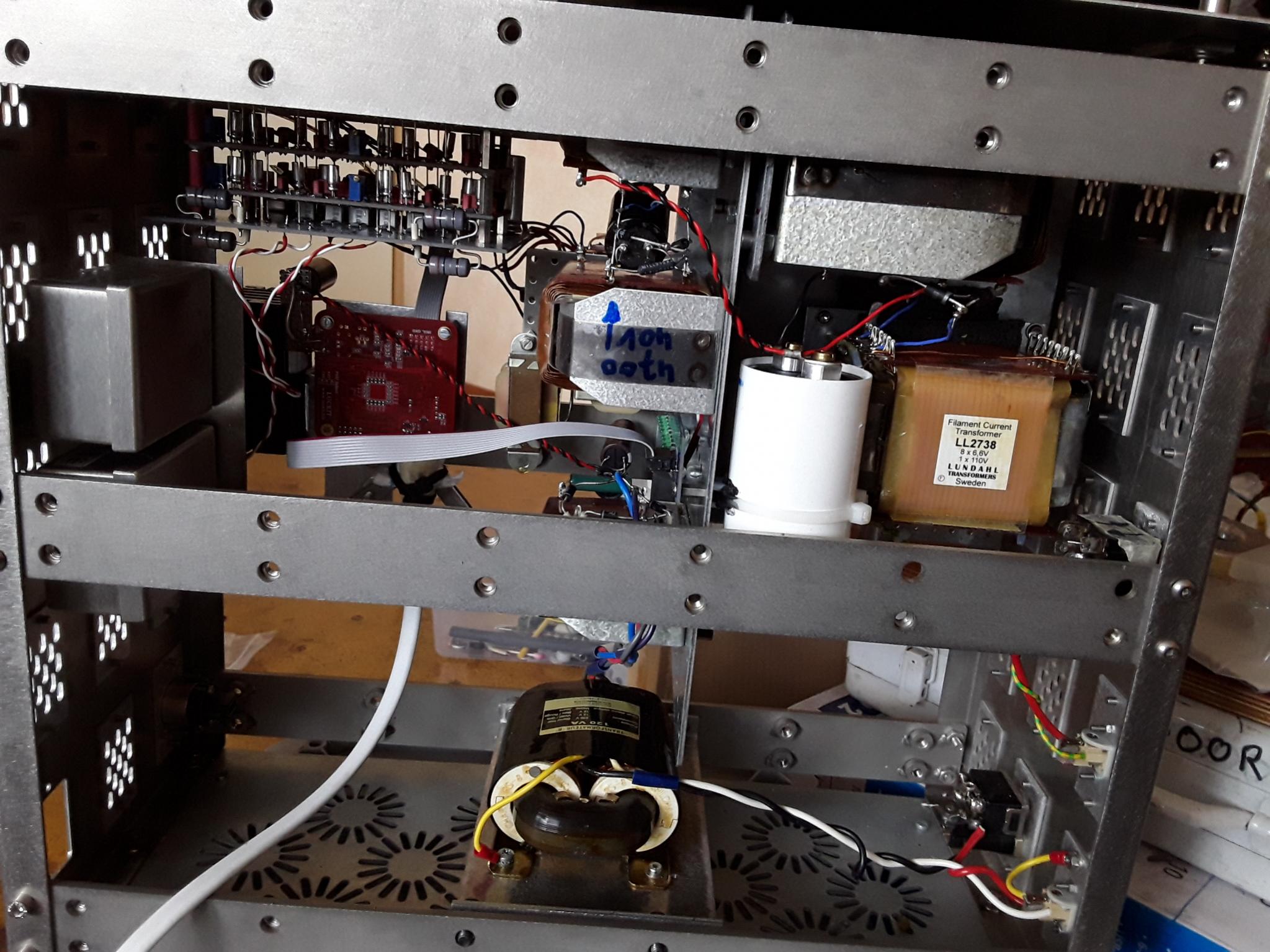

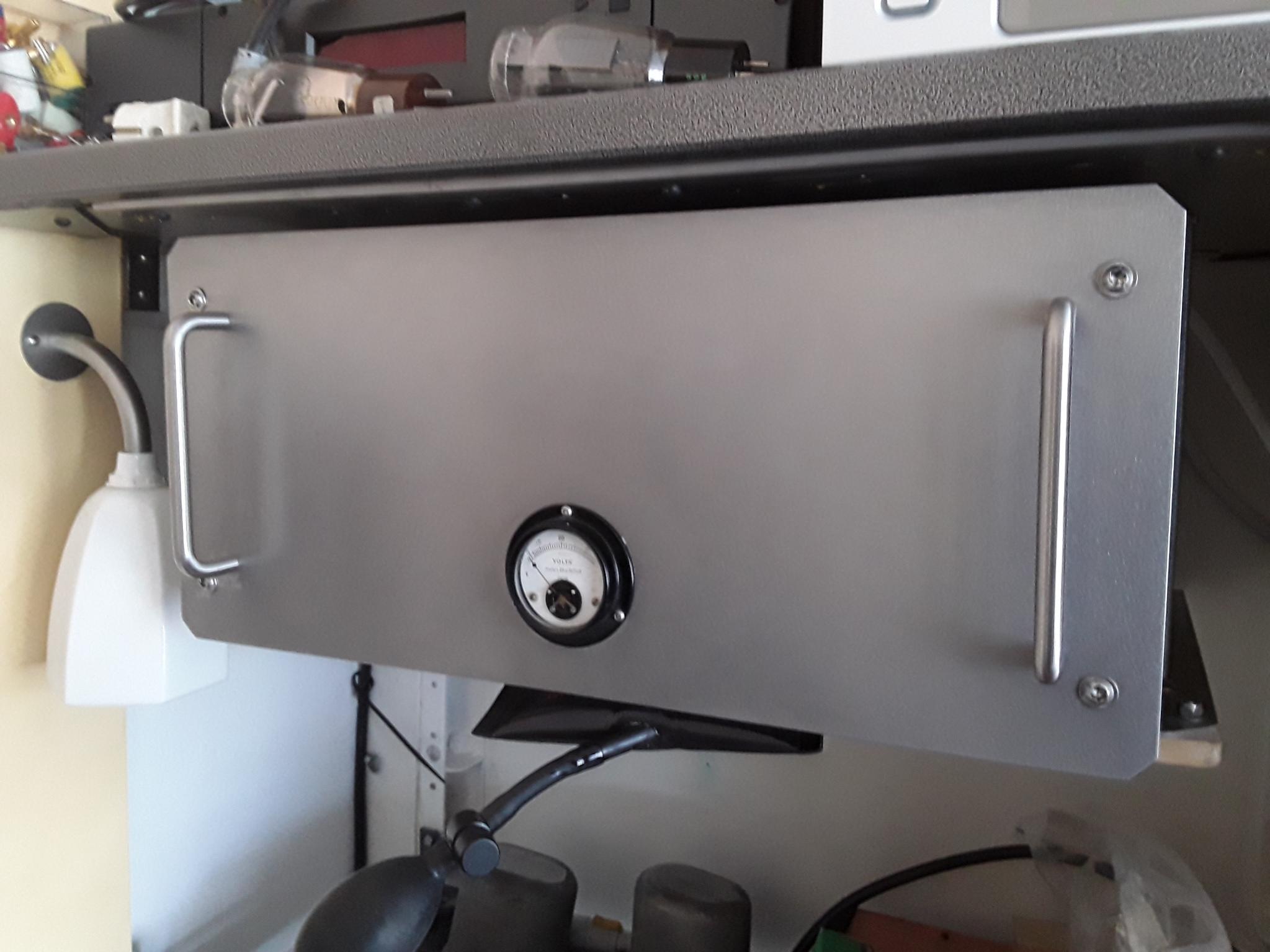

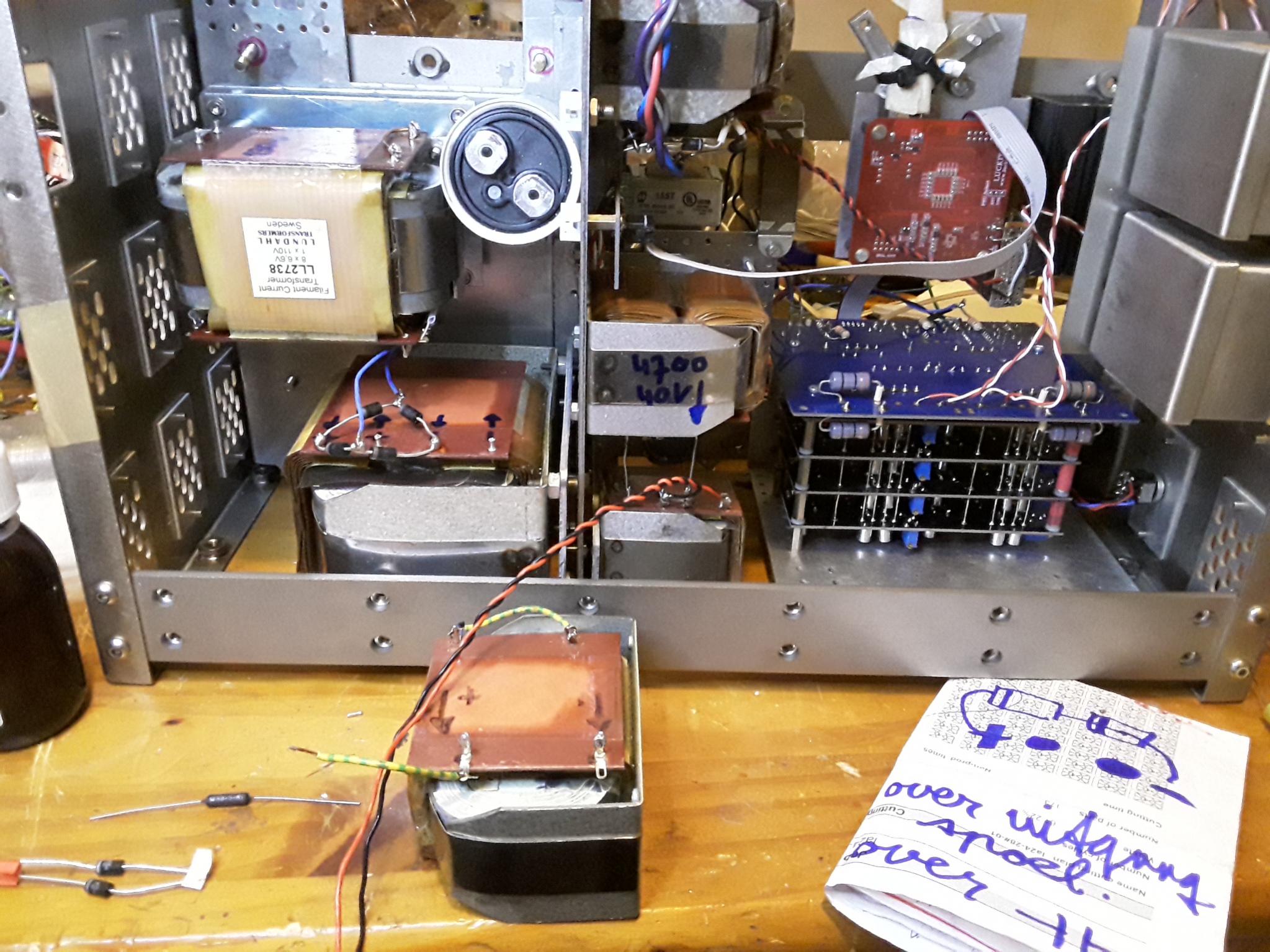

For my DRD amp i will go stereo with a big power supply. For my DDDAC had to go stereo too. Made the chassis in a kind '' modular '' approach meaning it can be changed without have to drill extra holes in what is already there. Just change a metal plate into one with a different pattern of holes. The holes to mount it into the chassis will be identical of course.
At this moment it is around 30 kilogrammes. The upcoming modification will involve two big chokes for two little circuits that will be added. Then it will be 40 kilogrammes but happily it will not take it out of the rack every mount because it is above my shoulders. CAN be done after warming up.

eduard, that’s an impressive project you have there, it looks like a lot of work and a suitably large collection of transformers being employed 😀
Hello, It is the DDDAC that can be found here with the search engine. It has two Sowter output transformers. One choke input power supply to make around 12 volts dc at around 1A. I changed the input choke which was at first the little one in front to the big one mounted inside. There is another choke input supply to supply a lower voltage at a lower current for the wave IO circuit. Most of the work is already done. If i have to make a changing it will imply just make a new flat piece of metal with some different holes. Which is my daily job. The things that are more time consuming are the things you cannot do yourself. Like the bending and perfect welding!!! Greetings, Eduard

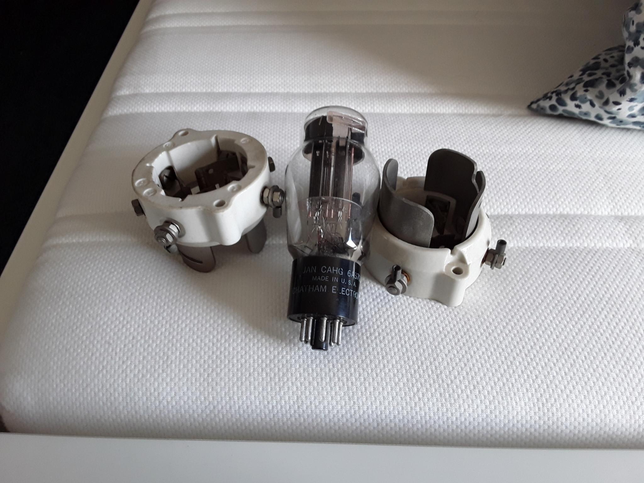

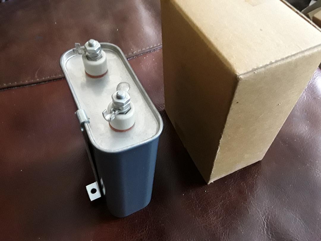

Hello, The point with a 211 amp is that some parts are hard to get nowadays like these. Only see them in my attic. lol
