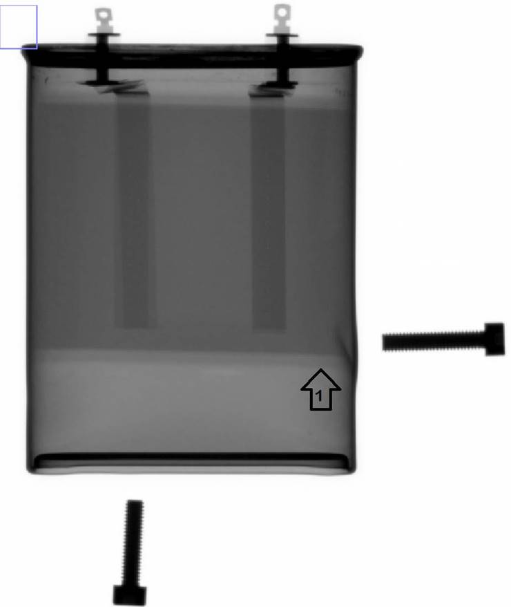

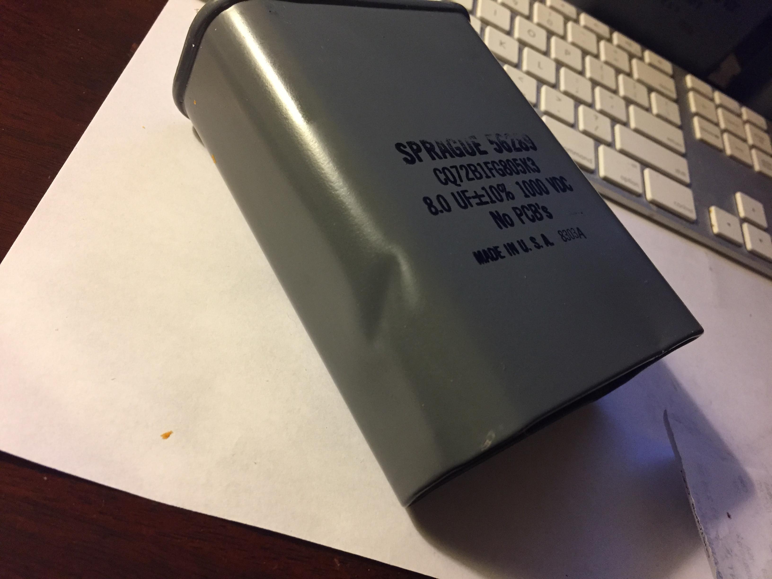

In my collection I recently added four 8uF PIO's which are rated to 1,000V that I think would be good for a PSU for an 845 if I stick to a B+ slightly under 1,000V.
However, one of them has a small dent. I had the capacitor x-ray'd to look at the inside. I am advised that this capacitor may not be best used at maximum voltage due to the dent. I attach a photo. I contacted the seller in the US, who ignores me completely - possibly he's away.
In the X-ray image the dent is on the right hand side, close to where the foil-paper edges are; there's an arrow to show how the dent is near the edge of the foil-paper.

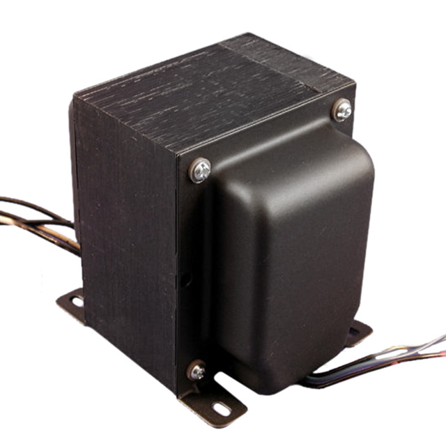

use the 4ohm tap to load with 13k the 845.
the Hammond is going to work this way
Will there be enough primary inductance? Might be worth doing the maths to check before committing.

I had the same problem with some other caps from ebay but they were aluminium and the dents were smaller. I opened the open with the biggest dent and noticed the role of paper/foil was surrounded by some oil before '' touching '' the alumium so no problem
I know the caps you are using and you will need a decent hit to have dent like this. I wouldnt take the risk. With the x ray you could easily find the innner and outer foil i guess. Do you work at the airport?

Well I still have 3 of the 4 that I can use, the other 3 have only minor damage and look good to use. All I can say is that the seller is either on holiday and forgot to leave an away notice or my advice will be DO NOT BUY from 'bestsound'.
How does the math work ?
The datasheet (attached) says nominal 55H for the primary. At 20Hz that's an impedance of 7k. The ra of the 845 is 1.7k. Am I getting warm ?
