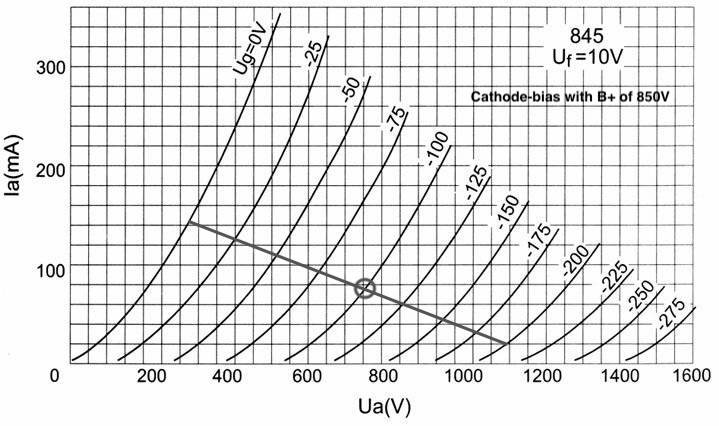

attached is a 6k5 loadline for the 845. It's clearly going to generate some 2H distortion!

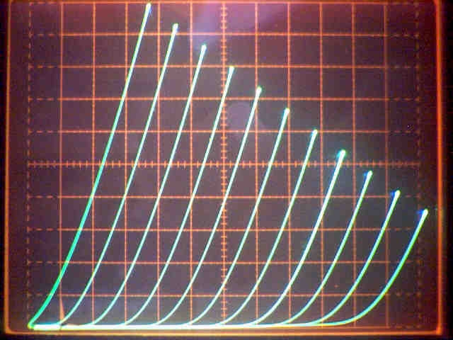

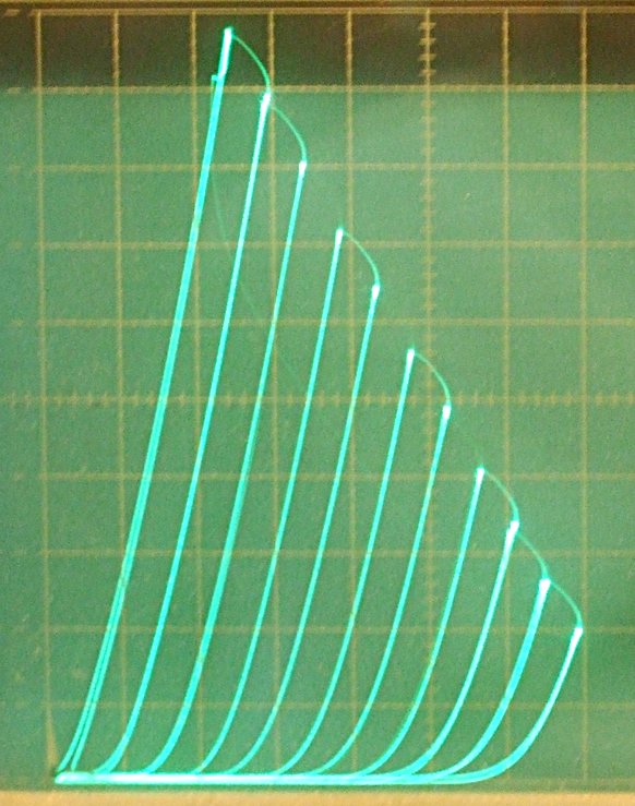

Here's a couple from other spots, about the 845:
... at about 750V plate voltage and class A1 operation 5-6K is a very good choice. You get about 12W with low THD.
10K is better for high voltage. However a 10K OPT for such application is a lot more difficult to make in comparison to 5K. If the transformer is a standard type (and even more if cheap) a 5K OPT is typically a better performer than a 10K OPT of the same quality
The 'traditional' load for a power triode is 2*ra, plus a little bit to reduce distortion perhaps, so 5.4k is a perfectly reasonable choice. It doesn't matter that the load line goes over the dissipation curve for part of its length, since the average power is roughly constant, and is determined by the bias point. Notice that with the 5.4k load the bias point is almost dead centre, which looks deliberate to me. You might prefer a larger load to reduce distortion more, at the expense of some output power, but they certainly didn't screw up the design.
If I were doing this, I'd do it right with a 10k load, although a good transformer at that ratio/voltage/power level would probably bankrupt me.

845 needs 1000V + to sound well, so a 10k is mandatory at this voltage, clearly visible from load lines...
I disagree that the 845 needs 1KV. On my amp I have 3 HV settings between 750V and 1000V. Once re-biased the sound of the amp is indistinguishable between the settings, only the max power level.
I do run 10K transformers. They did cost a lot of money but I feel it was worth the investment.
Nope...I designed and got done a pair of OPTs for Ale Moglia to work with the 814. About 6K/110mA for 15W @30Hz (undistorted) but 10K is no problem with same or better performance at very reasonable price. You can see them on his website if you look for the 814 amp.
In few words he had issues with HF response with the Lundahls showing a nasty resonance around 17KHz and roll-off around there as well when using the 814 triode mode. For 250 euros + shipping I got them done. Practically the same performance at low frequency and -3 dB somewhere around 40KHz. Of course the cost included also a third party professional test to (legally ) work up 1KV. This was few years ago but the price today would not be much different.....
