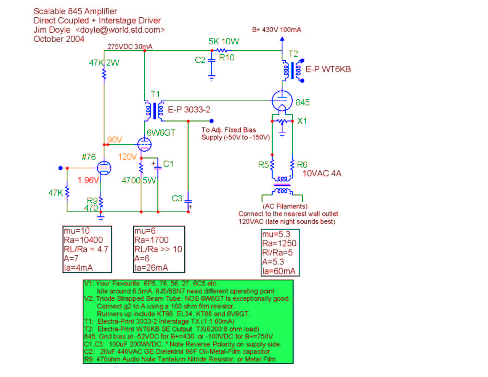

I'm going to build something with a big bulb, an SV811 or 845.

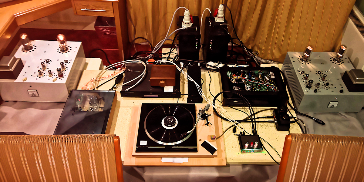

Very nice. How well do they drive the ESL57s?The Image shows my commission built P/P 845's.

I'm actually thinking of planning for A1, wasteful perhaps but I'm intrigued by the whole Sakuma-san philosophy which is all A1.
I have some SV811's already. But they are no longer in production whereas the 845 is so I may build with the SV811s but keep the design & build open for experimenting with an 845. Most of my projects have been a bit wimpy, worrying about wasting heat etc. With the big toobs, may as well just jump in and burn some watts
A1 is perfect if you don't need the power, and is much easier to implement.

The general view of the visitors to the room on this day, was that I was delivering Bass that is very unusual for a 57, these have enough clean fast bass to play Eminem full throttle.
The design of the Amps was all about the 57's, Out Trans also have 8 and 16 Ohm Taps.
That's good to hear. I have electrostatics and find that because the impedance of them falls with frequency, I need to boost the HF a little to get a flat frequency response.
My rig is SE with no feedback so the output z is a bit on the high side compared with feedback amps.
I remember the SV811-3 and 10 when they came out. They were appealing but then I found out that they are less efficient than other NOS types. To get a measure they have a max plate dissipation higher than a 300B but output power is about 1/2......Anyway the SV811-3 is better suited for A1 operation.
This low B+ version from Jim Doyle looks nice.. Sorry, I don’ have the PSU schema. IIRC, it uses mercury vapor rectifiers in an outboard chassis.
845 Amp - Iteration 3 | Flickr
