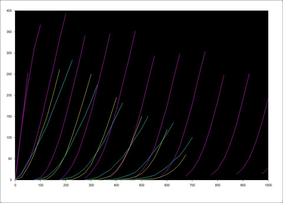

As far as I know, I don't need anyone to explain anything to me on this. I've drawn composite curves for push-pull output stages in both Broskie's application and in Excel according to RDH4's process. It is amazing how linear and evenly-spaced the curves are for a standard push-pull output stage of reasonable bias current. I went through the exercise for KT88s, both operated as 'pentode' and 'triode' and various other tubes. All were astoundingly linear for anything above 50mA bias. There is some real magic in push-pull transformer drive and tubes. I didn't see any advantage to lower bias except tube life. Linearity seems to always increase at all points with increased bias current.
All of these configurations (pentodes, pseudotriodes, and real triodes) will handle elliptical load lines very well. Old-school triodes have beautiful, evenly-spaced curves for sure but high-gm power tubes like a KT88 operated as a pentode with plate-grid feedback (cathode feedback or shunt) will have far better curves (more evenly-spaced and lower rp) and less distortion into an elliptical load.
I have attached a graphic with 300B curves (yellow) KT88 triode-connection curves (blue) and KT88 20% feedback curves (magenta).
