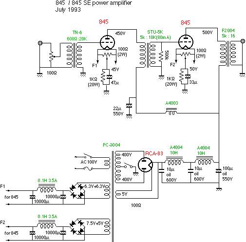

But we, first, have to calculate Dynamic capacitance (for instance), to detemine the driver for the output tube? 🙂
Here are pictures that worth hundreds of words:
Just make the driver such low Z that nothing else matters. My 845s are transformer driven from 300Bs.
Sounds like Wretched Excess, and there's nothing I like better than Wretched Excess.

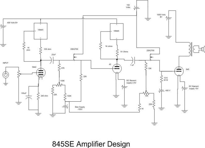

look how at much grid current 845 develops, it needs a good driver.
if you don't sink the current, it loads the stage, reduces power, and heavy distortion in the 20s Watts, if you sink the current properly, drive it with a IT and such as 2A3, you can get almost 30Watts into 8 ohm with a 845, running in A2, beautifully linear. around 1% thd.
Some designs have 10%thd at 20 watts !!! unacceptable.
the IT is non-essential, you can use a regulated supply for the bias, with a current sensor on the cathode which augments the bias and protects the valve from self destruction.
Self-destruction possibility and good sound are the results of proper driving of the 845 tube.
make the driver such low Z that nothing else matters. My 845s are transformer driven from 300Bs...… much grid current 845 develops, it needs a good driver.
3 ohms low enough? That's the RDSon of the mosfet source follower that I feed the grid with. Its drain is tied to a +150 volt power supply. Power output at 3% THD is 42 watts, the onset of clipping.

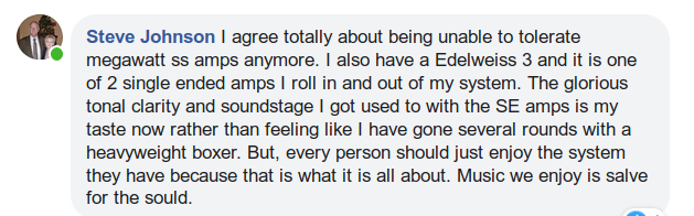

sounds interesting, where have you posted the design for this flower?
Here I revealed all details one by one, while helped others, but the complete compiled schematic posted nowhere, it is a commercial project. I sold few prototypes to music lowers, though.
Edelweiss-3 is a budget project, for people who can not afford usual high-end with whistles and bells, but want high end sound quality. The line will include: basic power amplifier, integrated power amplifier, power amplifier for high end magnetic planar headphones, preamplifier, and a preamplifier with MM/MC inputs.
While working on design I build prototypes with different features that may go, may not to the production, and sell them after they are thoroughly tested.

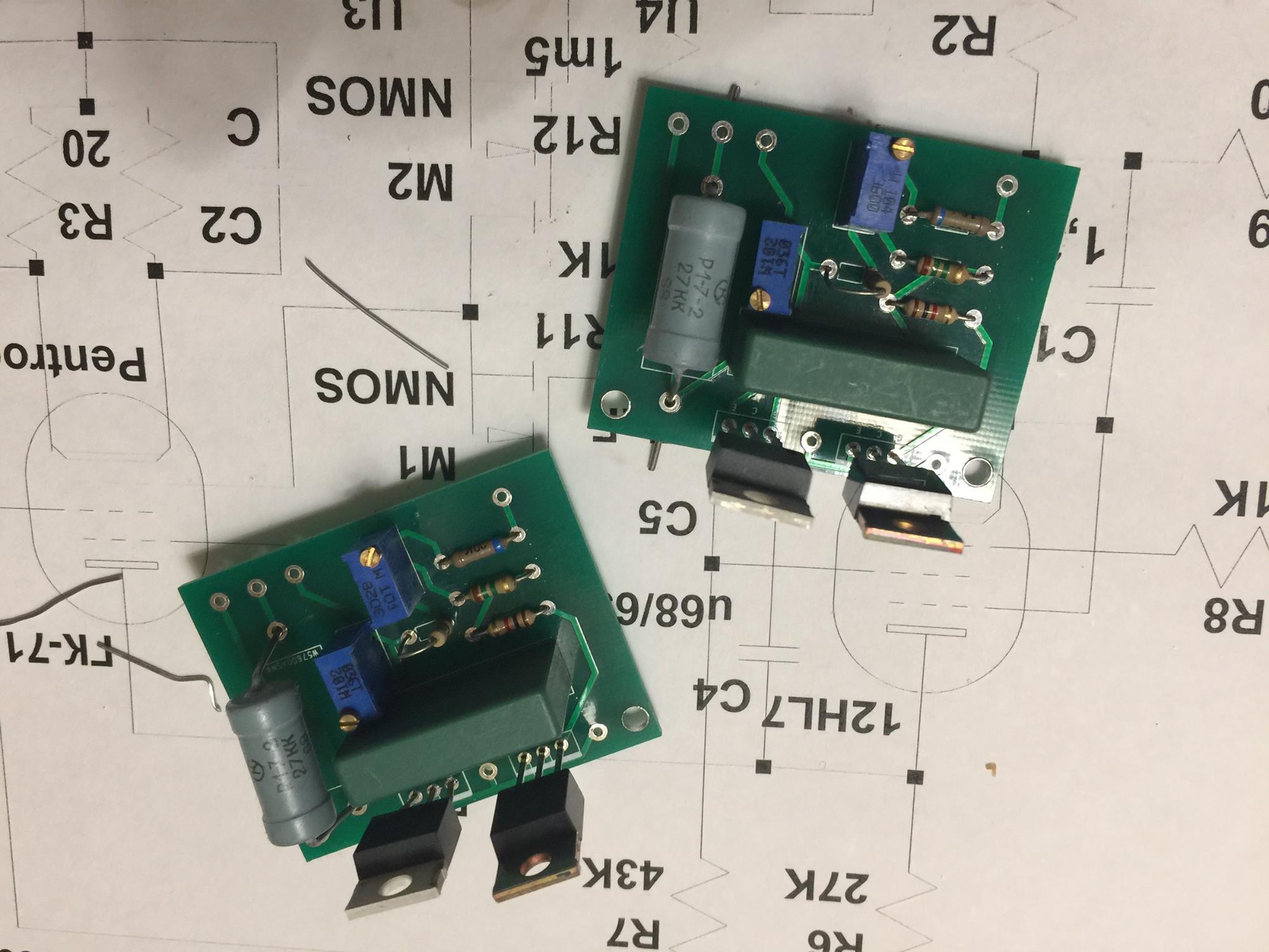

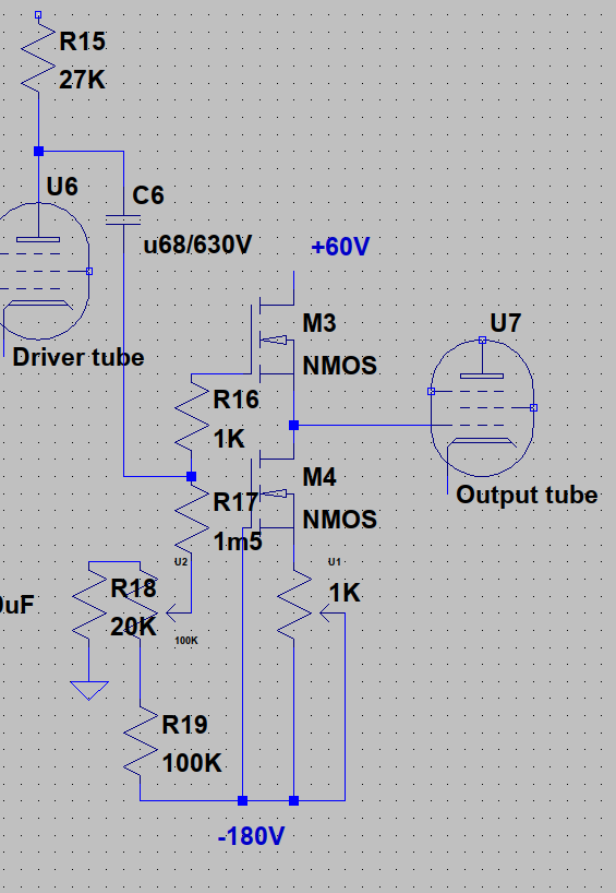

Here is how I drive grids of GK-71 tubes in 45W/Ch SE amp Gubernator-71. The upper MOSFET has internal Zener to protect the gate, the lower is a depleted one.
Use of MOSFETs is allowed as long as one's heart is pure, and everyone knows yours is.
Always the best,
