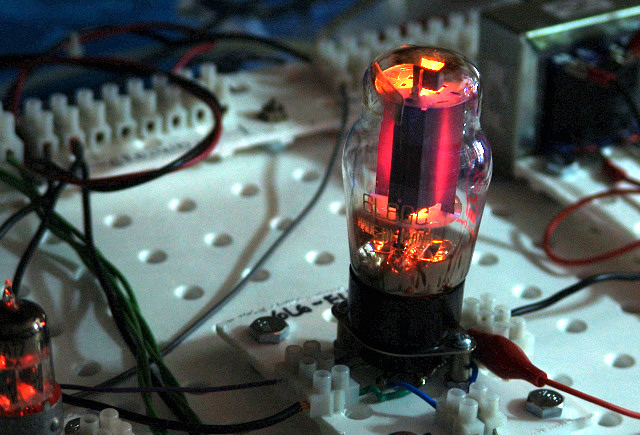

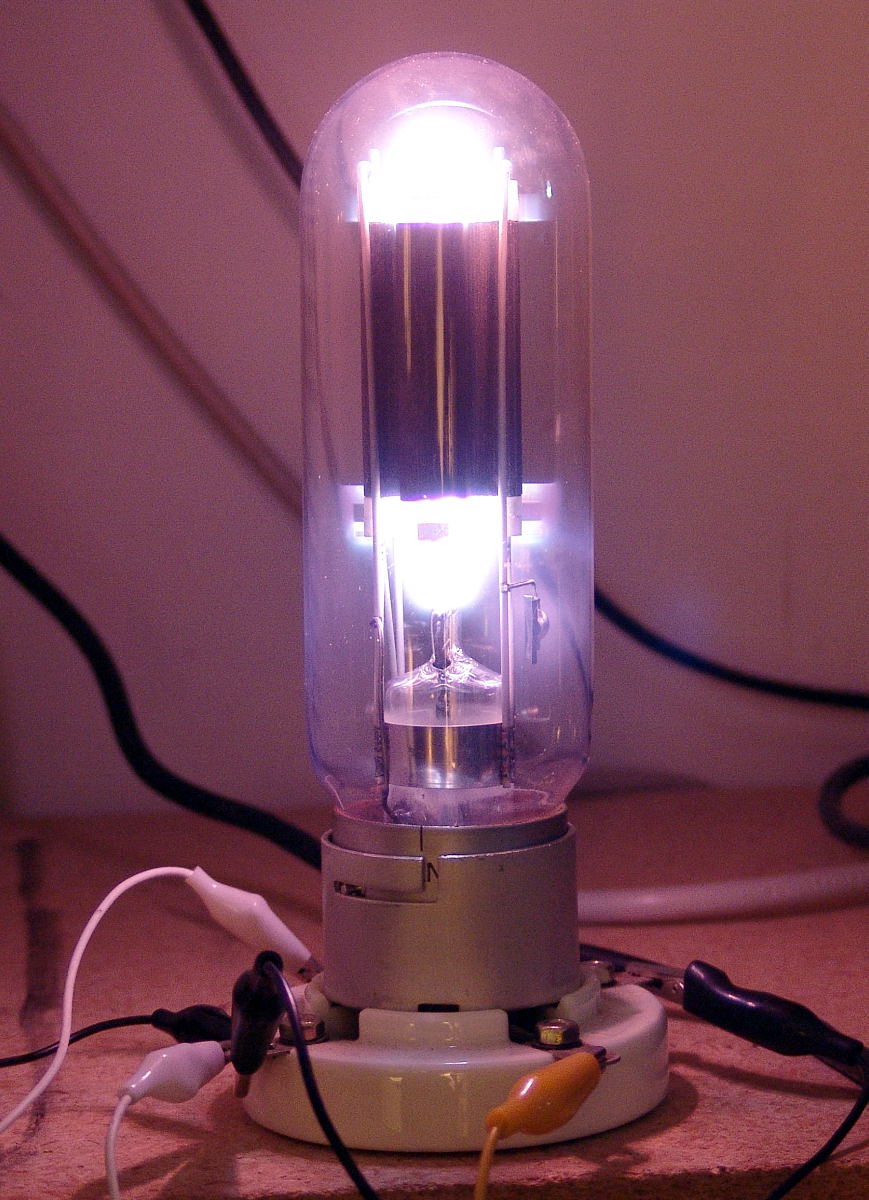

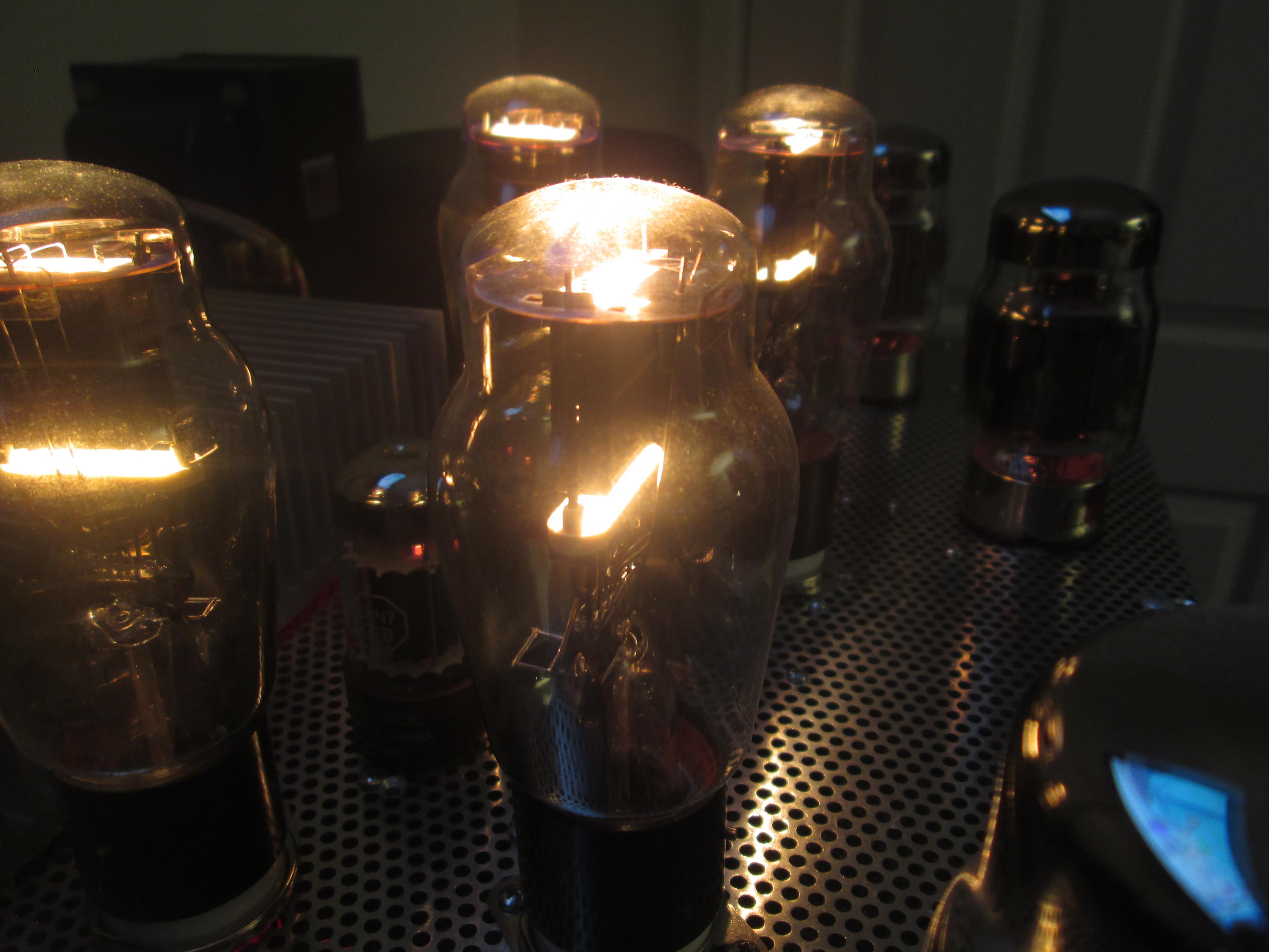

No need for a thoriated DHT.....just run a plain old TV sweep tube a wee bit over spec, or abuse a Chinese 6L6GC.
Although an 845 does have a much higher color temperature, better for reading......
But something's not quite right with this one....

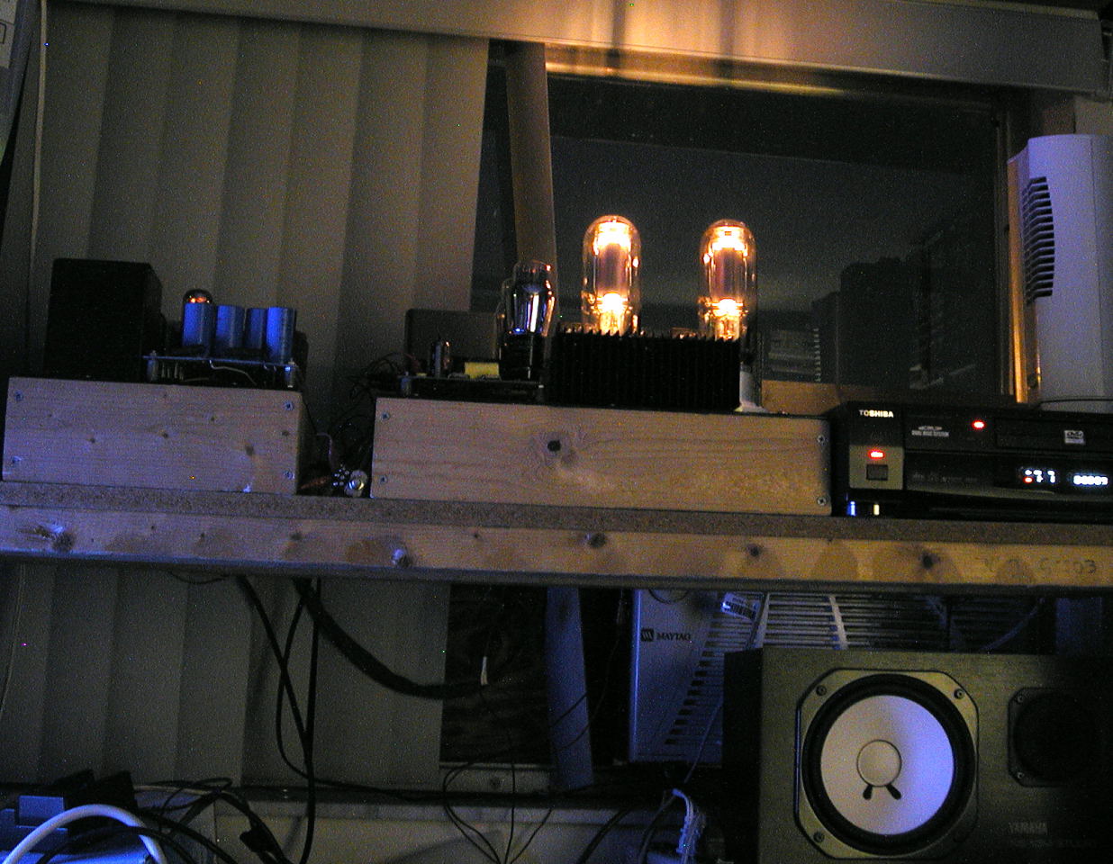

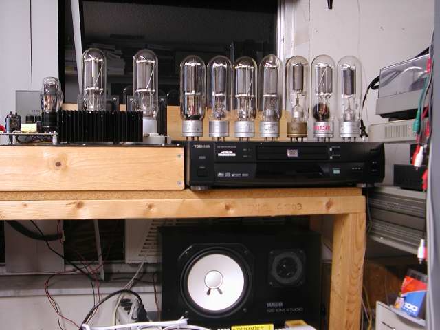

I built my 845 amp about 8 years ago. At the time (and even now) I could only afford cheap Chinese valves, so I ordered 4 so had 2 spare.
It's been in almost daily use since then and I'm still on the first pair with minimal re-biasing, even though it runs in A2.
True, I have run it in low power mode for much of the time PA 80W vs 100W but it's hard to hear the difference between the settings.
What can I say about it in defence of the OP? It sounds nice. It suffers from no blocking since it has no NFB. It has no detectable hum.
My wife, who is a music lover but not an audiophile, can hear a clear difference between it and a well built chip-amp.
It warms the house in winter. I had hoped to have a class D amp finished by now to run in summer - yes I'm sensitive our energy consumption's effect to climate change.
