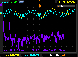

Yeah sorry for that. It s from the output of the vsps (connected to nothing) and the cartridge connected on the input
According to the Needle Doctor website, the cartridge impedance for the Concept MC is 11 ohms. According to the Phonoclone calculator, R1 should be 11 ohms and R2 should be 275 ohms. Those are what I will order.
dimkasta
Short the inputs and remeasure the output noise. That's your baseline reference.
The second image shows the output with the cart plugged in? That's 1V rms! What the heck...
60 mV channel difference on 1.5V is an imbalance of 0.3 dB (4%). That's about typical for a cartridge output, but a little high if this is just the VSPS circuit. Right now I'm not sure where your signal is coming from.

The second 3rd and 4th images are with cartridge reading a 300 hz tone from a test record.
3rd and 4th is "zoomed out" in time to get many samples for the measurements
That's all right then. 0.3 dB imbalance from a MM cart is about par.
If you could just remeasure the output noise with the inputs shorted we'd be all set.
