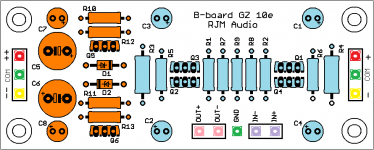

BIG OOPS!!
Just completed the first board, powered it up and the voltages are incorrect.
gnd - IC1 pin 4 = -1V
gnd - IC1 pin 7 = +11v
gnd - v- = -1v
gnd - v+ = 11v
The neg regulator is obviously off somewhere, I assume I have fried a transistor or blown an IC, but haven't really got a clue.
Wheres the best place to start trouble shooting? I haven't powered the other board yet.
gnd - v- = -1v
gnd - v+ = 11v
Cant edit, so second post addendum
v++ - v-- is ~35v so the PS is correct
Sorry Richard I didn't make it clear. This is a PhonoClone3 board.
Q2 is in the correct orientation (lettering towards the edge of the board, and is a BD 136 as it should be)
Missing trace section in Phonoclone 3 rev 35f boards.
The Rev. 35f Phonoclone3 boards have a 0.1" missing section of trace. Just spotted it now. Crap.
Fortunately there's a real simple fix, just a matter of wiring a bridge to the two closest pads. Will show in detail in my next post.
