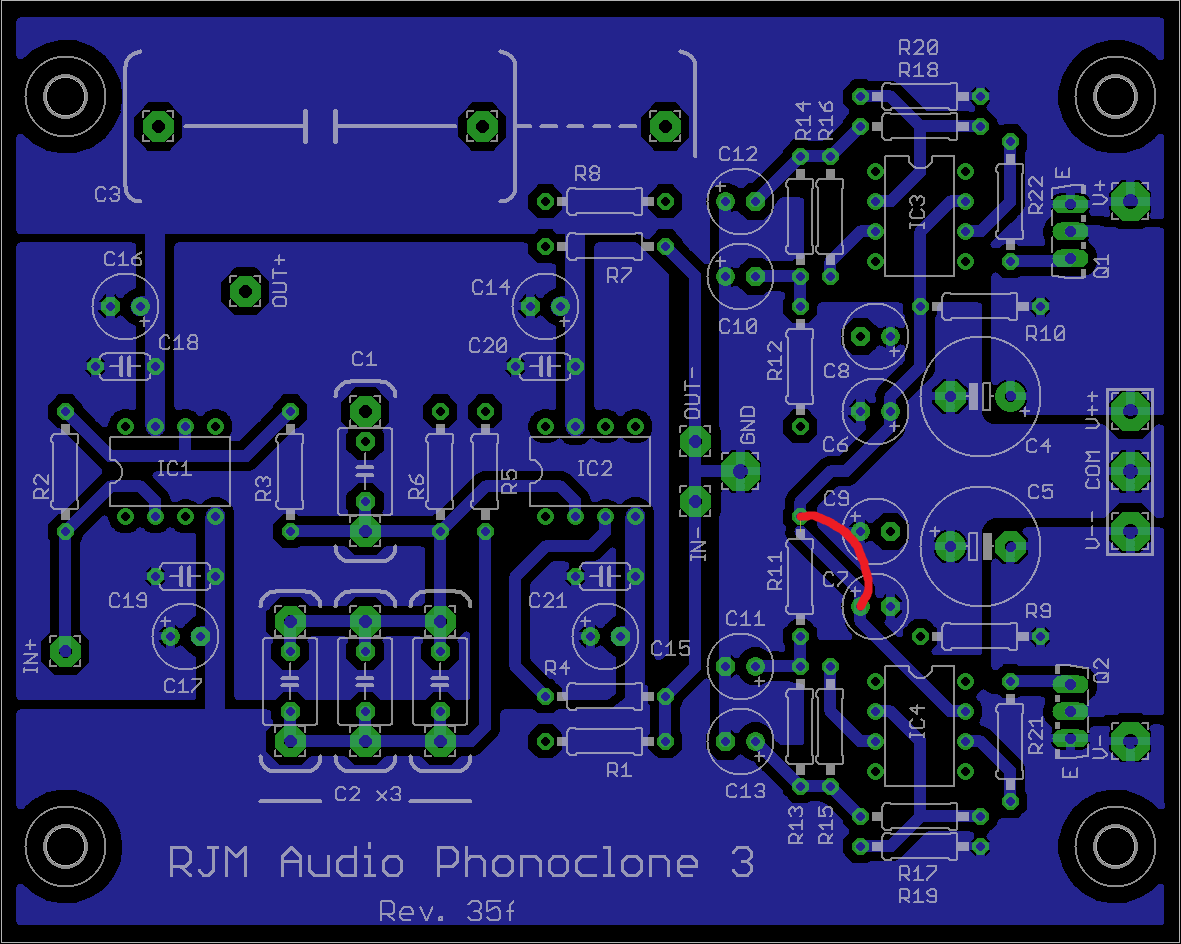

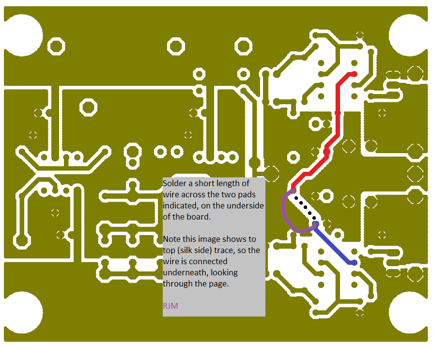

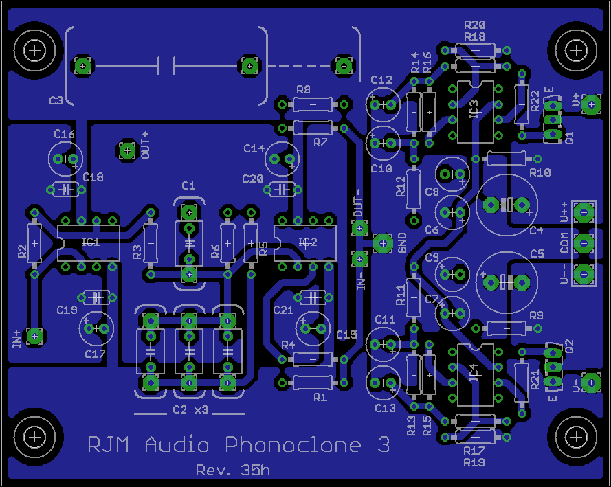

SERVICE NOTICE
There is an error in revision 35f of the Phonoclone 3 printed circuit boards. As a result the negative regulated voltage (V-) that feeds the phonoclone circuit (IC1, IC2) will not power up. DO NOT CONNECT YOUR CARTRIDGE TO THE PHONOCLONE UNTIL THIS ISSUE IS FIXED! The high input offset voltage could damage your cartridge.
The cause of the problem is known. A 0.1” section of trace on the bottom copper layer was accidentally deleted during the editing process of the rev. 35f boards. This breaks the connection to R11 from the power supply, so the negative side of the X-reg loses its reference voltage and the output drops to near zero.
The error is only present on the rev. 35f boards.
I will provide new, updated boards as replacements for the rev 35f boards that were shipped. It will take about 1 month until they will be delivered. People who have not started working their phonoclones are encouraged to wait for the new boards. Those of you who have already started soldering can simply bridge over the pads.
This attached image is a view of the Phonoclone 3 board looking at it flipped over, showing the bottom trace. The missing section of trace is just a tiny sliver above the bottom pad of R11, at the lower orange arrow.
To get the boards working, a wire (shown as the red line) must be soldered between the two pads indicated by the orange arrows. If I was building the boards from scratch, I would just bend the lead of R11 over to the lead of C7 and solder the two together. If I had already completed the boards and trimmed the leads, a spare section of resistor lead bent to the right shape to go across the two pads would serve just as well.

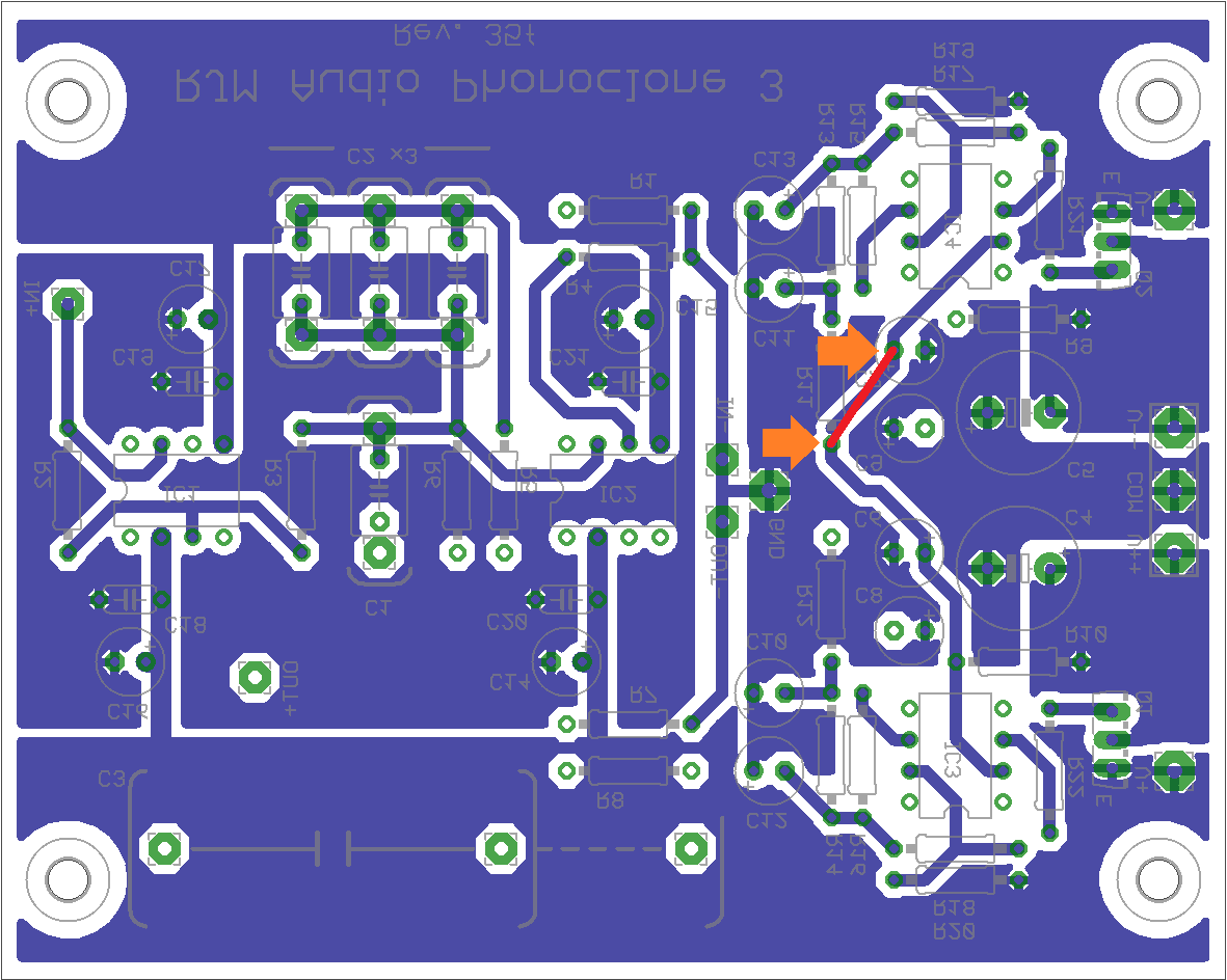

Phonoclone 35h
Gradually climbing out of the hole I dug for myself. 🙁
Phonoclone 3 boards rev. 35h, which fix the trace issue found on 35f, has been drawn up, finalized, and sent for fabrication. Turnaround is about 2 weeks back to me, another week or so to get out to those who need them.
Many thanks Richard. Missing trace linked, and everything works perfectly. Even from cold its better than my Dynavector P75 (SWMBO agrees too)

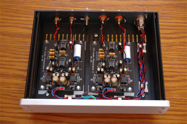

Something is amiss
I finished my Phonoclone 3 boards this morning (rev 35c). The power
supply checks out. The voltage at IN+ and IN- and OUT+ and OUT- are 0
V. V++ and V-- are 35 V. IC socket 1, however reads +.6 and -.6 V.
The only thing that was not by the book was I used at 2610 ohm
resistors at R2 when your Phonoclone calculator calculated 2500
because I had them on hand.
The cartridge is the MC that comes with the Clearaudio Concept turntable:
MC Cartridge / Pick-up:
Output Voltage (1kHz, 5cm/s): 0.4 mV at 5 cm/s
Channel Separation (1kHz): > 30 dB
Channel Balance (1kHz): < 0.5 dB
Tracking Ability: 80 μm
Tracking Force: 2.0 gram (+/- 0.2 gram)
Load Resistance: 100 Ohm
Load Capacitance: 100 pF
I used 100 and 0.4 in the calculator and it read 100 ohm for R1 and 2500 for R2.
I went ahead an put in the ICs and hooked it up. No sound came out
when hooked up to the turntable and amp.
Here is a pic
Any ideas?

0.6 V is characteristic of the transistor diode drop, it seems the problem is with the X-reg part of the circuit.
Please double check that BD135 is Q1 and BD136 is Q2, and the lettering facing into the board for Q1 and out of the board for Q2.
Also, just as a note in advance: using non-insulated RCA jacks is not recommended as this means the circuit common is connected to the chassis at multiple points causing ground loops. Also, having the power and input wires mixed up like that is likely to cause noise coupling from the power supply to the input, causing the circuit to hum.
Mr. Onion just posted a photo of his build to the Phonoclone forum, and I'm going to borrow that here as an example of what a functional and clean layout can/should/would look like.
😱 That's it. Q1 and Q2 are installed backwards. While I have it apart, I will go ahead and rewire the boards in a more organized fashion. I was trying to keep the wires as short as I could, but I understand your point about the power wiring being so close to the output wires. I will also gets some insulated RCA jacks as long as I have it apart.

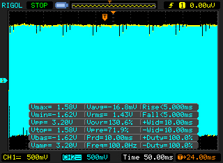

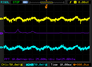

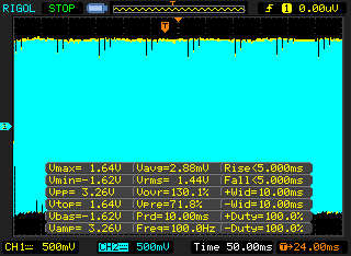

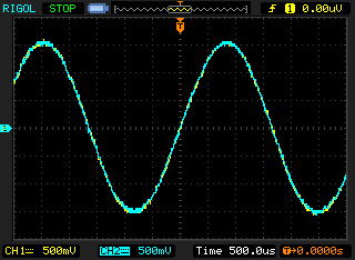

Maybe I should try to measure it using my scope.
Speaking of which, could you please advise on how to get rid of the noise below? Peaks appear on 50 and 100Hz. 50Hz is probably noise coming from the rectifiers or the noisy transformer, not properly filtered by the crapola lelon caps on the regulators? (can t wait to get the mouser package with the nichicons, the torroids and the vishay bridges...) How about the 100Hz one?
Also, at first glance, the output seems identical on both channels
However, on a second read, the right channel seems to go ~60mV lower than the left on its top peak (could be cartridge anti-scate or azimuth issue?) Need to further investigate that. Too tired now.. need some sleep.
Thanks again
PS...damn... I need a signal generator too... and a high accuracy CLR meter... 🙁
Thanks again
You also need to give a more detailed report! I have no idea what I am looking at. :/
Is this really the output of your VSPS? With a cartridge or dummy load attached? Output noise will be very high if the input is left open circuit... but still I'm seeing in the first pic 20 mV of power supply ripple, which would be very high indeed. Normally there should not be any ripple visible on the output above the noise floor.
It looks like ripple to me, i.e. noise pickup from the rectified voltages, V++, V--.
