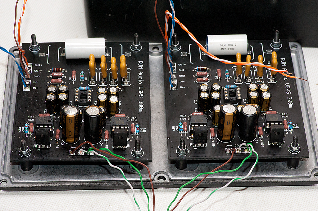

Sometimes I feel so damn stupid... or even dangerous...
I trippled checked everything, and I forgot to check the xlr socket on the phono side...
Results.... giving com to V-- and V-- to com...
Further results... the capacitors on the V-- side errupted in a squishy electrolytic fountain...
I am really frustrated right now... do you think anything else might have gone along with them?
Is it worth investigating?

That's a shame, you had everything else all nice and working, reversing V-- and COM on the power supply is game over I'm afraid: all the electrolytic capacitors will have to be replaced because even the ones that did not burst may be damaged internally. Not just the negative side eithe: since you put V-- to com that means the positive caps all saw 35V which is above the maximum rating of 25V, so they are likely damaged also.
For the transformer vibration stop now before you hurt yourself. Leave everything unplugged and examine everything again. There's a big problem, and since this involves the AC voltage you don't want to be poking around with the power on to find out what's going on.
Either you connected the primaries in reverse phase (most likely) or if you are only using one bridge rectifier, the secondaries in reverse phase (with two bridges this error is at least avoided), or you have a closed loop of conductor passing through the center of the toroid (the end of the screw holding the transformer shorting to the lid of the case will do it).
Probably best to post some photos of the power supply here, so we can have a look.
