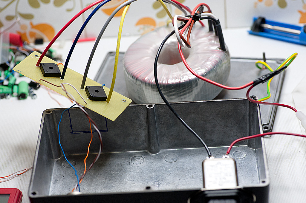

OK I will check your suggestion now.
in the meantime, same test with a different 182P12 and GBPC102-E4/51 rectifiers this time.
EXACTLY the same results.
Further measurements show that the AC on the secondaries (bridge input) is 12,4V at all times.
What changes is the DC voltage on the output of the bridges.
I am also posting a photo of the circuit, in case you have any idea of something that could 've slip my mind. The transformer is wired for 230V operation. White and brown wires are soldered together to give primaries in series. The lower voltage on the output occurs when I feed the phase of the power line to the black(dotted) wire, and the normal when I feed it to the orange. Secondary dotted wires are red and grey.
I also tried with the fuse connected before the black wire. Same behaviour (11.5V when phase is on black).
The case is earthed through the IEC's metal body.
The board of the bridges is a goodish quality protoboard.
On the output side, blue is V-- (xlr pin 2), orange is V++ (xlr pin 1), brown and white are common center (xlr pin 3). No xlr pins are grounded (neutrik chassis socket).
PS the case is too small for the transformer. I just use it for now to keep everything in place. I do not close it for the tests.

I measured the transformer.
Primaries in series are 12.2ohm.
Secondaries are 0.5 ohm each.
When I measure resistance between primary and secondaries I get absolutely no action. Like no connection is detected. Same between the two secondaries on all combinations of wires. Measured with 3 different DMMs.
I guess there is no problem with the transformers after all?

Maybe a typo but you mention orange twice, first to serialize the primairy and second you connect the phase to it, should the second time be red?

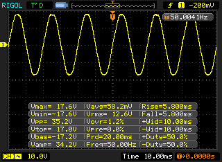

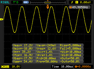

OK... here is the output of the secondaries (while attached to the bridges). It s actually not symetrical... A problem in the power network?

I'm beginning to think it's all some measurement artifact. There does not seem to be anything wrong with your power supply.
I'd go ahead and attach to the VSPS and check the measurements again. It might that without filter caps and unloaded, the interaction with your meter/scope is causing strange effects.
Looking at your latest scope trace, and almost certain of it.

Here is the output of the secondaries with VSPS connected.
