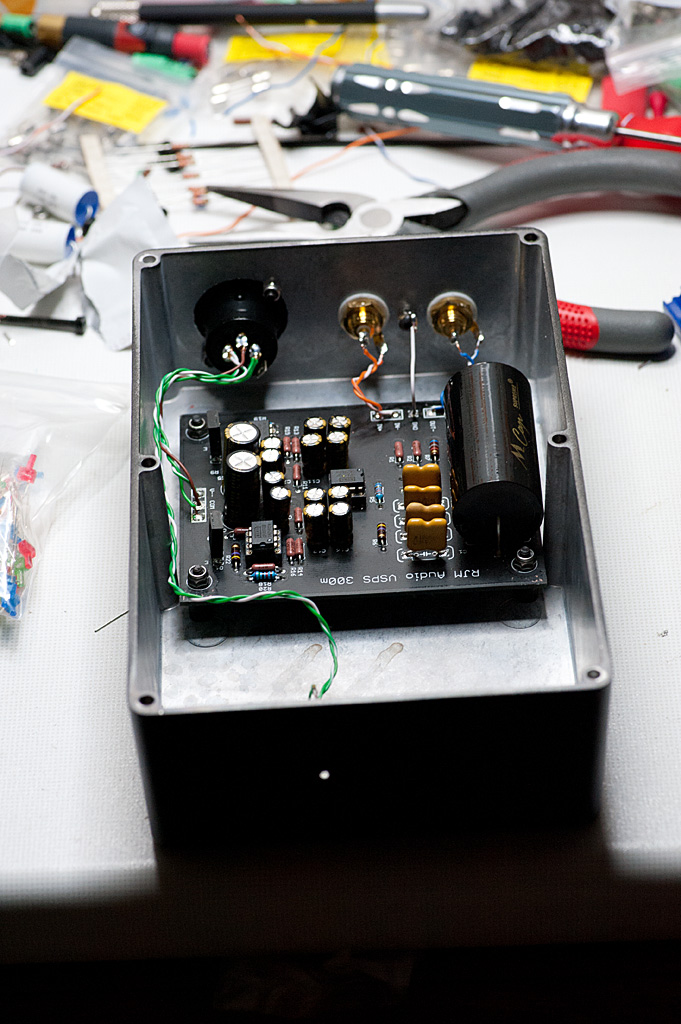

The mundorf capacitors were a nice opportunity to move into a full dual mono topology.
Their damn size was too big to fit in the case the way it was drilled (connectors were on the way), so I decided it was time to redo the case-work.
Here is a quick look on the new layout.
I did not hear it yet. I still have to work on the second channel and on the power supply.
I would like to hear the effect of the capacitors with the same power supply as well to see how they affect the sound, but anyway.... 🙂

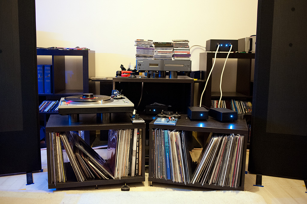

One week further into breaking in, and things finally seem to have fallen in place.
The VSPS 300 with the Mundorfs has finally shown its teeth. The Nichicon electrolytics required about 100 hours of breaking in. At the moment I do not feel the urge to change anything, as it simply surpasses any phono I have tried (including some that worth a few thousand euros).
The only changes that I will try (mostly because I have already ordered the parts) is to fiddle with the X-Reg divider to give 10V to the op-amps, a single big case with single grounding points and better wiring arrangement with pure silver wire to further reduce the minor humm that still remains (probably from my 3f tonearm cable) and finally replace the 120VA toroids with 160VAs again. Oh and I want to replace the umblicals with something... nicer than the plain power cable...
This building experience has been a real eye opener about the design and quality of some so called high-end devices...
Oh and the phono is a perfect match for the LightSpeed passive preamp.

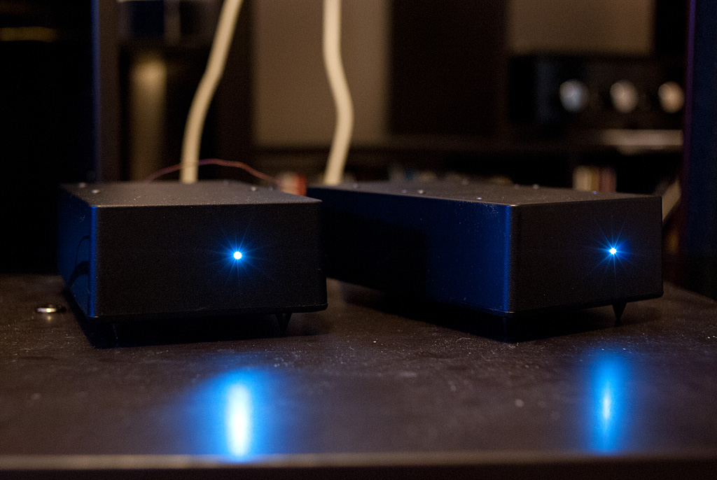

And here is some porn because I know you like seeing stuff 🙂 (leds are white not blue... damn white balance...)
Fun fact: White LEDs are blue, the camera is being more honest than your eyes. There's a phosphor in front to convert the blue light to longer wavelengths, so the total output looks white, but there is still a strong blue bias, especially around the edges where more of the original blue light leaks out around the phosphor.
Hehe yes those damn thingies have a bluish tint anyway. But still there should be no "camera being more honest than the eyes"... A camera should be honest to what the eye sees... anyway, it s hard to balance the colors even manually when you have 3 different light sources with different tints (tungsten ceiling bulb, actinic blue from aquarium and fluorescent green from desk light)

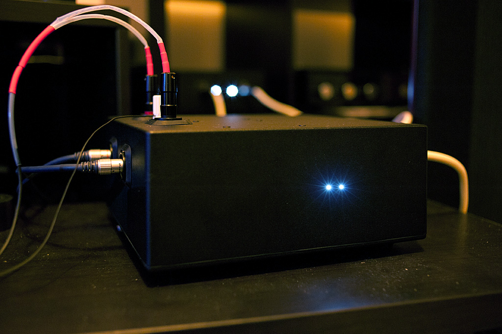

Yesteday I moved everything into a big single case with clearer cable topology with power, input and output on completely different sides of the case and nice big Neutrik sockets for everything.
Unfortunately it was late when I finished and could not test it on proper listening volumes, but a first impression from low volumes was that it has cleaned up a bit, although bass seemed a bit leaner (could be the new cabling).
Today I will also replace the 120VA toroids with the 160VA ones, and that will be all for now...
Going to work on my turntable next.

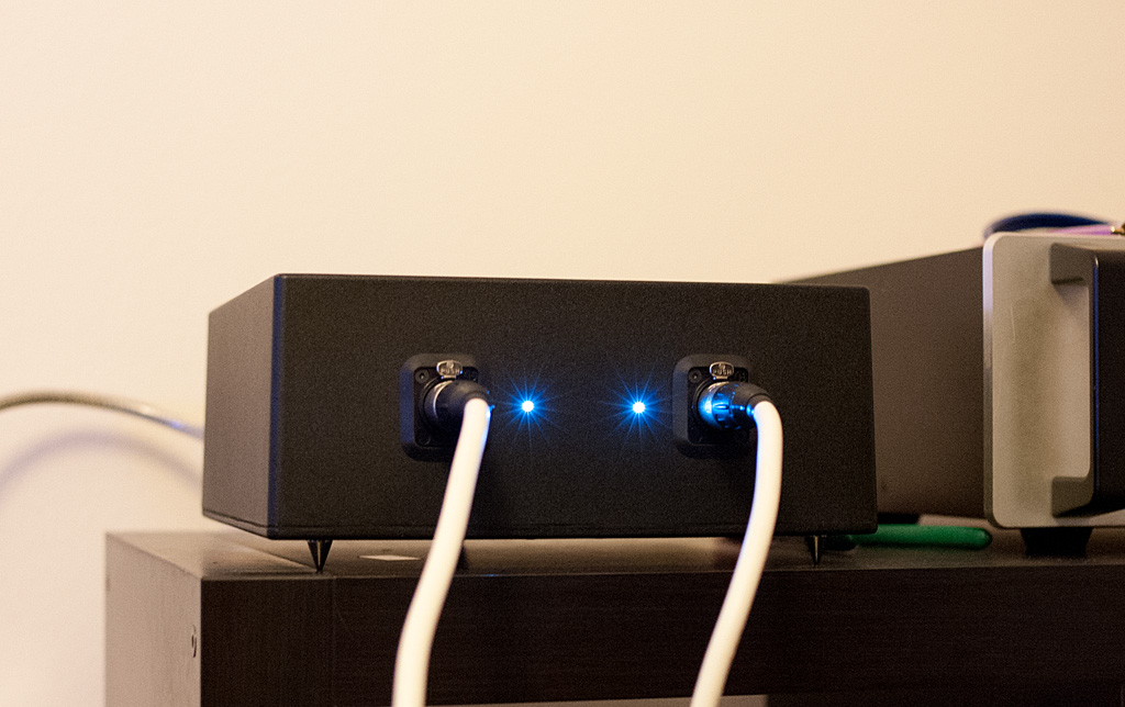

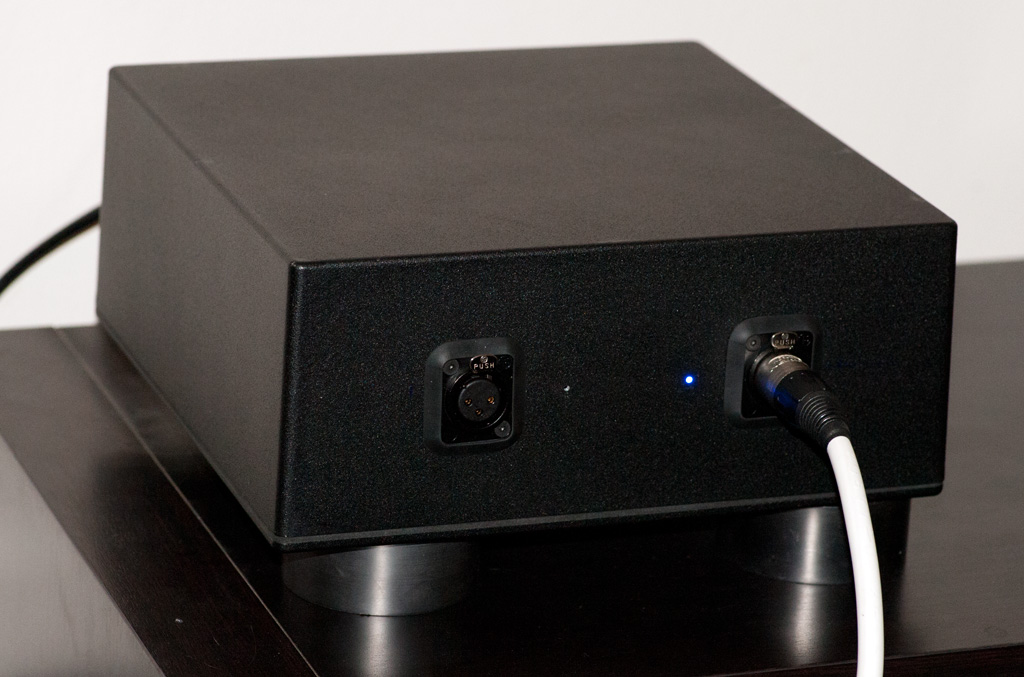

And here is a photo of my final chassis (no white balance this time, so that you can see the white leds properly 🙂 ).
Might seem a bit weird, but it was well thought of. All cables are far away from each other. Input is on the top to allow the cable to "float" away from all other ones while coming straight from the tonearm (still have work on that area).
The output is on the left side, while the power input is on the right. This besides from keeping them away from each other, will also allow for easy plugging/unplugging when I move it to its permanent place. Not very WAF friendly, but meh... 😀
