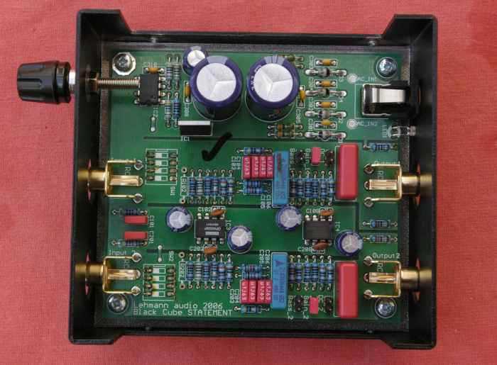

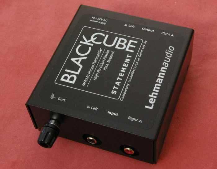

I'm considering buying a turntable again. So I started looking for a phono pre-amp. After a bit of research I found the Lehmann Black Cube Statement.
I was wondering if someone could tell me if the VSPS 300 is in the same league as the Black Cube or maybe better?
product page / review
Dual op amps, wall wart power supply. I expect the VSPS300 to sound better, but the Lehmann is more flexible, with MC and MM compatibility and different loading options.
I haven't used the VSPS300 or Lehmann so cant comment directly, but the PC3 is shed loads better than the Dynavector P75 it replaced, and that is broadly similar in concept to the Lehmann
