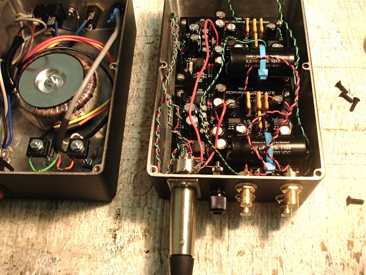

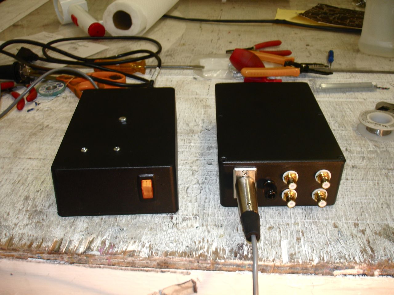

Hahooo! Phonoclone!
Finished and sounding great!...pretty much your standard unit the only changes from the BOM was Mundorf M-Cap supreme output caps, the 100Uf caps were upgraded to Nichion Muse (a little bigger but still doable, don't try Muse in the 1000Uf slot as they are too big) and I used some sheilded cable from the tranformer unit.. looking forward to some good times,

@simonov
Nice work, from what I can tell from the very small photo you posted... it looks like a stereo VSPS.
Richard
Yes you are quite right.
p.s. I'm using a external link to the image. I'm not quite sure why it shows this way 😀
