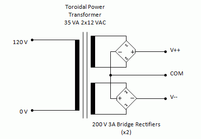

I generally recommend a trip to the local library and some basic electronics textbooks. It's not hard but power supplies involve playing with line voltages so some general understanding of electricity and electronics is required, in addition to the bare information.
2x12 VAC sec : a transformer with two 12 volt secondary output windings
1 or 2 bridge rectifiers : exactly what it says.
If you don't know what a bridge rectifier is, or if the diagram below makes no sense, it's your obligation to do some self-study before starting building a Phonoclone.
