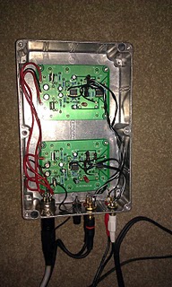

PCB with straight traces at the back - horizontally to the picture. Grounds come together in one trace (except line outputs which are at the back). Kind of a hybrid between VSPS / VSPS 300. I'm using NE5532 at the moment which I had lying around, but I can quickly rewire for single op-amps.
I've put the Talema transformer in too and earthed the casing as well. Whatever little 100Hz harmonics was left (only measurable..), is now totally gone.

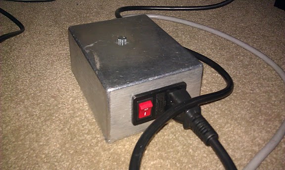

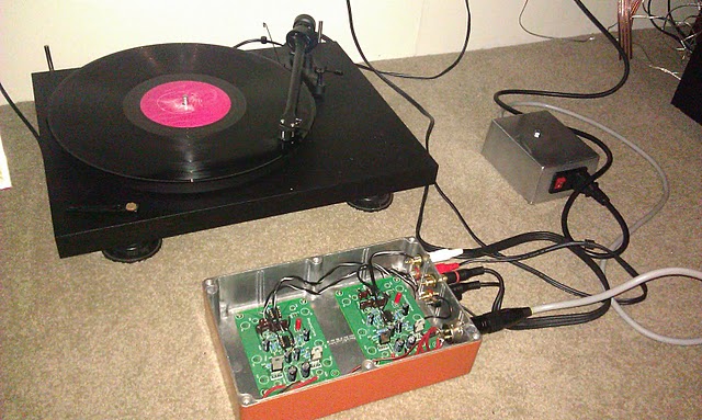

Well, after a year or so rest, my phonoclone fired up pretty well this afternoon!
I've attached some pics of my turntable, phonoclone preamp and power supply.
