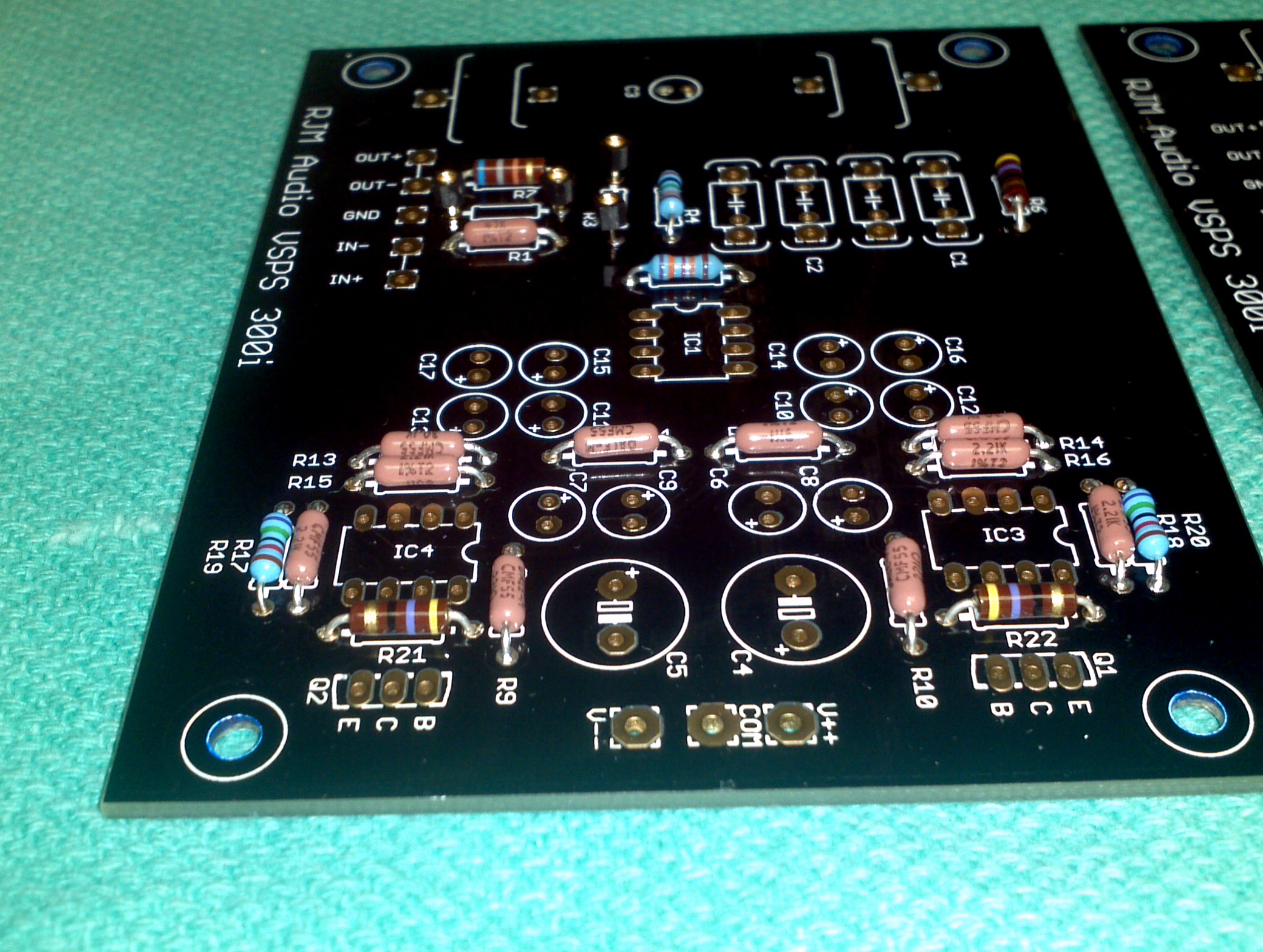

Soldered resistors in the VSPS last night. I used sockets at R2 and R3 so I can change resistors without desoldering and resoldering. Hope that works OK. Those boards from RJM took a little getting used to since they are thick and gold plated. They heated up a lot slower than the component legs so adjustments to my soldering style was in ordered. Finally got it sorted I think.

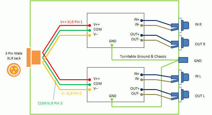

Wire Routing Suggestions
I've got almost everything in place but need some advice as to how to run the ground wires from the boards to the case/turntable ground. Should I twist up a pair and have them split into 2 separate wires at the center of the boards? Should I just run single wires around the case to the ground? Can I just run a jumper from 1 ground lug to the other and then run a single wire to the case? Are the grounding wires prone to pick up hum or am I worrying about nothing? I'm planning on grounding near the input jacks (bottom of the photo) so fewer cables have cross to opposite sides. Thanks in advance.

Ground wires are by definition low impedance and are therefore not sensitive to noise pickup.
I would run one wire from (R) GND to the case, another wire from (L) GND to the case, using spade lugs to connect the wires to the bolt at the case side so the boards can be disconnected easily later.

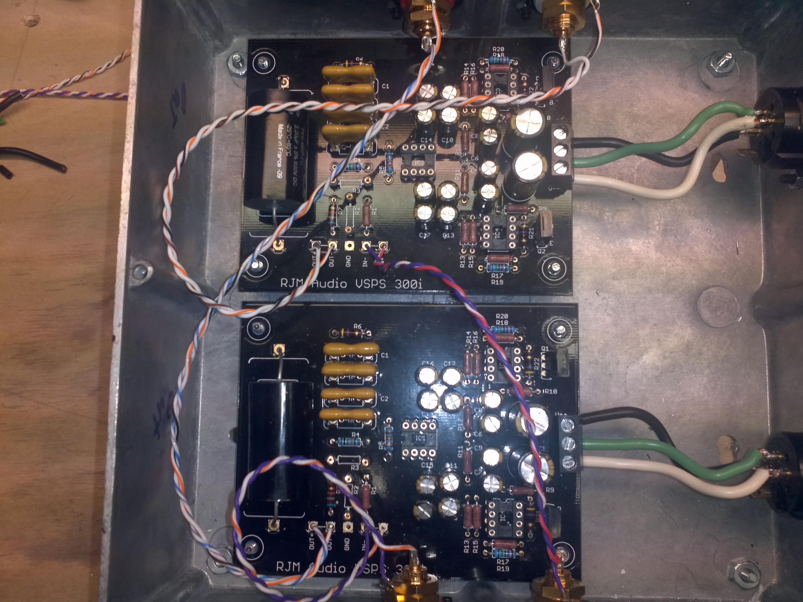

Q1 & Q2 were reversed and overheating pwr supply opamps/drawing high current..
Removed and properly installed Q1/Q2. Current & temp now OK.
Amp seems to work OK/clean except for hum level is quite high, but not audible except at very low/no music levels.
If inputs are open, hum is quite low-matched by white noise, and only audible at very high volume setting.
If inputs are bridged (shorted) hum is huge, at the level of what a music peak would be at the set volume level.
Since the opamps in the power supplies were overheated, I removed them from one channel and moved the gain opamps from the other channel over into their sockets in case they were damaged from overheating: no change.
I also checked AC V @inputs w/ my Fluke 88 lowest range, 400uV AC: it quickly settles at .1uV on both channels which I expect is close to true.
I have tried all the usual phono ground gambits learned in 40 years of trying to minimize it with little effect.
VSPS passed the smoke test today with flying colors. Perfectly silent, tight mid and bass. A little splasy top end my friends say but my high frequency hearing is poor so I didnt notice. This was in a friends system that I am unfamiliar with. I'll give it a listen in mine tomorrow! Thanks for all the help here.
