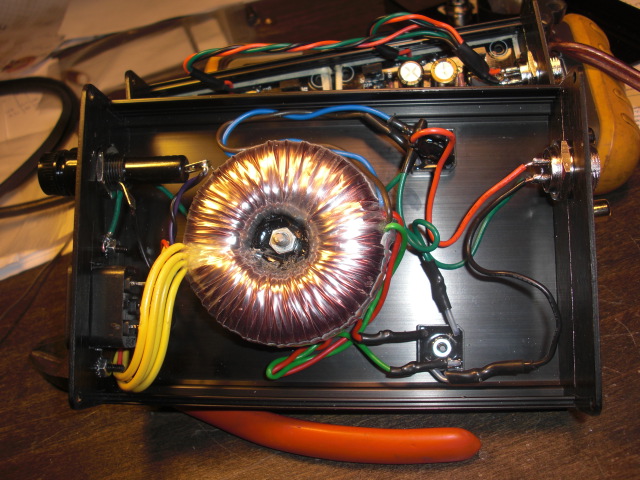

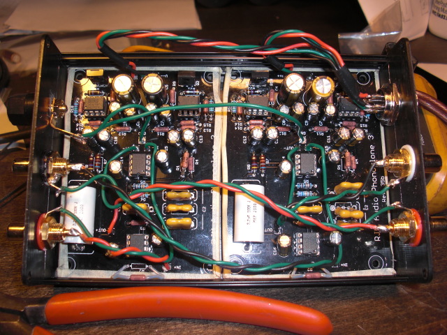

Sorry for the delay getting back on this. Everything that I can see in the photos looks fine, it's a tidy build, with good cable dressing, all the caps connected in the right orientation etc, so I would not expect a large hum/noise.
Most common cause of undue noise is setting R2 too large for the cartridge used.
The temporary skew of the voltage rails is odd, and would suggest one of the voltage divider resistors might have gone open circuit due to a poor solder joint.
Basically you want to double check all the V+ and V- voltages are hum free and at the expected value of +/- 10-11 V. Then figure out if the hum is 120 Hz or 60 Hz, if in both channels, and if it changes in intensity with the inputs open or connected to the cartridge... and we'll take it from there.

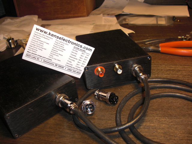

Richard and all:
I completed the amp while we were running on a generator and initially it had bad hum on L channel but sounded OK.
Got back to it recently. Found the voltage dividing resistors had a problem-zero drop across R16 and V=+/V- skewed +~3.7V. I tagged meter on board and started looking for a short or whatever & suddenly OK. No amount of flexing/banging/disturbing board or components caused a glitch; left powered up 12 hrs w/Fluke in record mode-no problem/V delta was .3V.
I am not satisfied with the noise/hum that remains. Here's pics of the build as requested by Richard (shameless plug for Ken who supplied the neat/compact 4 pin Mic connectors for power supply)
I will post measurements soon.
Regards, Phil in NJ
I finally got back to the clone. I had made R2 96ohms to get ~42dB gain w/.8mV med output Benz, hoping to level match my B&O carts thru the Yamaha C2-x control amp. The background noise level was pretty bad, and the level was too low.
So I removed R1s and R2s and soldered in sections of IC sockets as suggested by SpecialIdiot (sectioned the plastic across 5 pins, pushed the middle 3 up and out of the frame, leaving it more rigid) and raised R2 to 300ohms.
The hum and noise remained the same, but the S/N got much better and acceptable to me.
I see Richard's admonition to avoid values below 500ohms for R2-maybe this is why?
