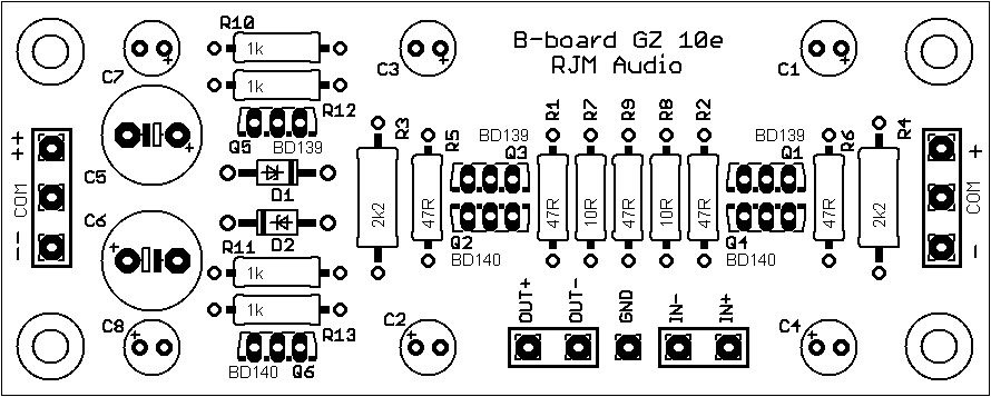

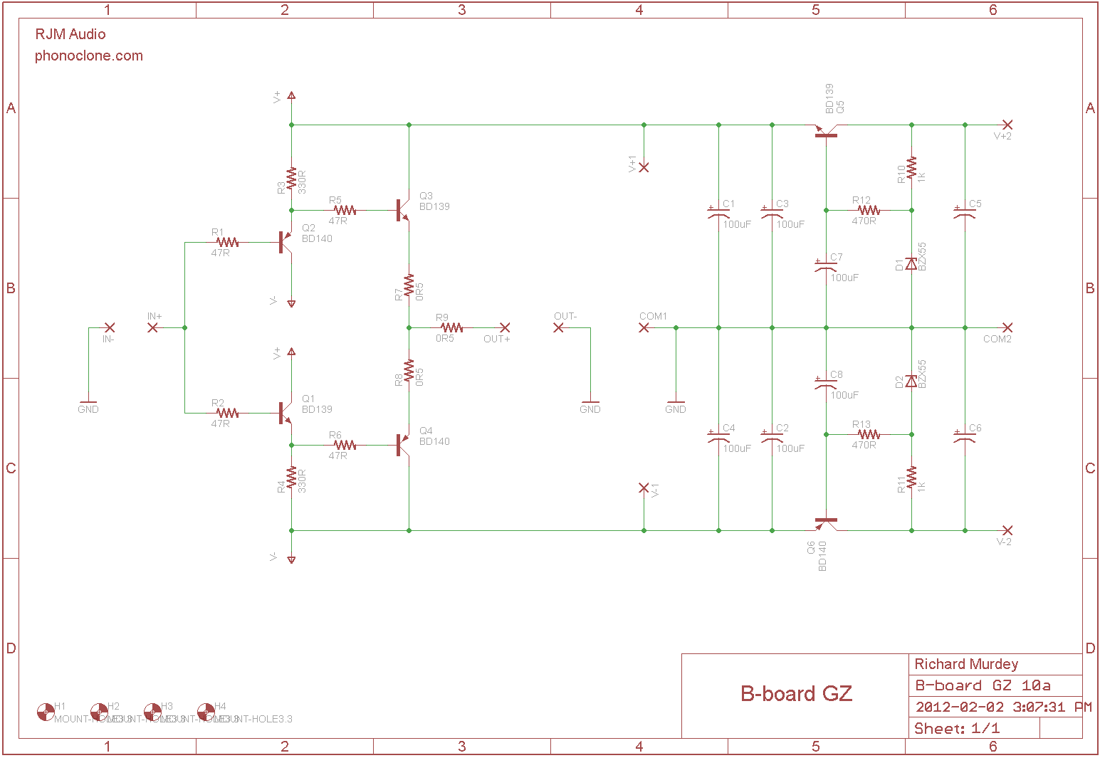

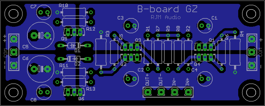

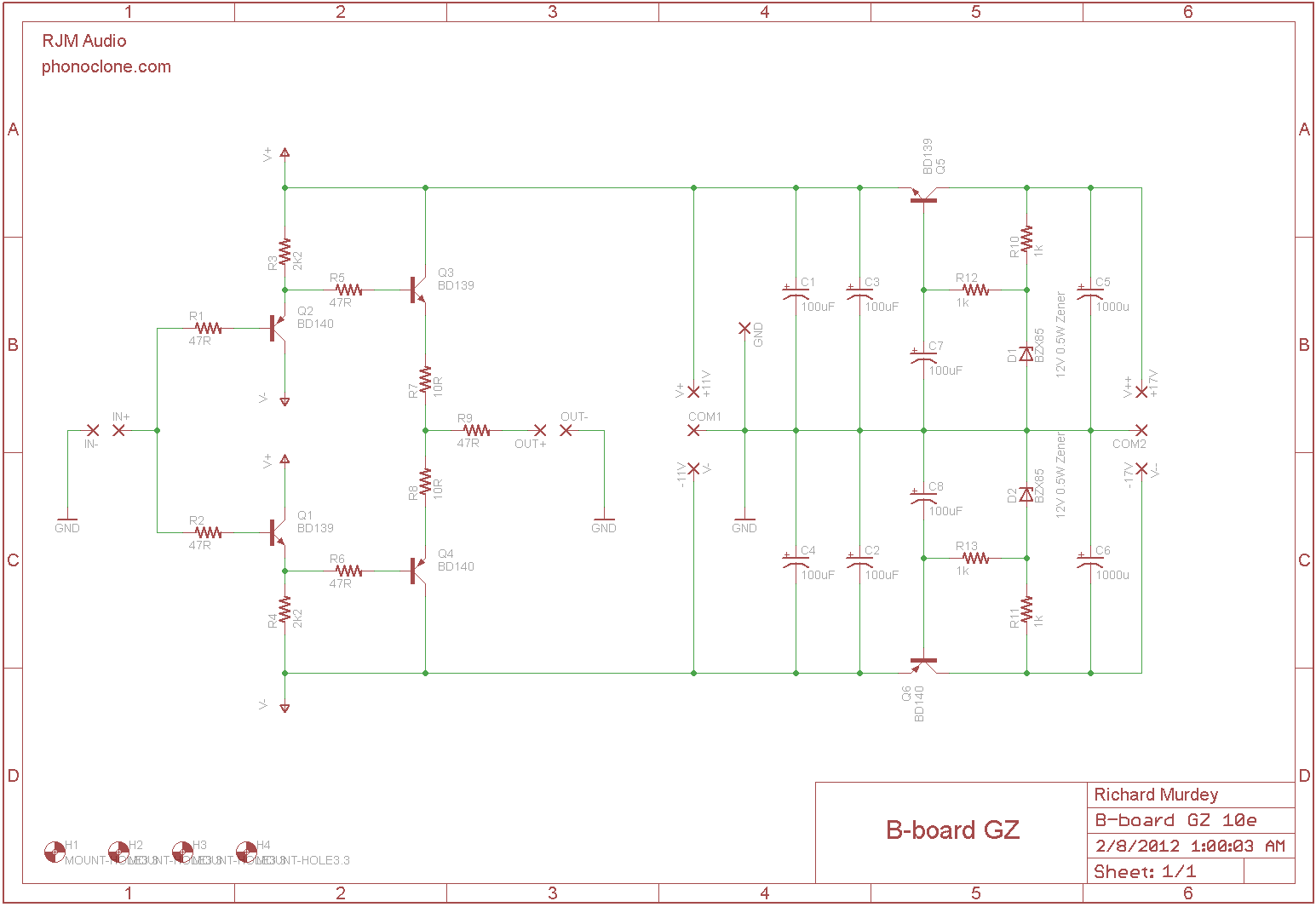

I'd like to bring this design idea I've been working on recently to your attention. It's an add-on line driver (output buffer) board for the Phonoclone, VSPS, or - just about anything with an op amp output stage. It also makes a nifty headphone buffer.
I've held the opinion that the way forward with the Phonoclone etc. was to stop the op amps from driving the interconnect directly. I didn't have enough room on the boards to build in a buffer there, so I suppose this is my answer: separate, general purpose buffers to retrofit or use in new builds.
Full kit of two boards and parts would be <$50, with very special pricing on the initial batch of Guinea pigs, as usual.
I call it ... the "B-board". ("B" for buffer.)
Any interest??
- 1/2 the size lengthwise of the Phonoclone 3 and VSPS300 boards.
- Shared BOM : same transistors, same capacitors, many of the same resistors as the P3 and VSPS300.
- Based on the classic "diamond buffer" circuit (c.f. LH0002)
- Built-in Zener voltage regulator, runs independently of the X-reg in the Phonoclone board, just hook it up to the same V++, V-- unregulated supply as the main boards.
- Zener regulated voltage V+, V- is accessible if you need a regulated source for any other low-current circuit, such as a DAC or a op amp voltage stage part of a preamplifier or headphone amplifier.
- Cheap and simple. BOM is ~~$10 + board cost.

Many opamps are just not up to the task driving tough cables. A discrete buffer is always the better choice for the task. It is important to say that a better precision can be obtained if one include this buffer within the NFB loop. This would result in better overall stability and lower DC offset.

Alright, I will go ahead and get some of the B board GZs made up.
Btw the way, I am in favor of leaving the buffer outside the NFB loop, running open loop in other words. This keeps the feedback loop completely isolated from the instability(overshoot, etc)-inducing effects of the cable inductance/capacitance. The sound is better I think.

Martin,
Adding a buffer into the feedback loop of the Phonoclone would involve cutting traces on the board .. not what I had in mind when I suggested this buffer idea.
Open loop is the way to go.
Richard

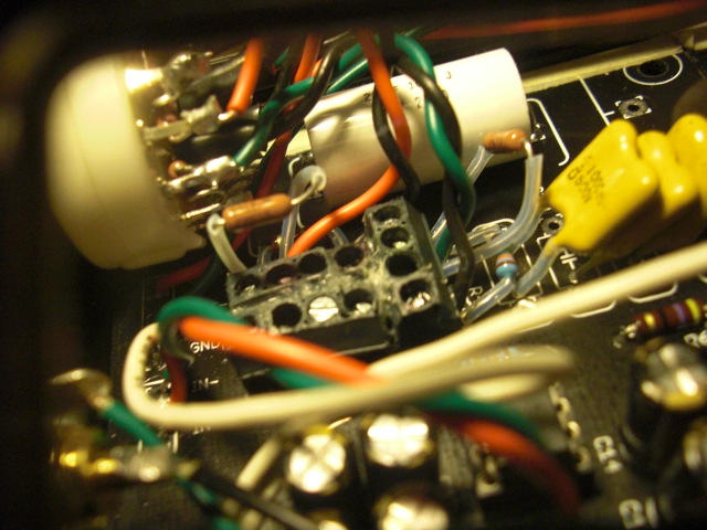

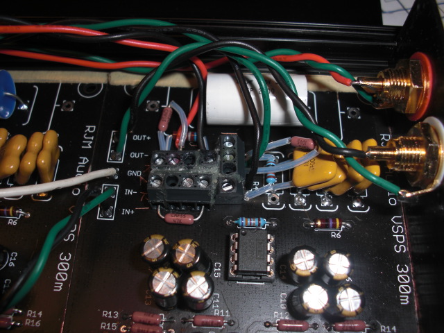

VPS 300 w/gain

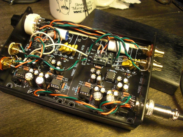

Here's a VSPS with selectable gain (30/4050dB) that I built.
To fit the compact case (FRYS.COM #2090829 $17.99), it's necessary to trim one end of each board 5mm with aircraft snips which happens to be the tops of the letters (VSPS 300).
The first issue was to source solder in screw terminals for Richard's boards which have a 10mm hole spacing. I can find 10mm terminal blocks with ,9mm flat pins but they are too large and the pins are 1.2mm diagonally.
So I got triple blocks w/7mm overall spacing/.9mm pins and vacant middle terminal bay. (digikey #ED1534-ND)
I cut the end terminals off donor triples to become the 4rth section of a 10mm quad.
I removed the 3rd pin/screw from the 3rd bay of the intended assy, removed the pin, and reassembled it w/it's screw in the 2nd bay. A little fileing to the end of the 3rd bay and, with donated 4rth bay, you have a 10mm terminal with extra/isolated bay.
These all fit together on the board in place of R1/(load resistor & loading cap if wanted), and R2/R3 the "gain" resistors, and with a little epoxy for plastic becomes a monolithic terminal station for making changes.
A 4x3 rotary switch w/2 resistors/section and the 3rd step across bay 1&2 of each respective terminal block completes the deal.
Very satisfied with this setup so far-using w/med output (.8mV) Glider and it's dead quiet. Switching gain while in use, no clicks or pops (Swx -Mouser #105-GKS1461-shorts between positions-$13.56)
The values I used for the R2 cascade: 221(on board)/475/1500 yield 221/696/2196; specified is 220/680/2200.
The values I used for the R3 cascade: 475/1500/825(on board). (These are less important but are still pretty well coherent with spec'd values)
When you build this, check your thinking by putting the respective cascade pairs in series thru your ohmmeter, Each swx position should be close to 3K. If it is, you got it right! Think it through when you build it and it'll be right unless your name is Phil!!
