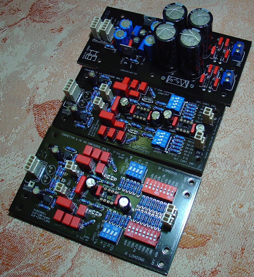

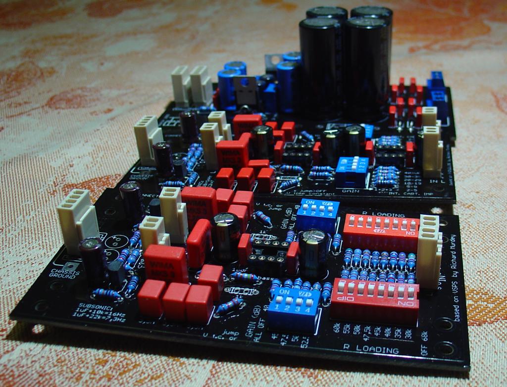

it's useful way of my project.
you have plenty space inside the PSU box.

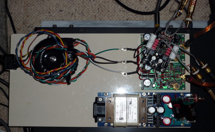

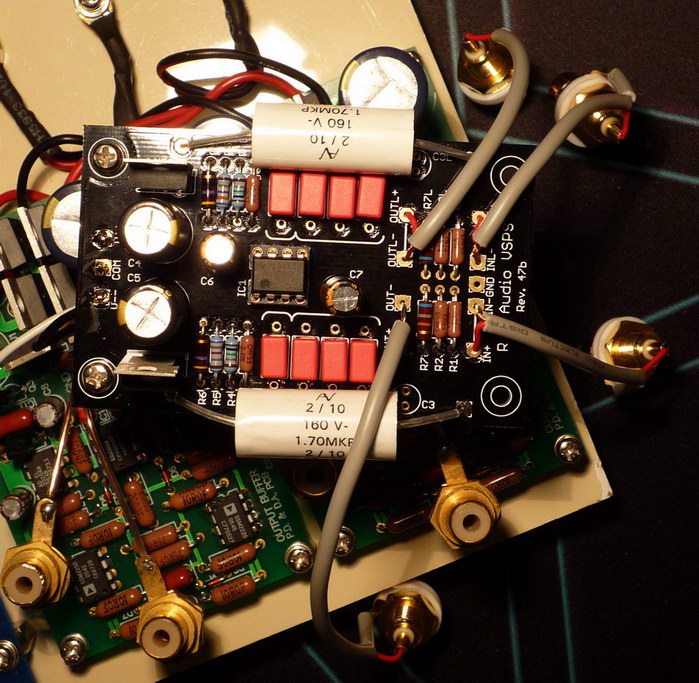

guys,
got my phonoclone 3 put together into my system. Sounds good so far.
It's got almost no notable hum, however with it cranked up on idle, I get a bit of hash-noise. I think it's the diode blocks. I tried putting 100pf at C0. get the same amount of noise. Would using something akin to a MUR860 and some 10pf caps across them help reduce this noise? Is the diodes what I am hearing.
My speakers are very sensitive, so makes this noise a bit more notable.

With sensitive speakers with the volume cranked up, the hiss/hash will be quite loud. What you are most likely hearing, though, is the fundamental op amp output noise. The diode spikes don't normally show above that, with the phonoclone 3 design anyway.
r2 1.5k is the recommended value, or at least 1.3k is, as per the latest BOM worksheet, but reducing the gain will certainly reduce the output noise. The signal to noise ratio remains ~constant, this is no "fix" as the noise source is fundamental to the op amp. If it makes for a more comfortable match to your system, though, by all means drop r2 to 680 ohms or so, which knocks the gain by 5-6dB from 60 dB to a still respectable ~54 dB.
thanks RJM,
I will give it a bit more time, to see where the volume sits compared to other sources and possibly drop it a bit. It's good to know the source of it anyways, as unknowns can bug me!
