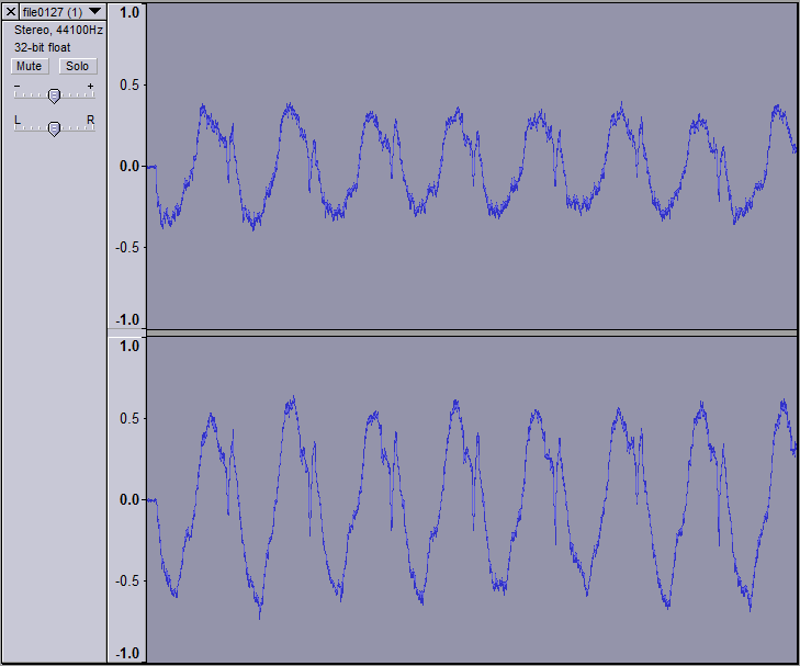

Protos was kind enough to send me a mp3 of the output. This reminded me: anyone who has concerns should first record the output of the phonoclone with a computer soundcard. It doesn't have to be ultra-high fidelity, once you get the .wav data you can make an analysis of the power spectrum and this plot gives you and everyone else a very precise idea of what's going on.

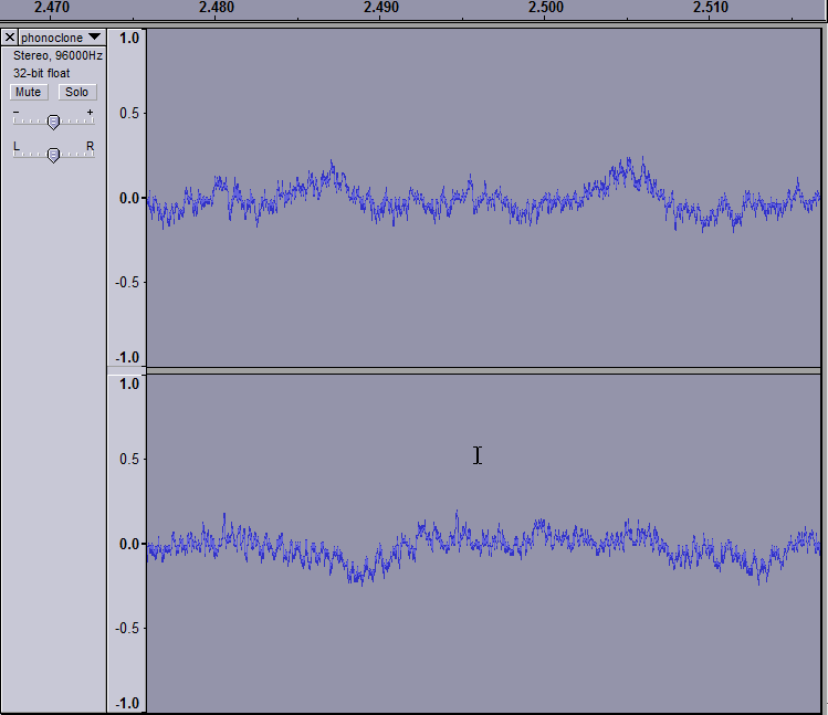

@protos : sorry to air your dirty laundry in public, but here's your noise, amplified by 50 dB. (its from the first segment of the clip you sent just before the music) There is a clear level difference between channels, a 50 hz sine wave, and what looks to be a nasty diode turn off spike.
Looks to me like ground loop or straightforward noise pickup due to insufficient shielding. I'm cautiously optimistic this can be tackled.
Please give me another mp3, this time of the phonoclone output noise with the tube amp off, the turntable off, the room lights off, but keep the cartridge (or dummy resistors is that's what you have at present) plugged in.
Thanks-
/rjm
PS I include my own noise data with the same 50 dB amplification applied. It's not level matched, but as you can see your hum is not sticking that far out of the noise floor. It's pretty mild ... indicating straight noise pickup rather than circuit oscillation.
