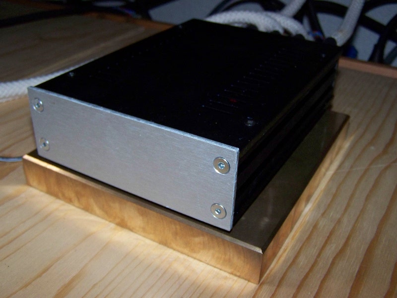

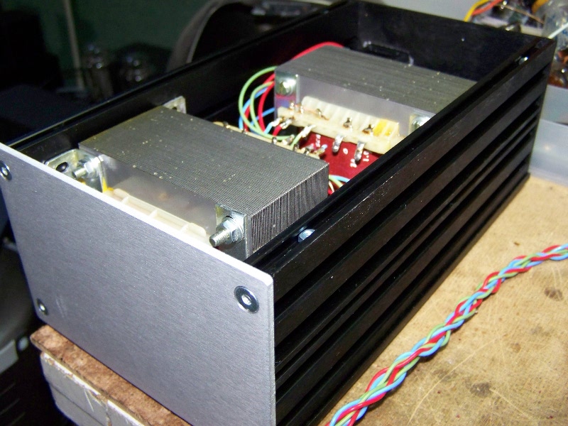

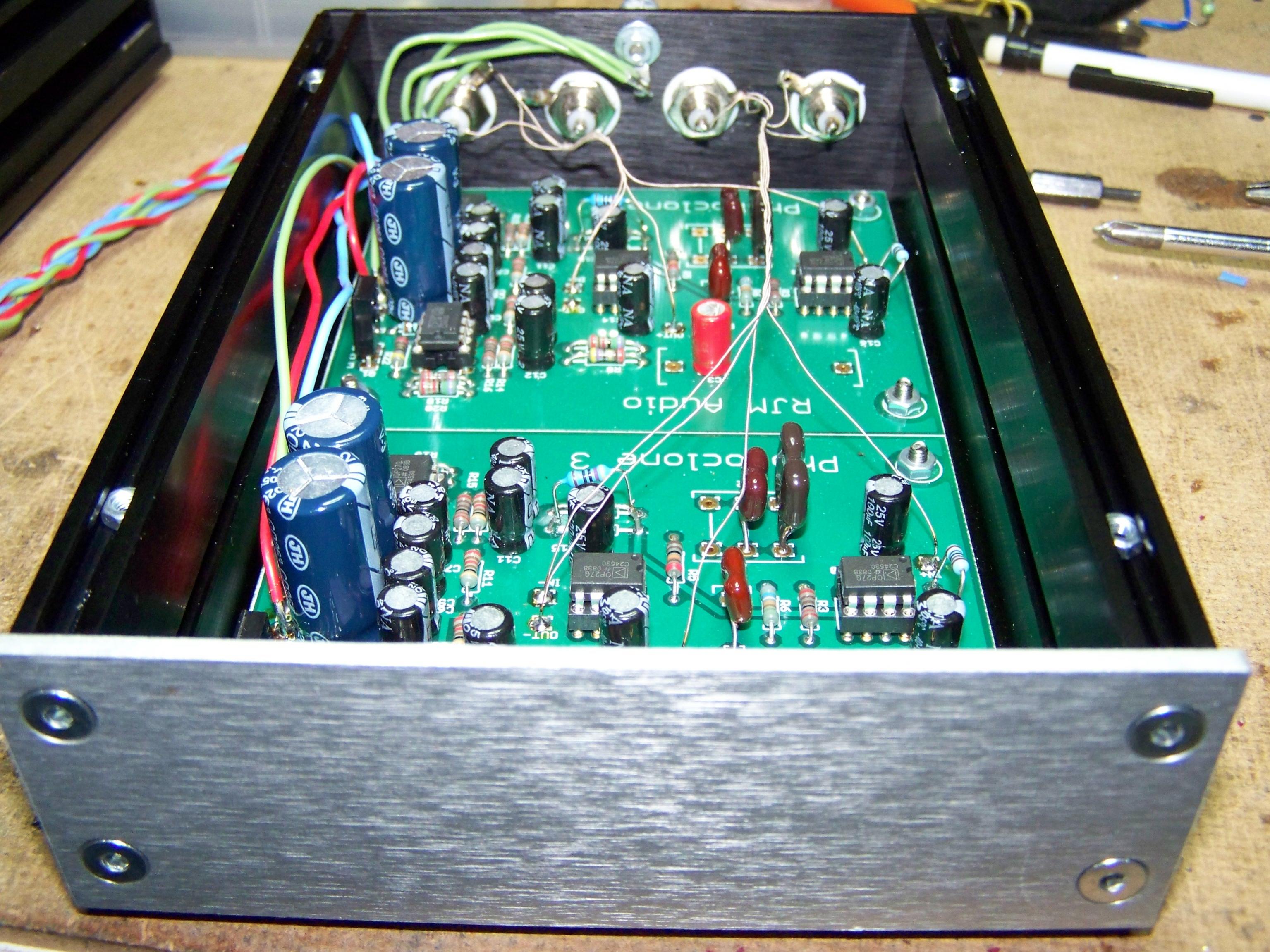

Hello,
Just finished building Phonoclone in its final enclosure. I use cabinets from hifi2000, powersupply and amp separated as advised. One of the smaller cabinets seem to be perfect in size for 2 pcb's Phonoclone, little bigger than the 2 pcb's.. 🙂
Powersupply consists of 2 oversized EI core transformers, diodes are BYV types.
Components of Phonoclone are all standard, no fancy audiophile parts (wouldn't fit anyway..). Sound is excellent! I use a Denon DL103 in a wooden body (Uwe body). R1 560ohms, R2=1K2.

Good thing you decided to keep those EI trannies well away from the phonoclone circuit in a separate enclosure. Could have been problems otherwise.

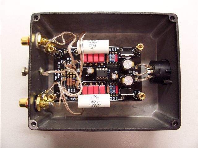

Interesting arrangement of the lead wires. Not necessarily a brilliant idea to have the inputs and output wrapped around each other like that, as the strong output signal gets fed back into the inputs via capacitive coupling.
Those 1.5Amp EI transformers give sonically the same results as 5.58Amp toroids.. 🙂
Thanks for pointing out the lead wires. Actually they are not really twisted, just grouped together... but I will separate them..

Glad to hear that. Thanks for posting the photos. Maybe the case is a tad small, but it's a nice job nonetheless.
