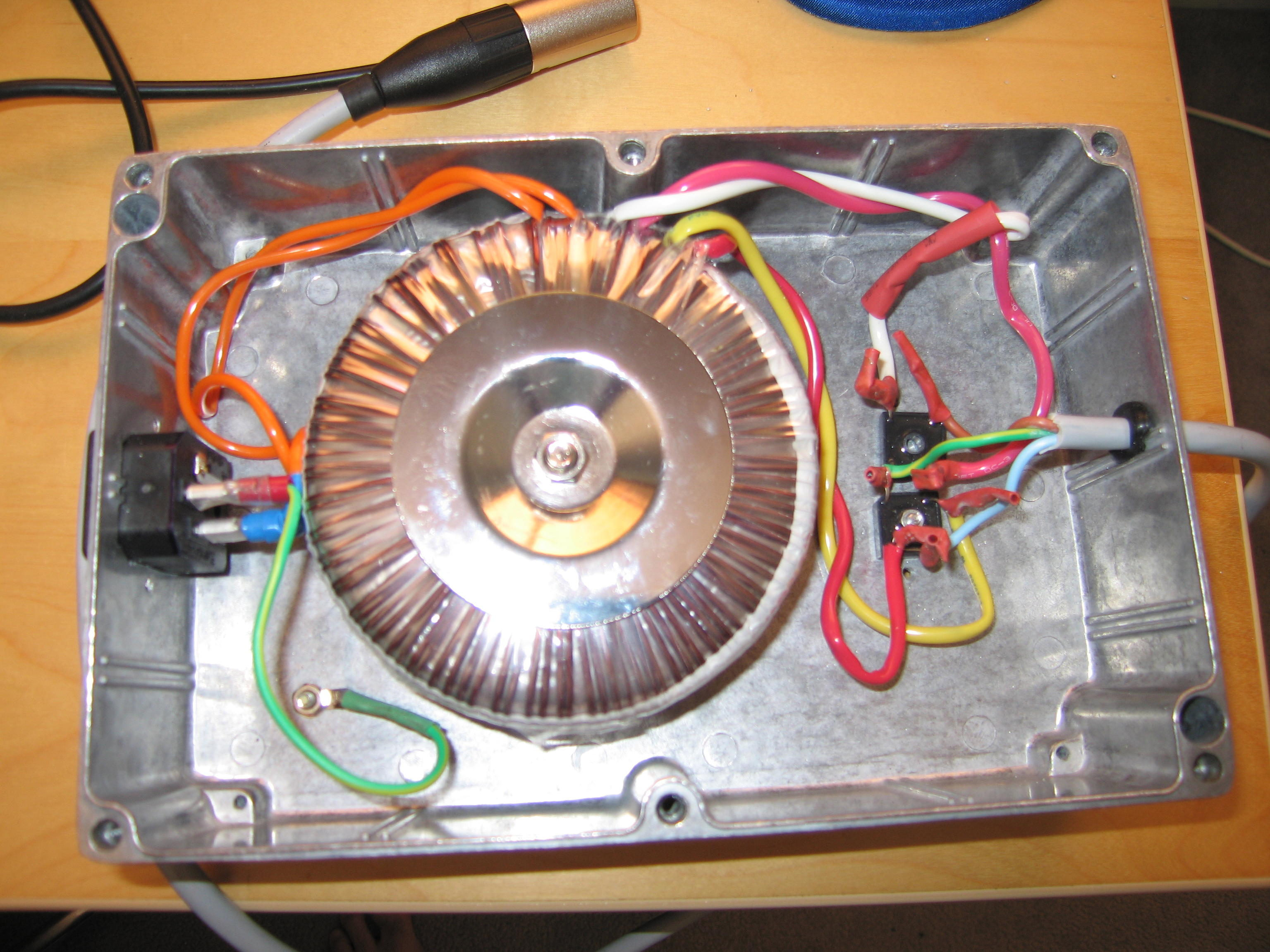

Hi guys, question re PSU for phonoclone-
i 've built one using 100VA 2+12VAC toroid-
the measured Voltage after rectifier is 11.5. Is there a problem? I thought it is a bit low.-was kind of expecting 18 or so.
recheck again-fuse blown-must be short somewhere.

here is a picture.

you have forgotten to fit smoothing capacitors.
You have full wave rectified AC at the output.
Your meter is reading correctly.
