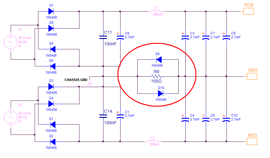

Oh right, the power supply. A lot of people will be happy to see this I think:
Power switch and LED completely optional. Power transformer can be larger if desired. Diodes can be bigger and badder if desired. This power supply will work with all versions of the VSPS and Phonoclone, and pretty much anything else you care to build with op amps. Two recitfiers? Why not. I think this configuration sounds better.

last diagram.
Add a Disconnecting Network or direct link between the Zero volts output line and the chassis.
Add a 20V Zener between the LED and the 2k2 to reduce the LED current to ~6mA.
With only the 2k2 the LED passes ~15mA.

Andrew:
Good point about the diode current, I estimated the current incorrectly. But couldn't I just increase the resistor to 7.5-10k?
What is a "disconnecting network"? Is that the 50ohms||small cap thingy to decouple COM from earth? The power supply chassis has always been disconnected from COM, and it's worked out fine... what am I missing here?

rjm said:... what am I missing here?
Safety.
The disconnect is a low value resistor bypassed with opposed diodes to continue the safety earth connection through the circuit, yet provide some isolation to avoid ground loops.
the advantage of using the Zener is that LED brightness falls off quickly as voltage across the supply lines falls and the LED is completely off when one supply line fails.
Using a larger resistor without a Zener gives a very gradual reduction in LED brightness as the voltage falls, so gradual it might not be noticed that a rail has a short on it or has switched off.
The Zener voltage is not critical, any value can be used. The closer the Zener value to the total supply rail voltage, the quicker the LED switches off.

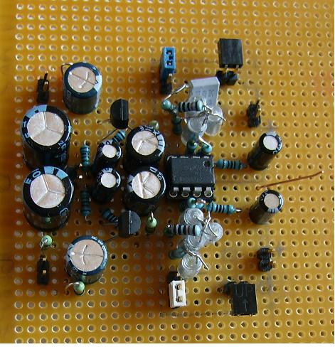

VSPS
(rebuild. no2)
LM4562
PSU:
14+-vdc -> 9.75V with the LM3xx
RCRC-LM3xx-RC filter
10R-220uF-10R-330uf-LM3xx-10R-100uF
(Do to SPICE this combo would give -200db pssr ?)
Decouple with a 100nf X7R ceramic.
IGNORE:
The 2.2nf grey cap and the polarized caps on the outputs.
Testing
Touching ground pin, chassi, rca contact at the same time = no hum only silent noise.
Groundloop...I guess.
(rebuild. no2)
LM4562
PSU:
IGNORE:
Testing
