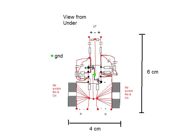

Hey.
Some problems here.
I got some heavy noise, hum and RF interference of all kind.
with the Input shorted, and I measured 50mV and 230mV at the output (no dcblock cap)
I tried to put a 220pf at the inputs. A success to kill all kind of noise, hum, RF interference. Actually I had to recheck that the VSPS was power on, twice, it was deadsilent.
But everything has its price. Now the dc at the out put is 1822mV at both channels.
I havent hooked it up with any turntables yet.
I guess te PCB routing is a mess to cause all that interfernce I got before ?"?"

Hey Thzar,
Please back up a step and tell us what you have: VSPS/Phonoclone, what PCB, what version.
It would appear from what you wrote that the opamp is oscillating due to a severe ground loop problem.

Hello all,
I have just finished building VSPS. Since I wait to receive the power transformer, I decided to use a couple of 12V batteries for a first test connecting them on the terminals of the filter capacitors after the regulators. VSPS is working but humming is much louder than output signal... 🙁 Turntable is grounded onto the VSPS board(which I got from skycoral.com). Any ideas guys?
Finally, I found the reason for humming.
I was running 2 cables per input or output, from the board to the RCA plugs, therefore some ground loops may have been there. Star-grounding inputs and outputs with the PCB ground made the VSPS dead quiet.
