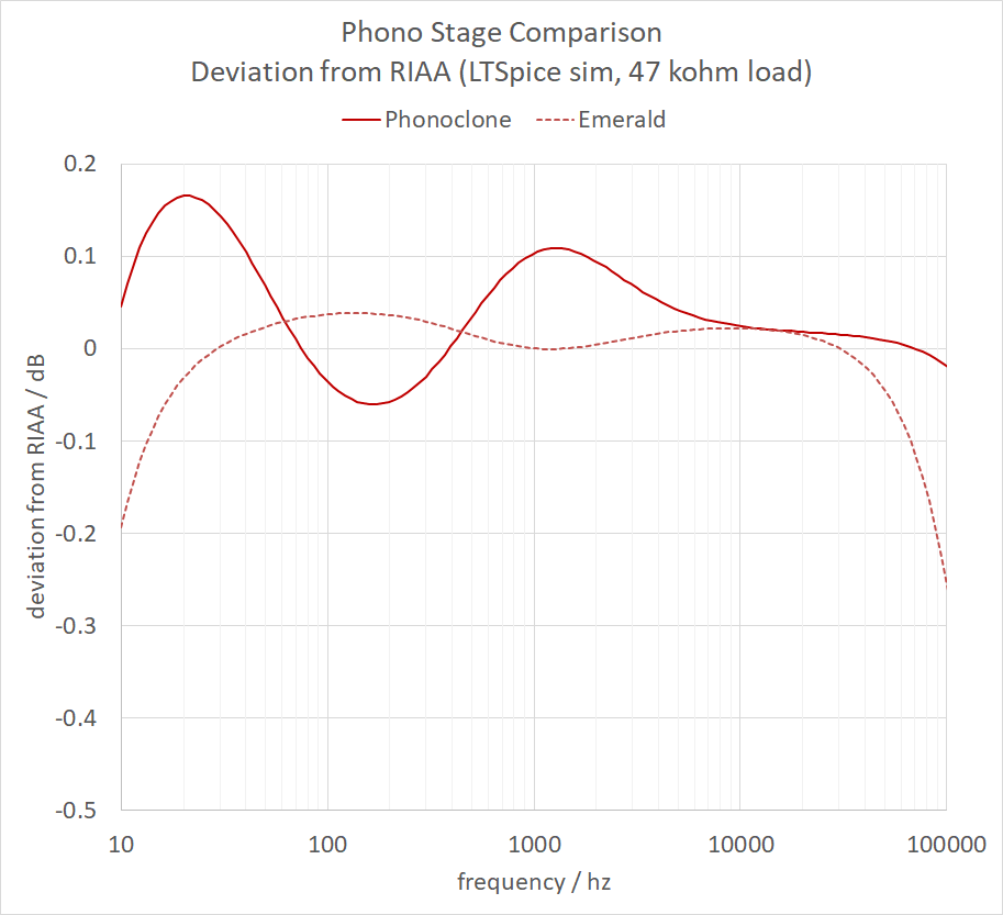

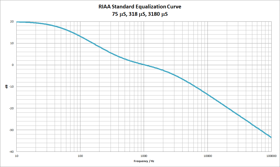

The circuits have different RIAA errors. The expected difference in frequency response is shown in the attached plot. The Emerald has a much flatter response, the Phonoclone something of a midrange and bass bump.
Nothing of the above would be expected to make a huge difference, but then again no huge difference was heard so anything and everything remains on the table.

As for the graph, what inverse RIAA circle do you use for the simulation in LTSpice ?.
I don't use an inverse RIAA, I compare the simulation output directly to the reference response.

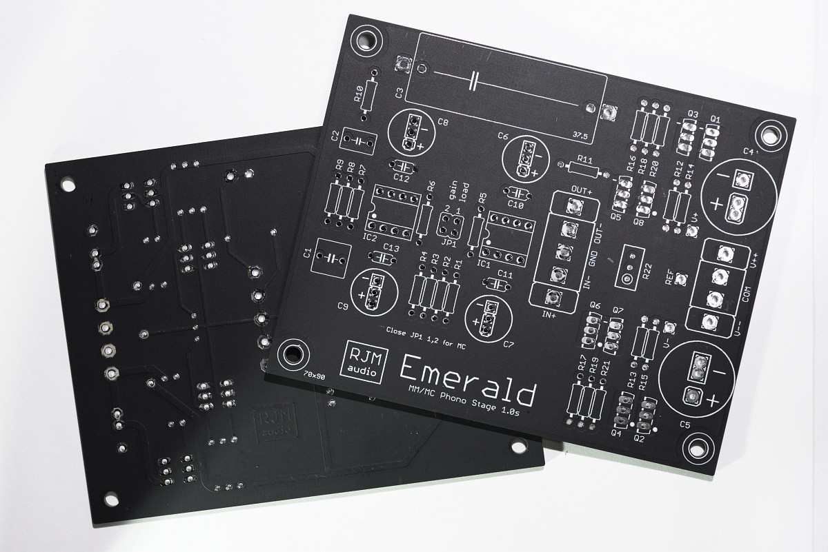

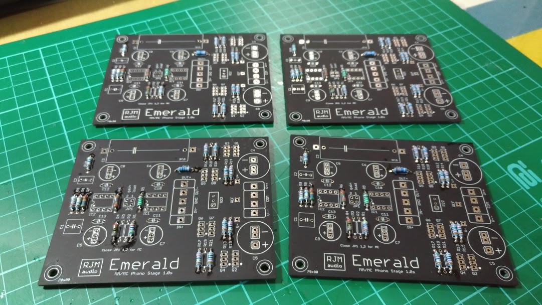

--photos of boards--
Emerald preorders will ship today.

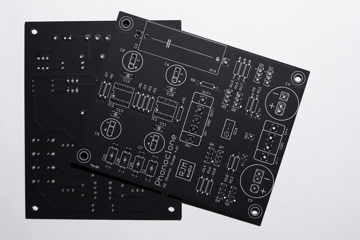

[Yes, I managed to miss the "phonoc stage" typo on the Phonoclone boards in proof. Laugh it up, fuzzball.]

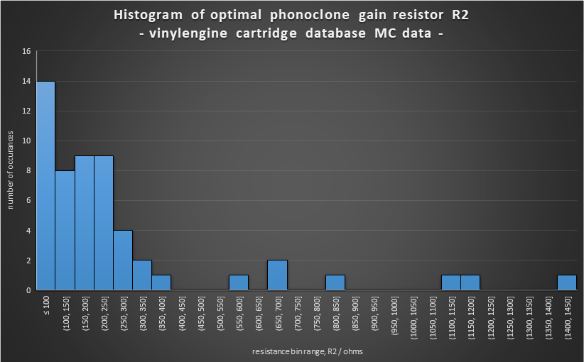

I grabbed all the available cartridge data on the vinylengine database and had a look in excel to see what the statistics looked like.
The answer I got surprised me: the Denon DL-103 is NOT a typical MC cartridge. If you rank them by current output, the DL103 and many other Denon models are outliers, with about 4x less current than is typical.
The median voltage sensitivity is 0.4 V, with the median DC resistance of 11 ohms. The median current output is 33 microamps, compared with just 7 microamps for the DL103. Current output directly determines the size of the phonoclone R2 value.
In terms of the optimal value of R2 then, as the histogram shows most cartridges fall between 100 and 300 ohms, with about an equal number above and below that range. The most typical value of R2 would therefore be about 221 ohms.
You would typically want to operate the phonoclone with a value of R2 less than a factor of two from the ideal value for the cartridge used.

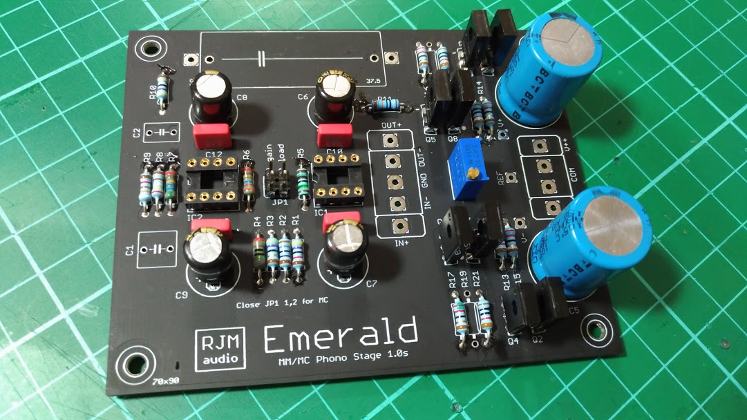

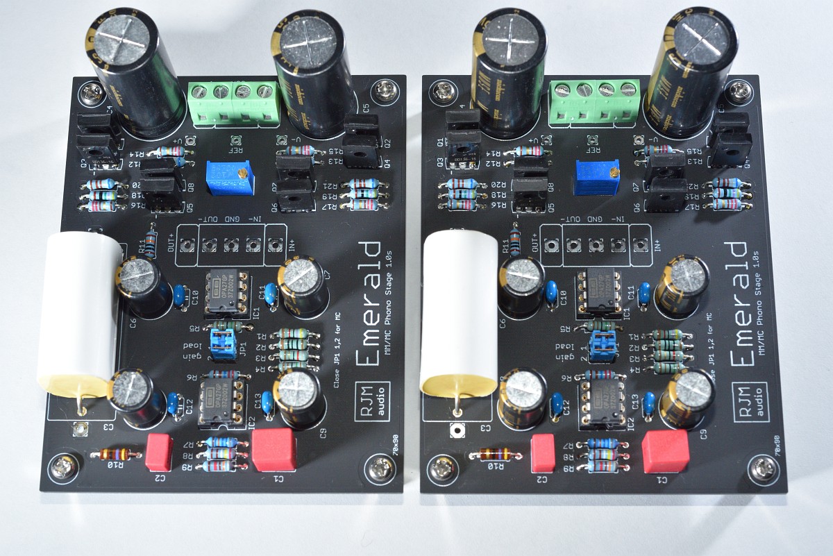

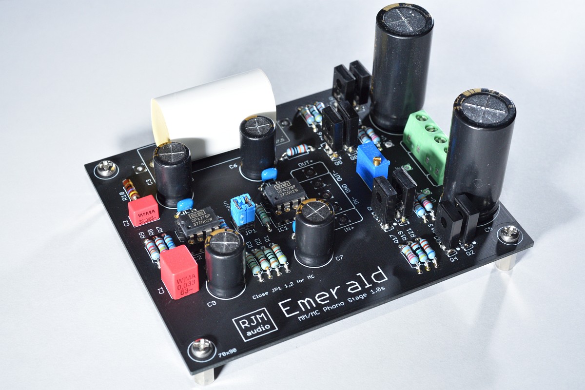

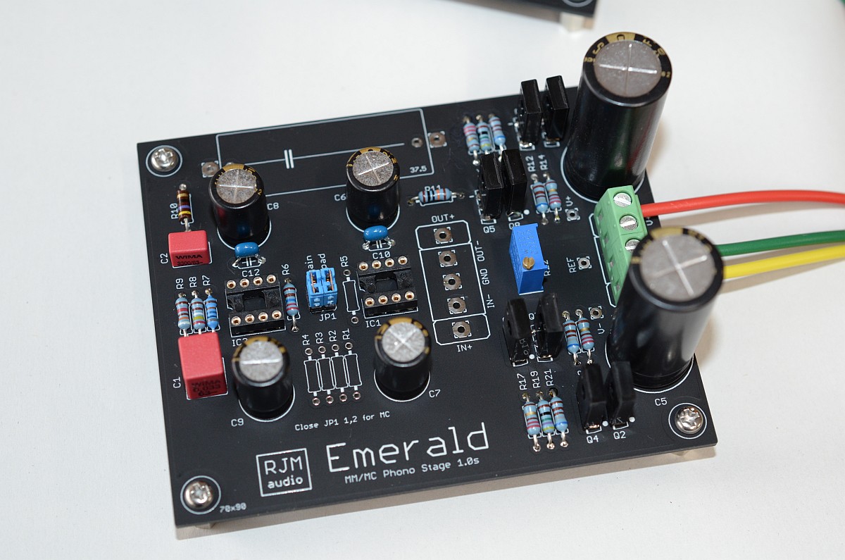

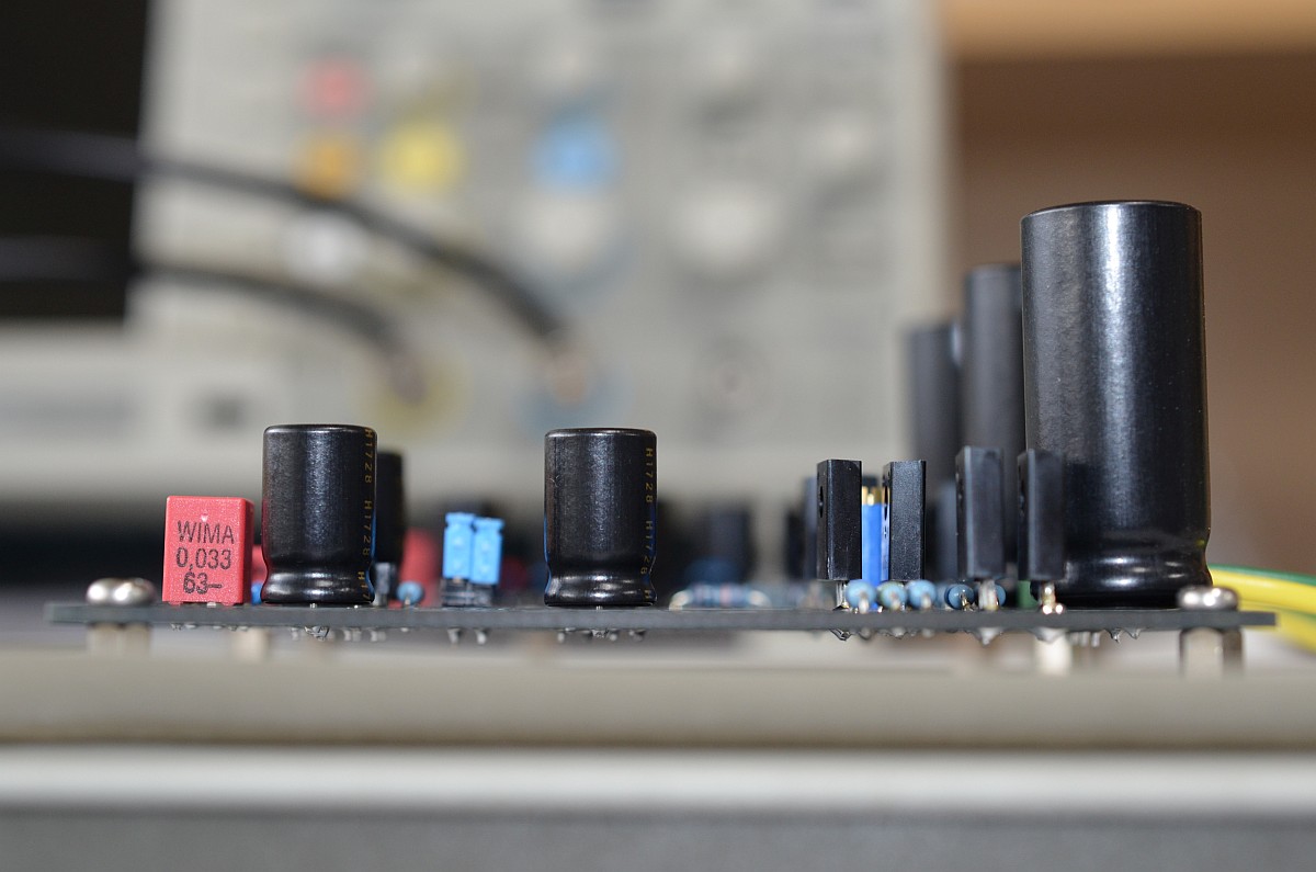

Photo of my Emerald 1.0s personal build. The S-Reg runs independently of the phono stage, so even without the opamps, coupling cap, and input resistors installed the board can be powered up, run in, and tested.
The 1000/25 Muse KZ caps are pretty big, with 10 mm standoffs the total height runs to about 48 mm. If this ends up too big for your case, you can always go with the 1000/25 FG which are about 10 mm shorter - or the KW/FW series of course.

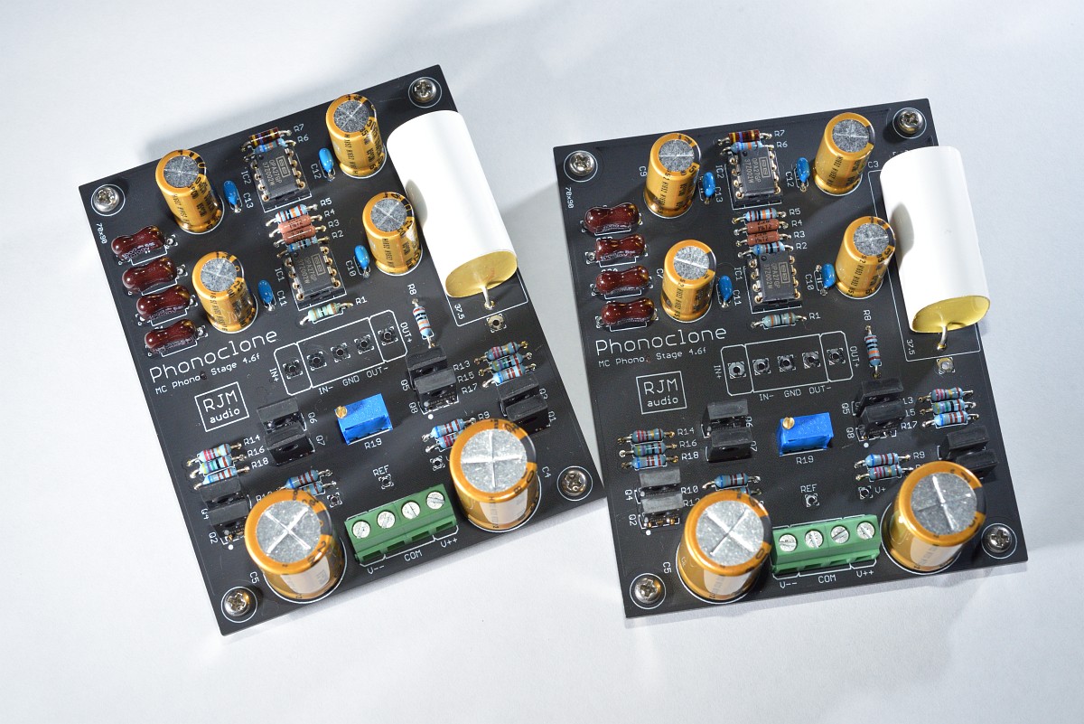

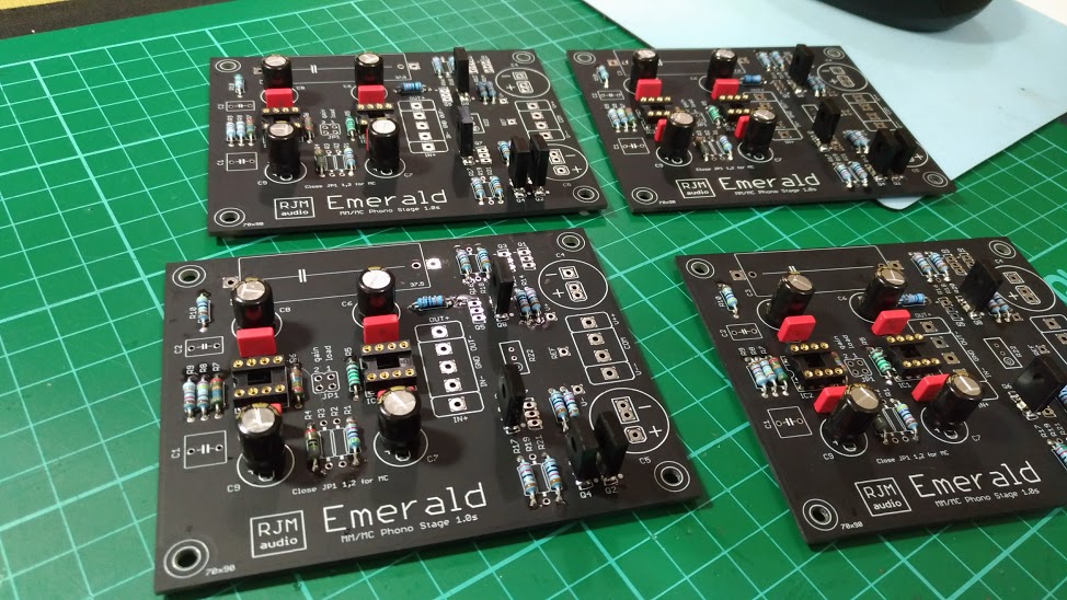

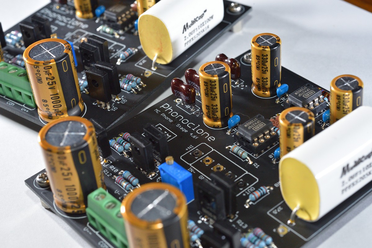

A few photos of the latest phono stage boards, assembled. Phonoclone 4.6f and Emerald 1.0s.
[photo nerd stuff: Nikon D750 | Ai Nikkor 55mm F2.8S | 2x SB-800, reflector]

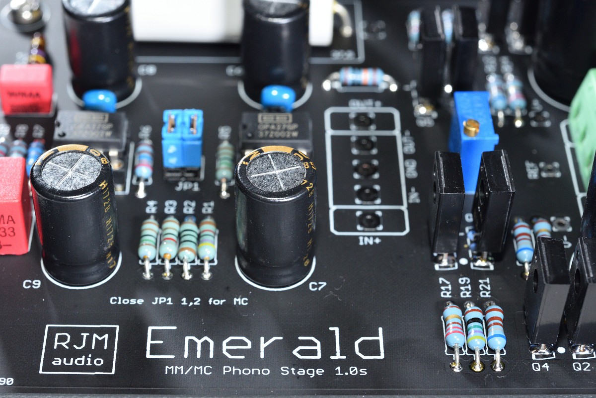

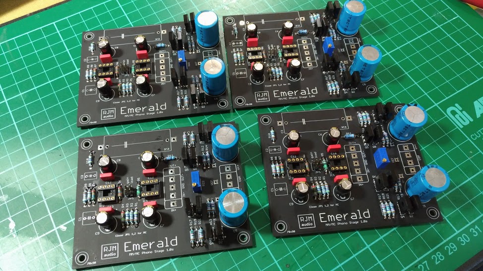

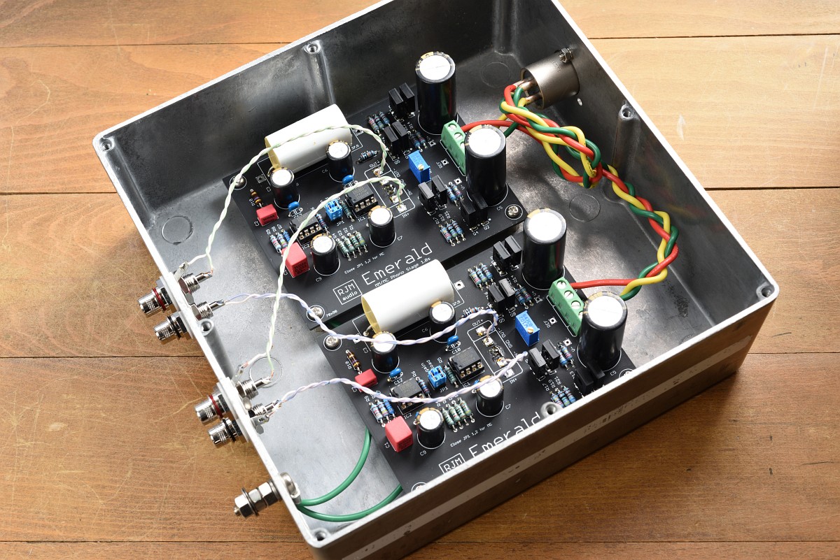

Working on my Emerald
I was expecting a "part II" ...
( I guess I got a head start as the case was already made! )
[Build details: as per the 10s9 BOM with Nichicon Muse KZ, Takman REY for R1-5, and Multicap PPFXS 2.0 uF 100 V for C3. RCA are Oyaide RJ-127HRh a relatively inexpensive rhodium plated part.]
