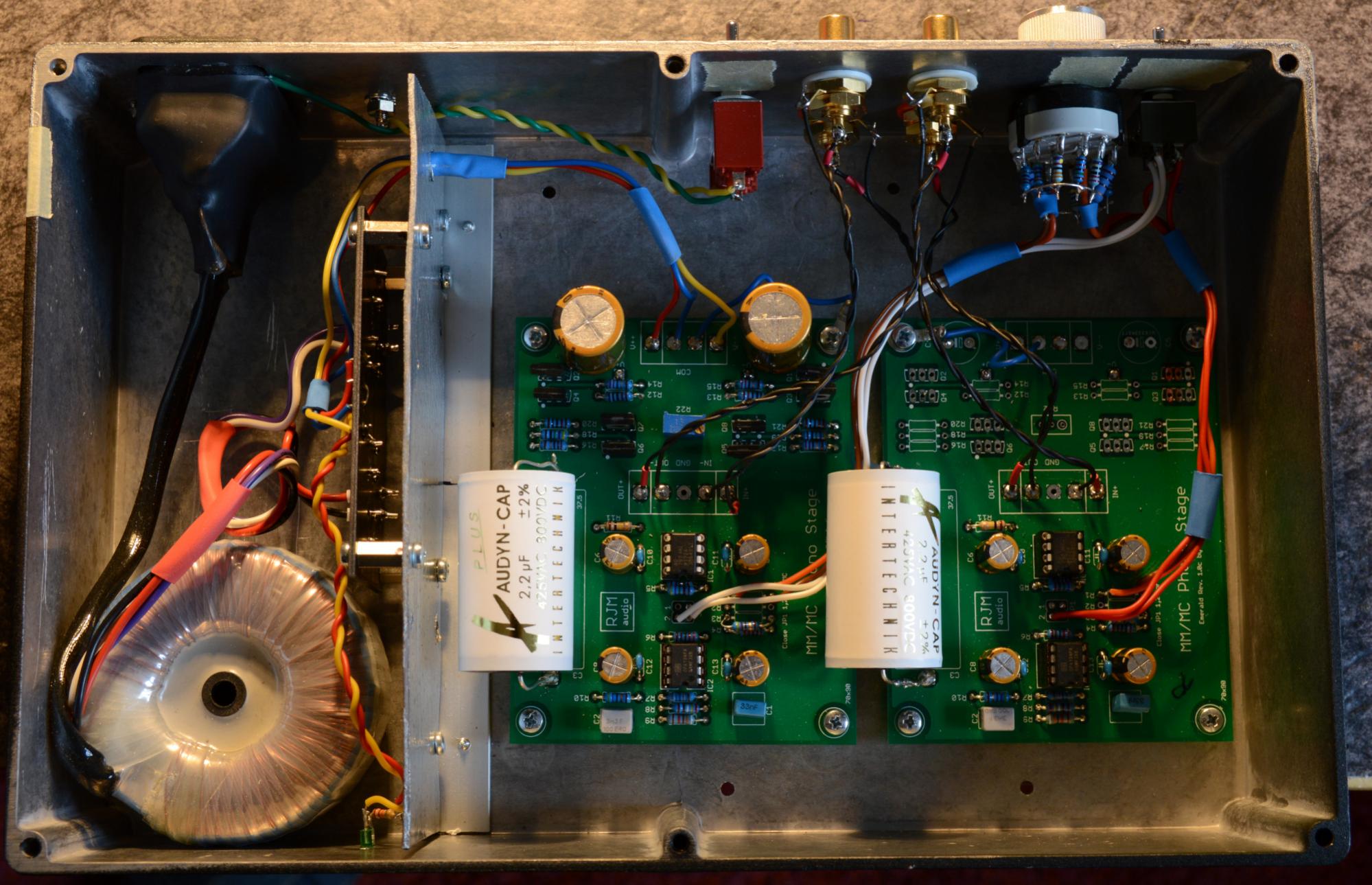

My Emerald build
I have completed an Emerald build using evaluation boards.
As can be seen from the photo the boards and complete power supply are housed in a single enclosure. The RJM rectifier board has been used and a coated lead sheet shields the amplifier from possible stray mains radiation.
I have used just one S-Reg supply to feed both boards - making it possible to easily adust the 2 V+ and 2 V- rails to within 0.1V of each other.
Nichicon FG bipolars are used throughout and the 4 opamps are all OPA27's
Switches for mm/mc and load R are located on the rear panel for convenience.
I have built several examples of all RJM phono amps with the exception of the mc only phonoclones and have to say, in my opinion, that the Emerald is easily the best sounding of the bunch!

Very good work. I'm glad you're happy with the sound. It makes me regret having bought the VSPS 400 boards (I have the VSPS 300 running). I would have bought these, but they came to light after the VSPS 400.
That configuration of separating the passive RIAA HF and active LF convinces me more.
But it's done.
What I find strange is that you have fed the two plates with the same source.
This does not influence the performance ?.
The other thing is that I do not see the screw of the turntable mass cable.
Regards and enjoy

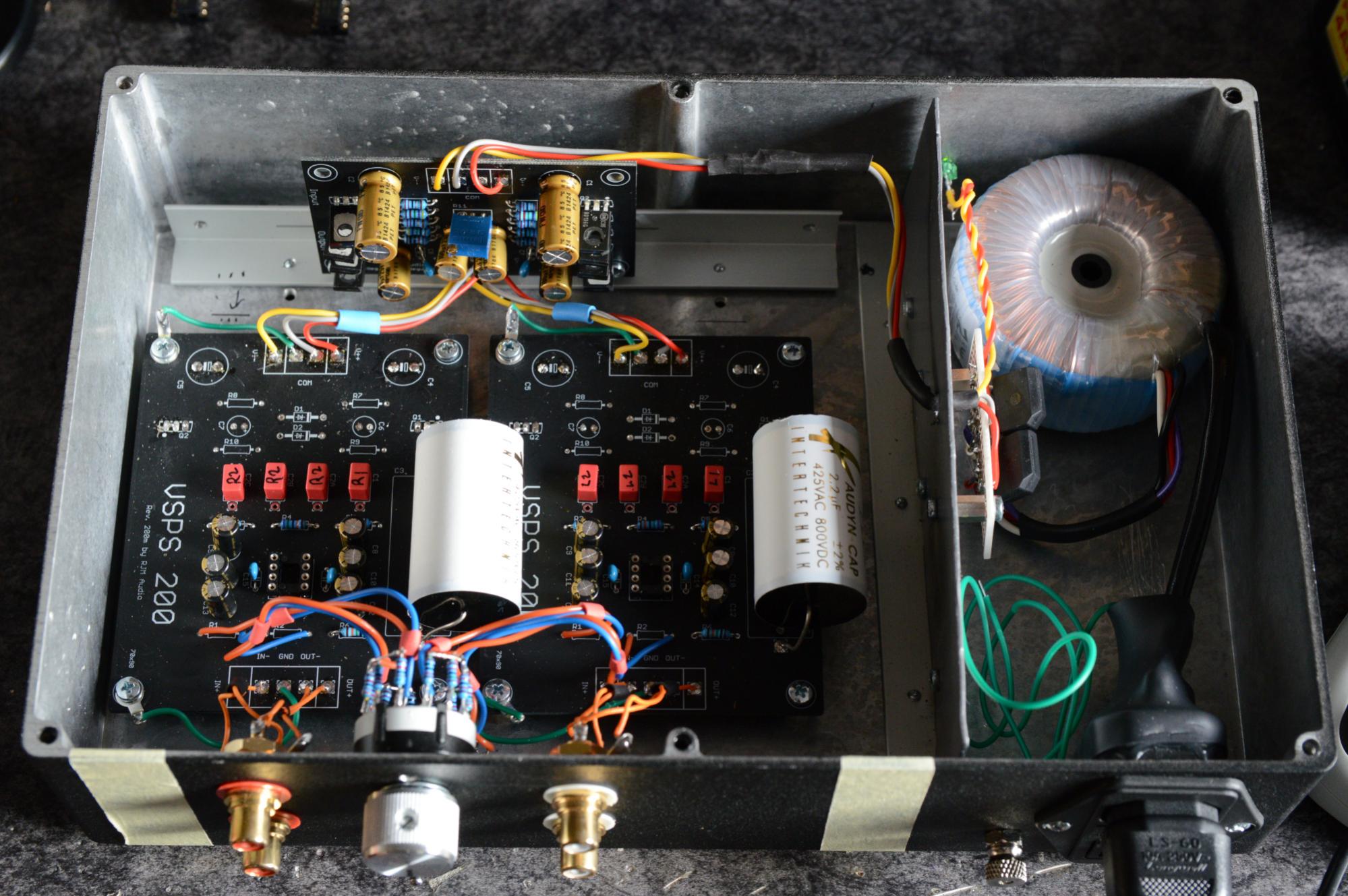

As I said with one S-Reg feeding two boards you can perfectly match all the rails. Maybe there is a theoretical reason (which I can't think of) for using two regulators but my configuration sounds just great to my ears.
On the photo you can see an experimental build using VSPS 200 boards fed by a single S-Reg. You can also see that I do use a ground lug. This is a simulation of the 400, if you like, and it sounds brilliant!
Pokerback47, it had not occurred to me to do this. I'm going to try to do it, but by sharing the s-reg, each plate has half the capacitance.
Anyway, if you say it sounds good, I'll do it.

The major advantage of the Emerald is obviously its mc functionality. The VSPS 400 comes very close to the Emerald with mm carts. Maybe the Emerald just about shades it but I don't really know because I haven't compared them with identical OpAmps.
Yes you spotted the green wire from the mains earth connector. Its not shown but the connection to the chassis ground lug was later made defeatable with a toggle switch. My reason for doing this was to provide a safety earth path when using vintage non-earthed turntables. No problems with an earth loop in my system either way. Good luck and have fun!
Take another look at my emerald photo. The red toggle switch at the back makes or defeats the connection mains earth to ground.....I see strange the way you connect the GND. It is in the power input and in the audio input-output. On both sides you connect to the chassis.

I was referring to what is marked with red. RJM recommends connecting the GND of the plates to the GND screw where the mass cable of the turntable arrives, but I see that you have connected in 5 places.
Jose is right: you've actually connected the chassis to the circuit common multiple times on each board, once through the GND pad and once through the COM pad. These are already connected internally so only one of these needs to connect to the chassis. Normally that's the GND of each board, but it doesn't matter you could use COM if you want. I don't recommend both but I doubt it makes much difference.
It also doesn't matter if the connection to the chassis is made locally at the standoff or pulled together at the TT earth stud. By habit I've always use the earth stud.
With these builds with built in power supply the chassis is normally also connected to earth. This can cause problems since the audio returns (IN-, OUT-) are now connected to earth in the phono stage, and they are also going to be likely connected to earth in the preamp and amp as well. Potential for ground loops. A switch to defeat the earth is a solution, but probably puts you into conflict with safety codes. The real fix is to use a separate power supply so the phono stage chassis doesn't have to have a dedicated connection to earth, or, alternatively, lift the GND from the chassis/earth using a humbuster. (the latter I haven't tried by the way)
