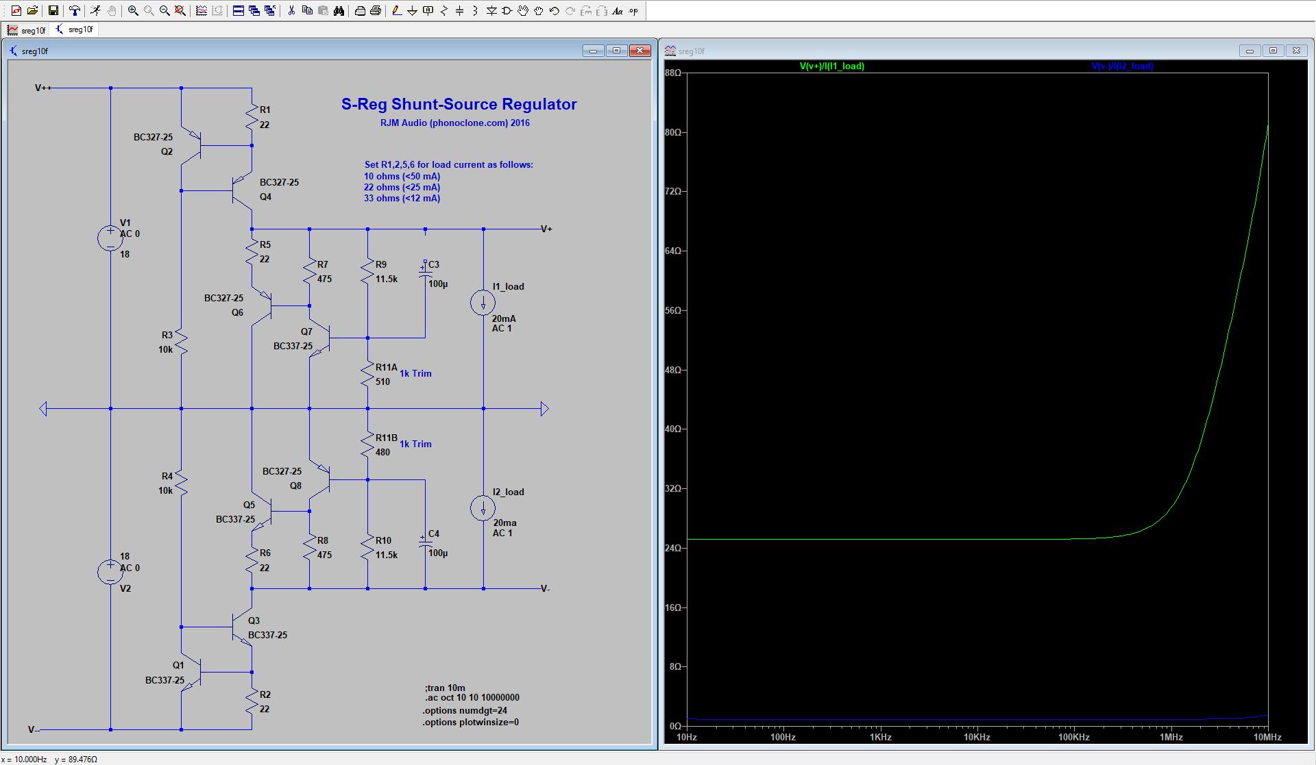

The S-Reg originally had capacitors C3,C4 which essentially lowered the output impedance (and the output ripple) by increasing the feedback.
These capacitors are removed in all the currently shipping boards. The original S-Reg board had them though, as did the CrystalFET.
The output impedance with the caps connected is about 1-2 ohms. Without, it's about 20-25 ohms.
If anyone is interested in the experiment, it is a simple matter to connect a 10-100 uF capacitor across the 10 k resistors (R9,10 in the schematic below, shown as 11.5k) and see if you hear any improvement or loss.
Btw the capacitors were removed for the following reasons,
1. Additional ripple rejection was not needed.
2. Additional feedback did not sit well with me as something you want to connect to an opamp which is already loaded up to the gills with negative feedback.
3. The capacitance could stress the transistors Q7,8 on start up by putting a large voltage across the base-emitter terminals.
4. It seemed to make no difference either way and I needed the board real estate.

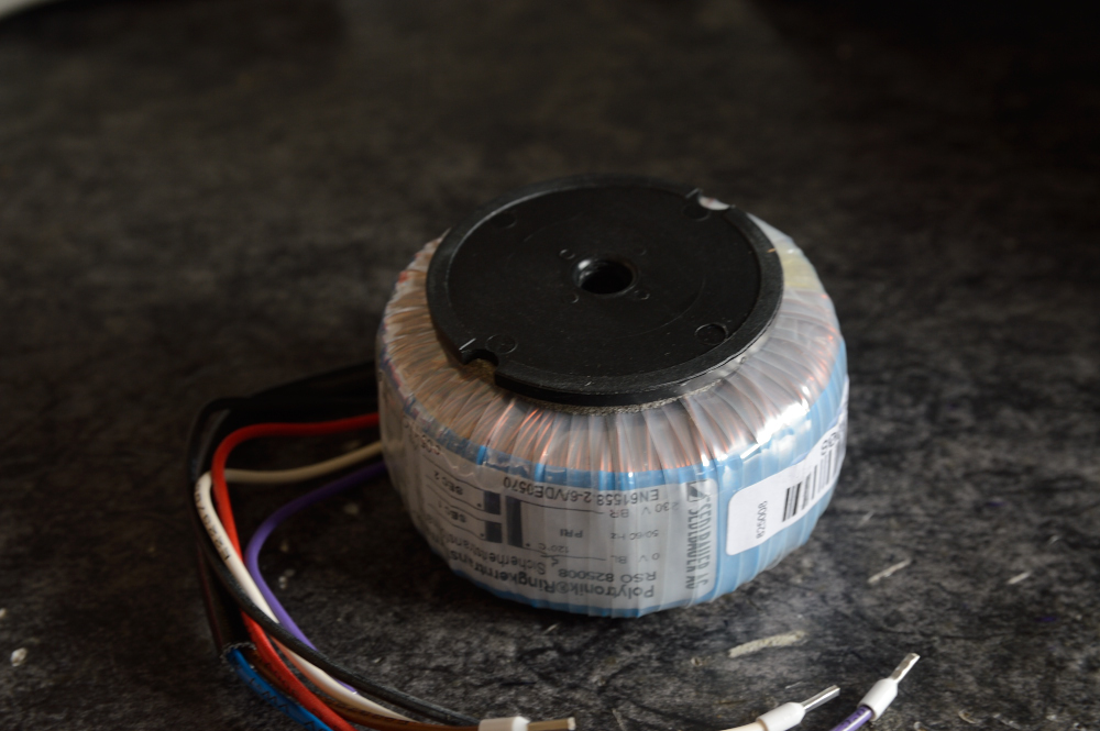

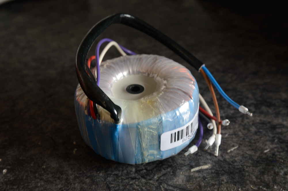

The Class II requirement for the mains current bearing circuit for a transformer based PS can be summarized thus
The mains carrying leads and IEC socket connector pins are doubly insulated and the primary winding of the transformer is isolated from the chassis (and secondary windings!) by at least 2 layers of insulation.
Toroidal transformers provide typically 4 levels of insulation between the primary and secondary windings and between primary winding and chassis
1. the insulation coating of the primary winding wire
2. the insulation wrap of the primary winding
3. the insulation wrap of the secondary windings
4. the insulation coating of the secondary winding wire
The ones I use have an additional insulation level with respect to the chassis in that the transformer is mounted on a plastic foot with the space between the plastic fixation column and outer insulation wrap being filled with some sort of non conducting resin.
It's always a good idea to use a good quality transformer with sturdy insulation wraps. Not only for safety reasons but they sound better too!

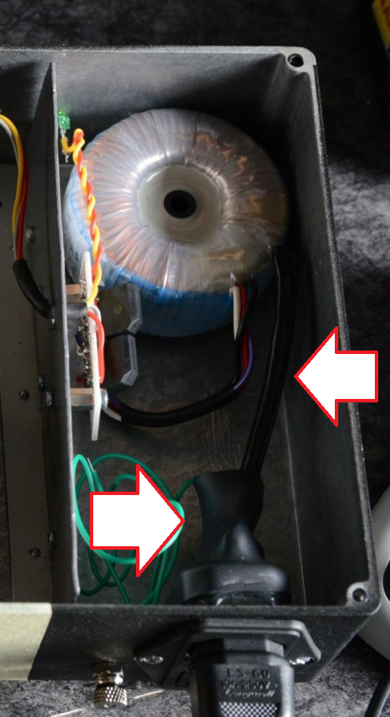

Re the whole class II thing, I notice (see attached) that the internal power wire to the transformer is made up of regular extension cord, so that's ok, and the IEC socket is all covered in heatshrink. Those are the only parts anyone making low voltage diy audio have to be really concerned about, as the transformer itself is certified by the manufacturer. If your build isn't formally "double insulated" it's close enough from an informal safety point of view. Officials may have a different opinion should you ever seek UL certification however.
FYI Air can also be one of the insulators.
Classes and types of medical electrical equipment
In practice, the basic insulation may be afforded by physical separation of live conductors from the equipment enclosure, so that the basic insulation material is air. The enclosure material then forms the supplementary insulation.

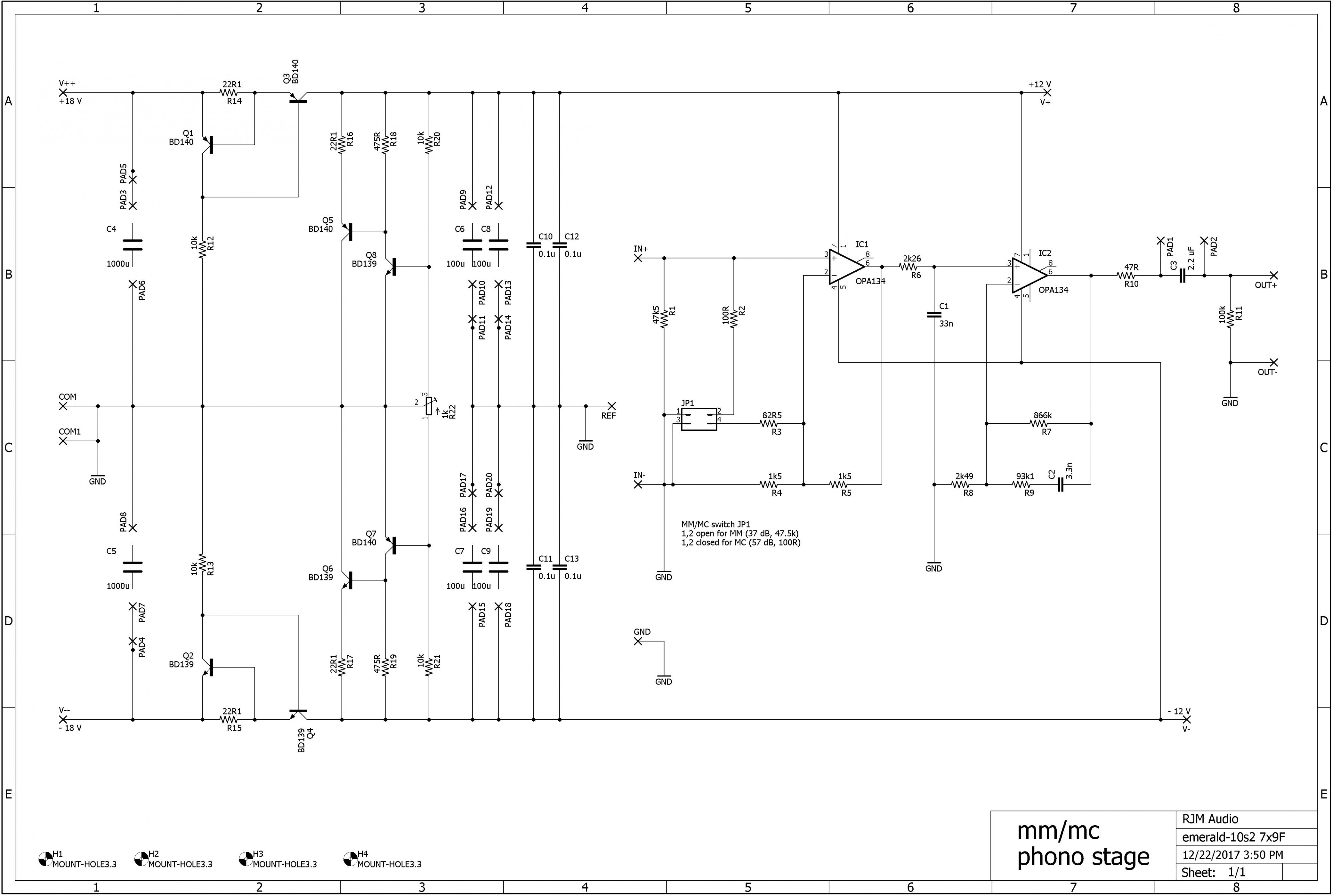

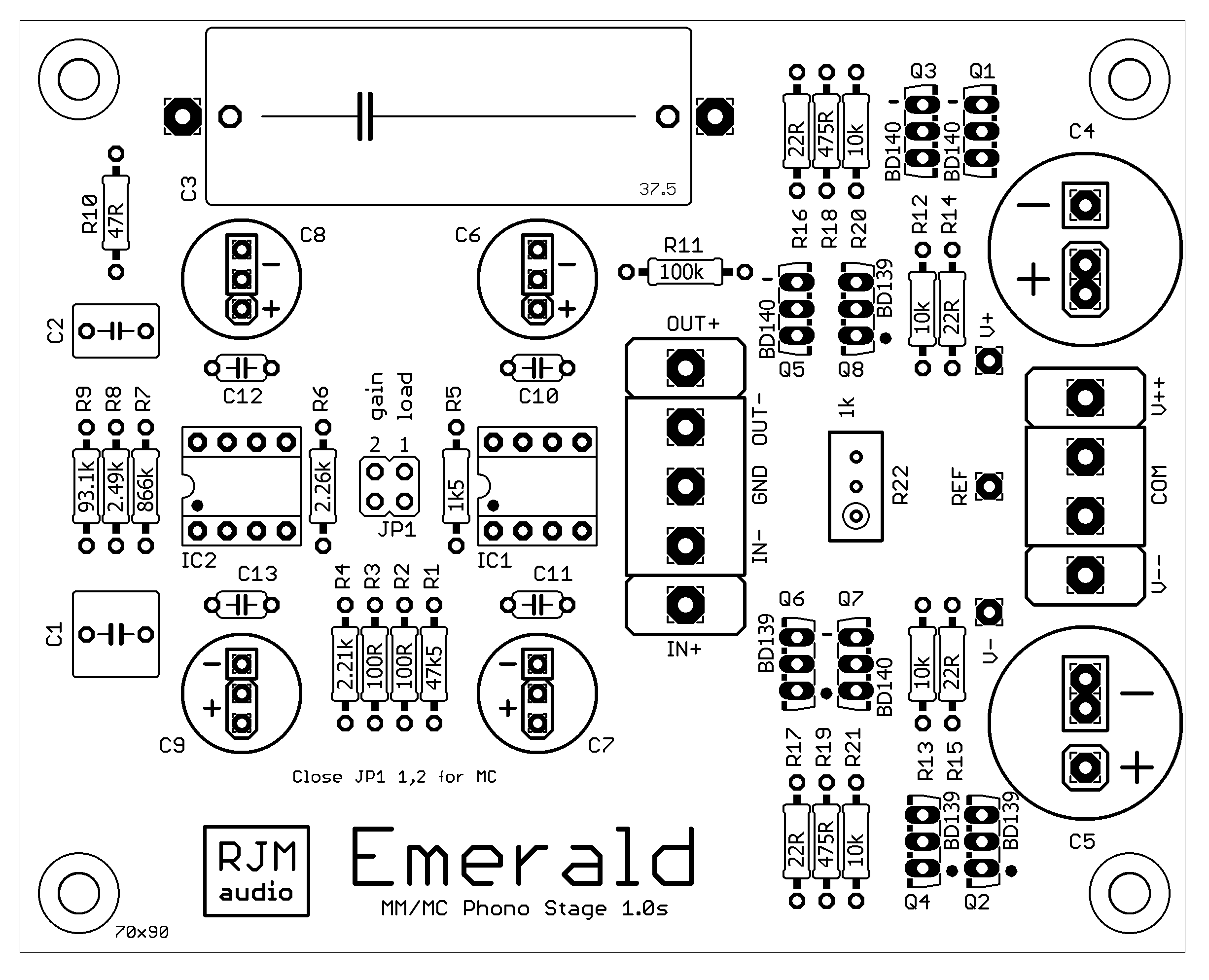

error in Emerald BOM
R8 and R9 were mislabeled in the BOM list on both the 10c and 10s worksheets. The schematics were always correct.
R8 = 2.49k
R9 = 93.1k
Revised files have been uploaded to the website. 10c6 and 10s9 or later BOMs are correct.
Sorry about that. I didn't follow my own numbering protocol on the Emerald schematic, but assumed I had when I copied the base BOM over from the Phonoclone originally. I'll try to send out the new BOM to everyone who I sold boards to.
R8 = 2.49k
R9 = 93.1k
