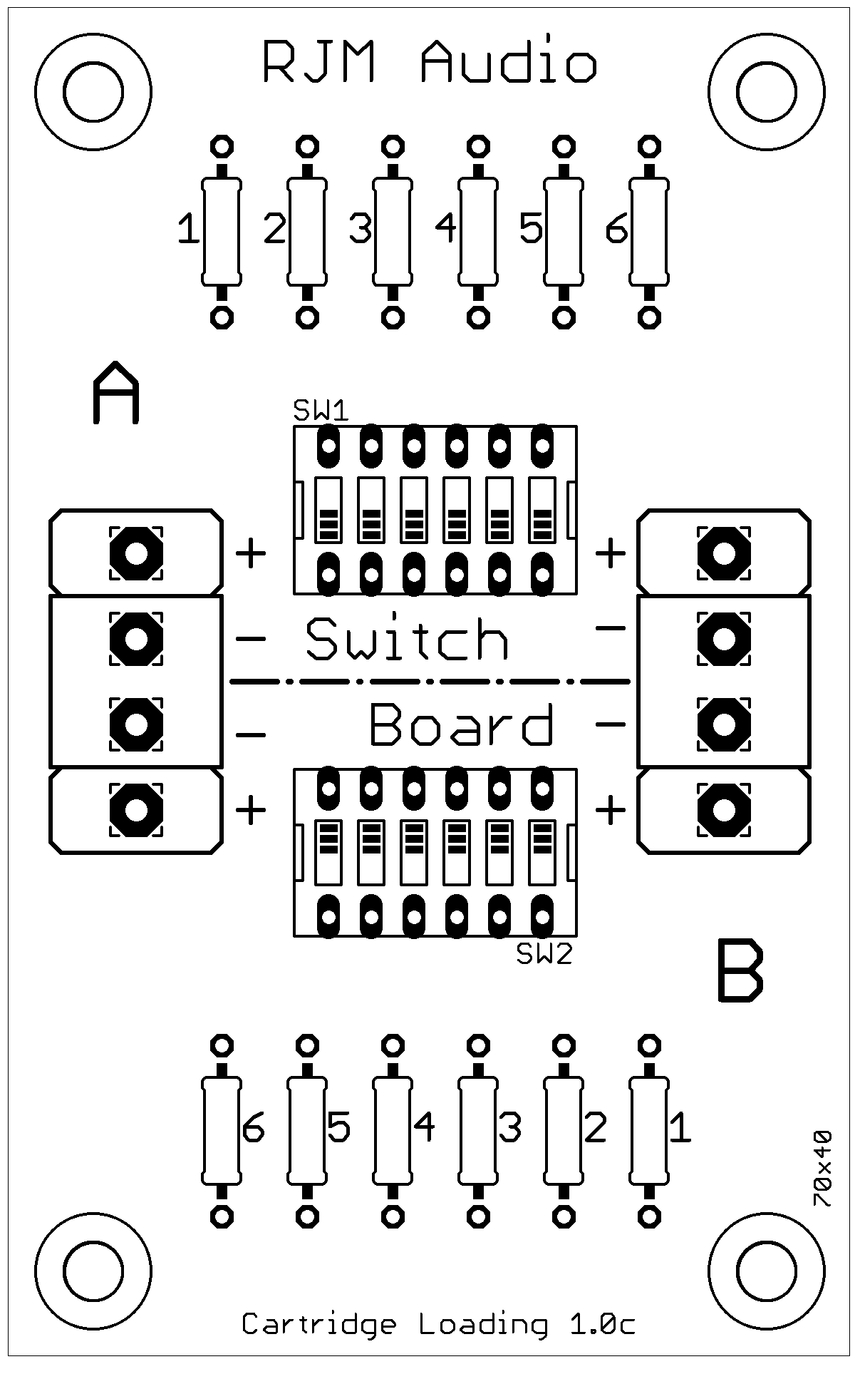

The VSPS has no cartridge loading options, and no default input capacitance, but both of these can be added using the Switchboard, shown below, which connects between the VSPS and the input.

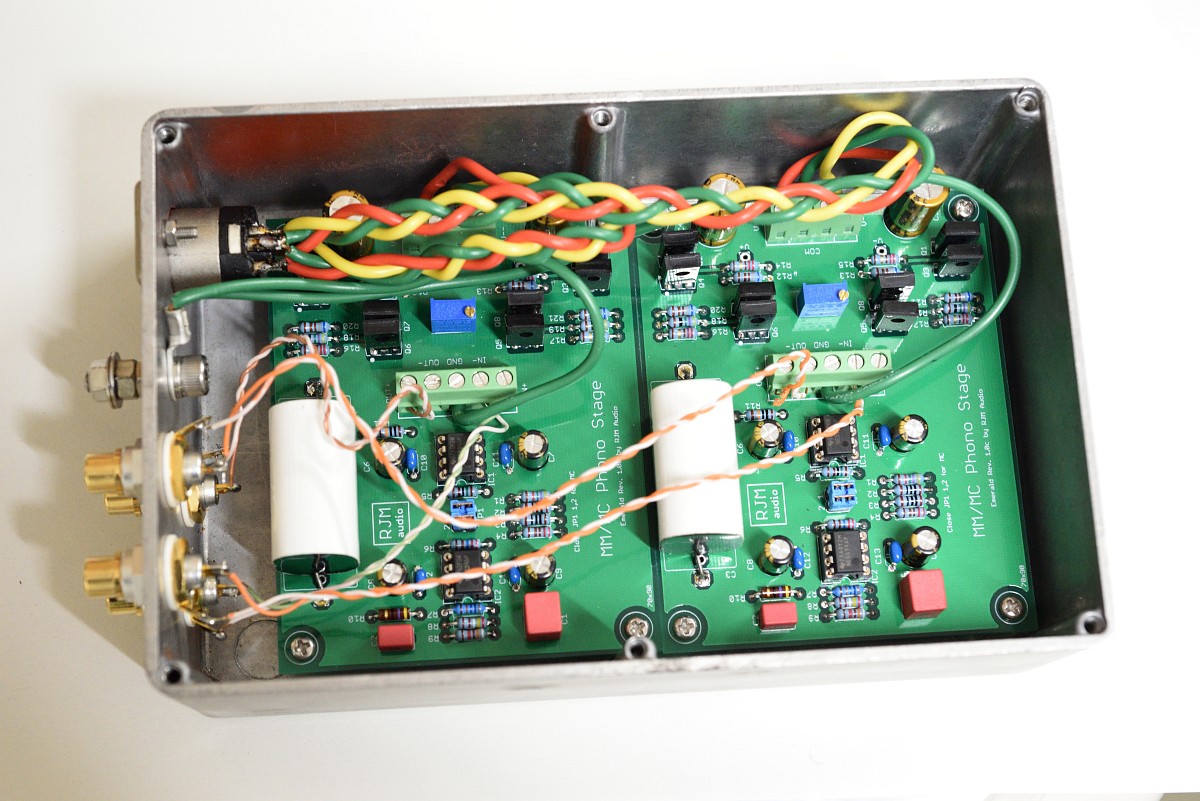

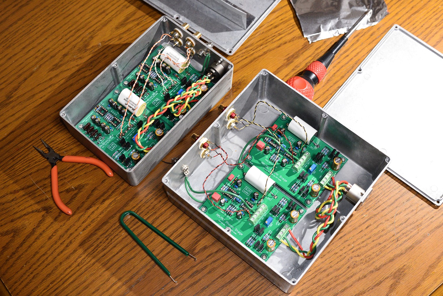

I built Emerald 10c (evaluation), as pictured. It replaces my Phonoclone 4.5.
Differences between previous phonoclone is NE5534A used instead of OP27, and 55 dB gain instead of 60 dB. S-Reg section is identical.
It works as advertised. I think it sounds rather better than the Phonoclone, but it is early days yet. Smoother, better sense of rhythm, more articulate and tuneful bass, greater and more realistic delineation of individual instruments. It's qualitatively similar to the PC4 however, the differences would be on the level where it might just be down to the change in op amps, something I will look at soon.

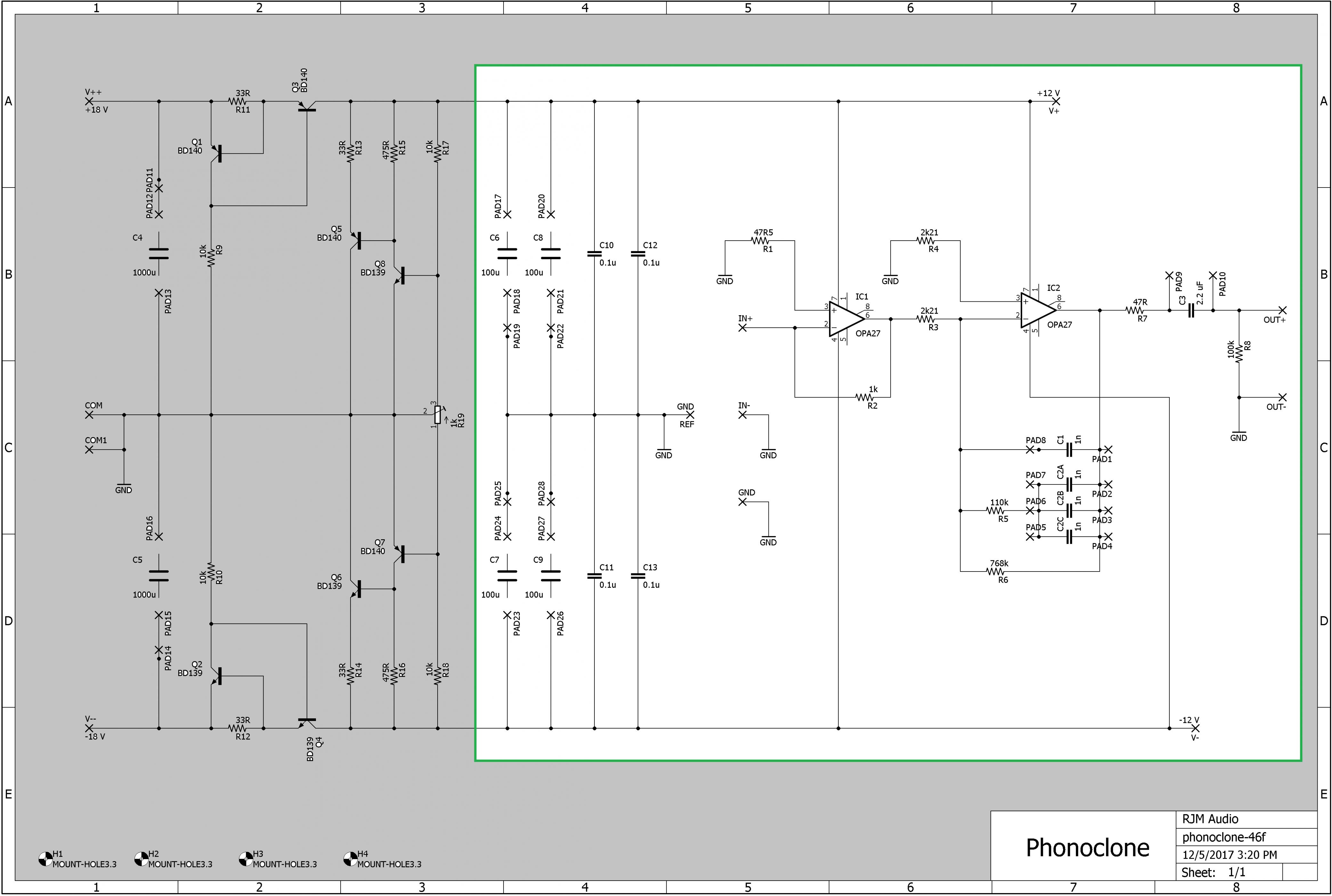

I have a confession to make. I've been calculating the phonoclone gain slightly wrong all these years.
Originally the claim by the 47 labs phonocube was that the zero ohm input impedance meant "all the current from the cartridge is amplified" but it never properly sunk it what that actually meant.
What it actually means is that in current source terms the cartridge is operating unloaded, instead of into 100 ohms as specified and as calibrated for. The cartridge sensitivity of 0.3 mV is given for the conditions of 100 ohms load. To calculate out the gain properly, the voltage source needs to be multiplied by ((Rload+Rsource)/Rload), or about 3 dB in the case of the Denon DL103.
The correction for many MC carts is going to be smaller.
