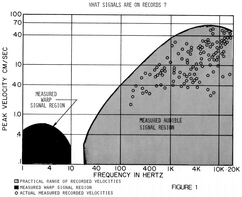

If you build phono stages, or even if you just play records, if you are into diyaudio this technical seminar from Shure is a must read.
Now armed with the knowledge that the maximum needle velocity is about 40 cm/s, let's go back and revisit, hopefully for the last time, the question of phono stage gain.
Nothing has really changed. The recommended gains are what they always were. What this will do however - let's hope - is give you a full appreciation for why the gains are set as they are.
Cartridge sensitivity is given as mV at 5 cm/s needle velocity. For simplicity let's make the absolute maximum needle velocity 50 cm/s, giving an even 20 dB difference between the rated output in mV and the maximum voltage that can come off the cartridge.
The design goal is that your phono stage should have enough headroom that even this maximum voltage does not result in clipping. To achieve this, either the voltage gain must be reduced, or the signal clipping voltage increased. The latter is obtained by increasing the voltage rails, or possibly moving to a high voltage circuit topology such as vacuum tubes.
Assuming your circuit can handle it without clipping, how do you figure out the the right gain to produce about the same output level as a CD player?
Well, what it is not is what most people here seem to figure it is, aka
gain (dB) = 20 log [ 1000 / cartridge sensitivity in mV ]
This gives 60 dB for 1 mV, and overestimates the gain needed by at least 10 dB.
It doesn't matter whether you estimate the line level as 0 dB, 3 dB, 2 V rms, 2 V p-p, these are all the wrong reference to use. A 1 mV sensitivity cart amped by 60 dB will not give you a signal the same level as your CD player, it will be much louder - and you will likely overload any op amp based phono stage while you are at it.
So what is the gain needed? Unfortunately it's not straightforward or obvious. If it was, people wouldn't get it so wrong all the time. The trick is solving the relationship between the 5 cm/s velocity reference and the -10 dB reference level for consumer line level audio. There is no direct link, it only depends on the conventions of the recording industry. To first approximation however, we can draw a 1:1 correspondence. So, a 5 cm/s 1 kHz sine wave pattern on an LP groove passed through a transducer and amplified to -10 dB should give the same level as a -10 dB 1 kHz sine wave recorded on a CD and played on a standard consumer CD player.
This gain should be regarded as the upper limit. There is no legitimate need to have the phono output level-matched to the CD output. If 6~10 dB lower gain gives better noise performance and better overhead protection, as it often does, then this is an advisable design decision to take.

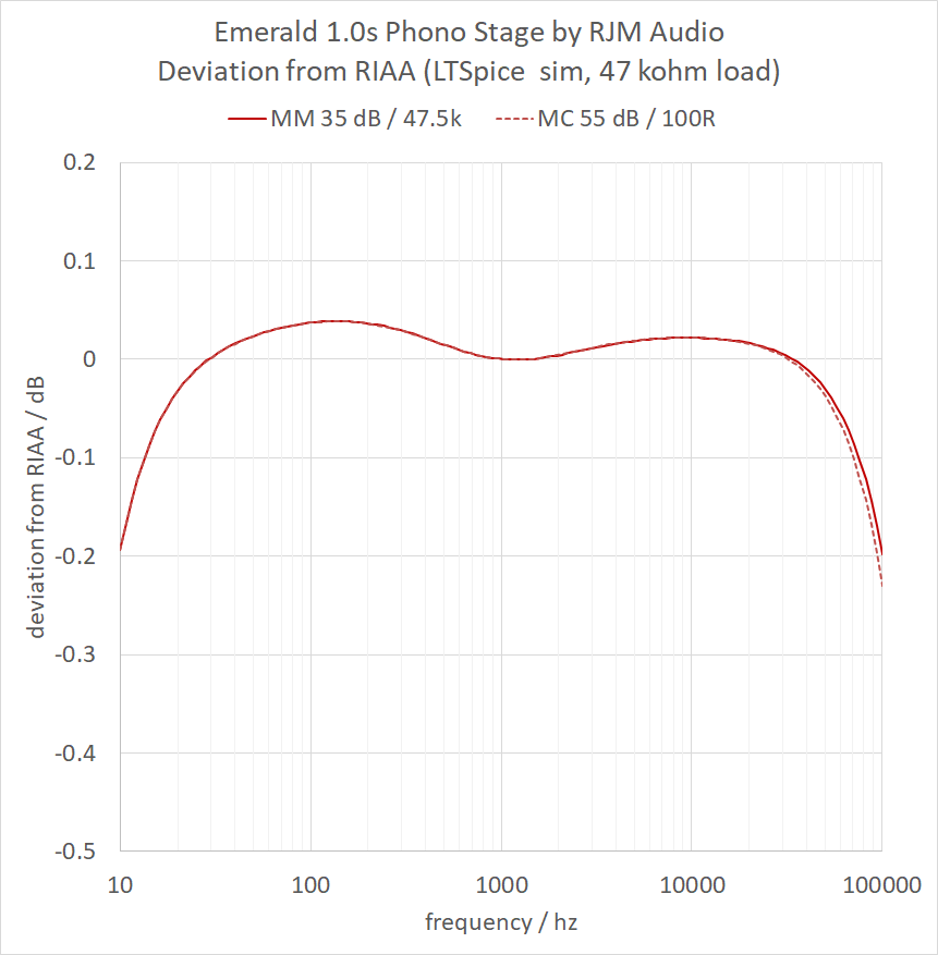

The Emerald can be configured for 35/55 with R3 = 100 ohms and R4 = 2210 ohms, both part of my standard toolbox resistor values.
As can be seen in the simulated response, lowering the MC gain brings the HF response back in line with the MM, and coupled with that is somewhat improved performance.
I may likely change the BOM to make those the default values.
