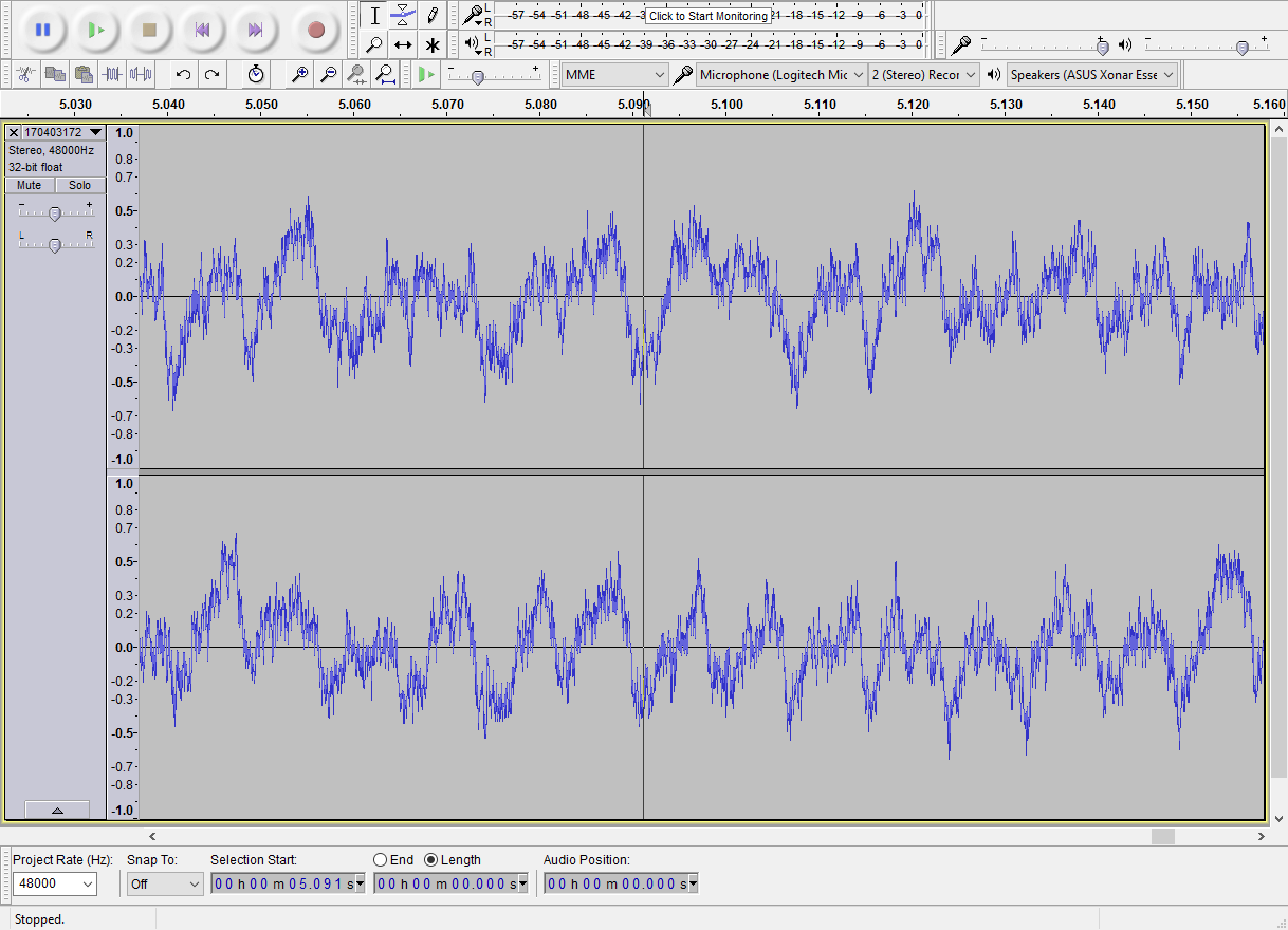

It is precisely that "out of phase central suckout" feeling...
I couldn't really believe it either, so I double checked, rather unscientifically I must admit: I did open the files in Audacity, and when mixing down the channels to mono, I got a much louder resulting mono file when inverting one of the channels...

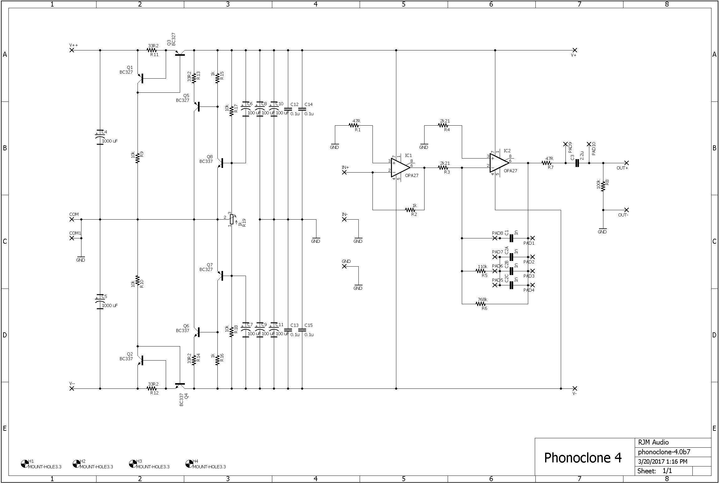

With the standard unregulated supply there is more ripple noise in the output of the Phonoclone4 (pc40b) than the previous version phonoclone 3.5h, or the CrystalFET. This additional noise, while measurable above the broadband baseline, does not produce any discernible effect on the sound quality. Furthermore, it can be eliminated entirely by using a regulated power supply. (I used a Z-Reg board mounted inside the external supply.)
The ripple noise is coupled to the input section of the phonoclone from the unregulated voltage (V++, V--) not the output of the S-Reg regulator section (V+) or the ground (COM). The S-Reg is cleaning up the V+,V- rails just fine, but insufficient shielding and/or spacing between the unregulated supply
and the phonoclone input leads to ripple in the output signal regardless. This was verified by removing C6,7 from the circuit which would be expected to increase the ripple on V+,V- about 10 times and observing that the output ripple noise was unaffected.
I do not know why the pc40b with the S-Reg has substantially higher ripple noise than the X-Reg based pc35h, but I note that the CrystalFET has a similar signal though much smaller. It could be related to board layout, or be fundamental to the S-Reg circuit, or both.
Finally I should report two issues I encountered that made testing and analysis difficult: one is that the connecting cable between power supply and phonoclone, with the Z-Reg at the power supply end, oscillated badly when there was no ceramic capacitor on the Z-Reg output. So caution is needed when using a regulated supply - the result can be worse than unregulated. Second, more obvious, is that the bench measurements tended to show more noise than what I observed when installed in the audio system. This related to the dummy resistors used on the phonoclone inputs, and the length of connecting wires at the inputs, and testing with the cover on or off. It's easy to get led astray measuring changes to noises that don't exist except as interference on the bench test setup.
So that's it: I like the Phonoclone 4. A lot actually. I will use mine with a standard unregulated power supply as per the BOM. There is more hum with the volume turned full up than my other designs however. A regulated power supply will solve this. I do not know how to reduce the ripple noise further while still using an unregulated supply, but it is a matter of separation, isolation, and shielding - exactly what and how much is required is left for future work.

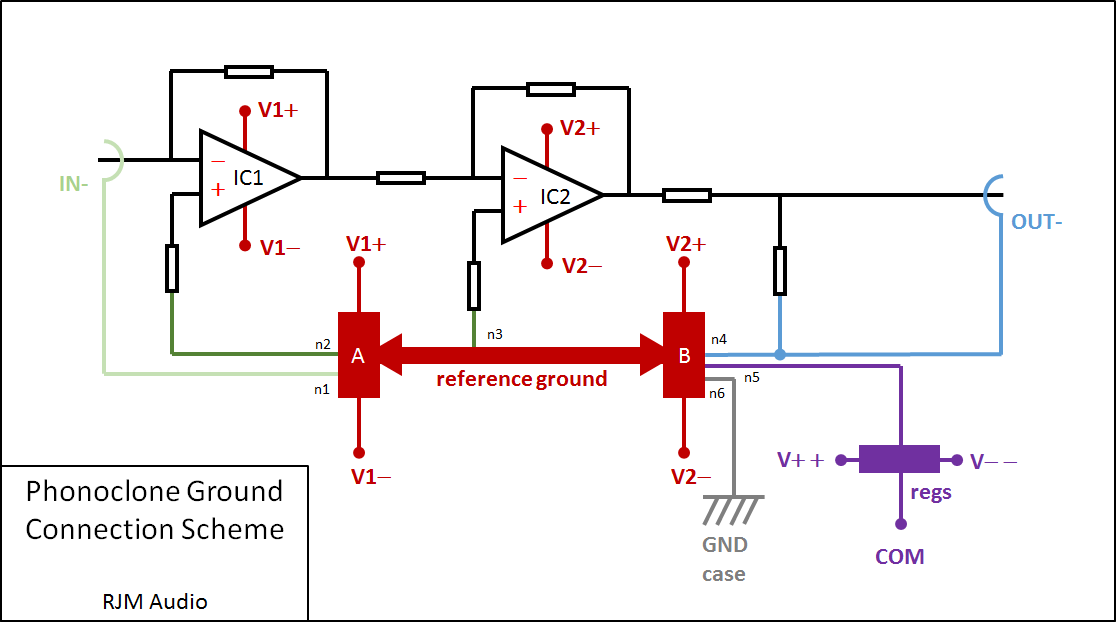

I've been studying op amp grounding techniques and revised my ideas on the subject somewhat.
There are two basic approaches, single point and ground plane. For audio frequencies single point is considered more appropriate, though often mixed with a partial ground plane. Single point is as the name implies - all the returns are tied together a at a common point. The most rigorous version of this idea is called "star grounding" but often what you'll see is the inverting inputs, noninverting inputs, outputs, and power supply each bundled together first in a group before joining to each other.
The problem with rigorous star grounding is that closed loop op amp bandwidth can even for audio projects be up in the region where ground plane techniques would actually have some merit, i.e. the inductance of individual traces starts to be important. Star grounding involves many more long traces than a ground plane, and this can cause problems. A hybrid approach can be something of a best-of-both solution.
The textbook book advice you'll easily find from any web search is simple enough: bypass close to the op amp power pins, avoid daisy chaining grounds, and make current loops as small a possible. Finding a reliable example showing how to do it right is much harder however. The attached pdf from Power Amp Design is the best - most relevant anyway - documentation I could snag on the subject.
The basic point that confuses me is "where exactly is the reference ground point that everything must return to?"
The best answer I can give with my present understanding of the subject is the op amp's positive and/or negative power pins and by direct extension the area of the ground trace the bypass capacitors connect to.
That's where you start, and of course with two op amps like the phonoclone has that means there are two reference points (A and B in the figure) physically separate. These should be as soundly joined as possible, and also - and this is the part I didn't properly appreciate before - only the bypass current should be allowed to flow through this region. The load current, which flows from OUT- ultimately back to COM, should be kept out so as to avoid polluting the reference and thus mixing up with the inputs and causing a ground loop.
So as far as the reference ground goes that means the inputs of IC1 connect back to A, the inputs of IC2 connect to somewhere in the middle, and the COM and OUT- are jointed together at the opposite side of B. I'm still not 100% confident about where the best place for the case connection is, A or B, but I've shown it at B next to the OUT- and COM. It shouldn't matter if everything works as advertised such that no load currents flow in the reference.
That's a formal scheme developed for a power op amp chip. A line level circuit like the phonoclone or VSPS should not be nearly as sensitive to load currents as they are so much smaller, but it must be said that phonoclone 3.5h layout followed this arrangement more rigorously than the 3.8 and 4.0b layouts where the COM and OUT- were placed at opposite sides of the board with the bypass caps in between. What that amounts to in the diagram below is connecting OUT- at A rather than B.
As well as all the above consideration, there is still the matter of current loop area to be considered, though in looking over my previous layouts there's nothing there which is terrible in this respect. Loops are generally pretty small. Also, the bypassing arrangement should be fine for the op amp bandwidths in the RJM phono stages, which is only about 300 kHz.

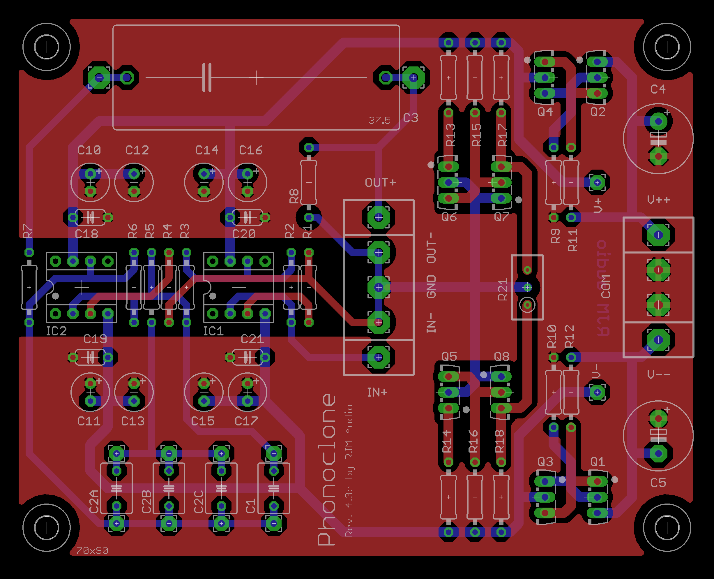

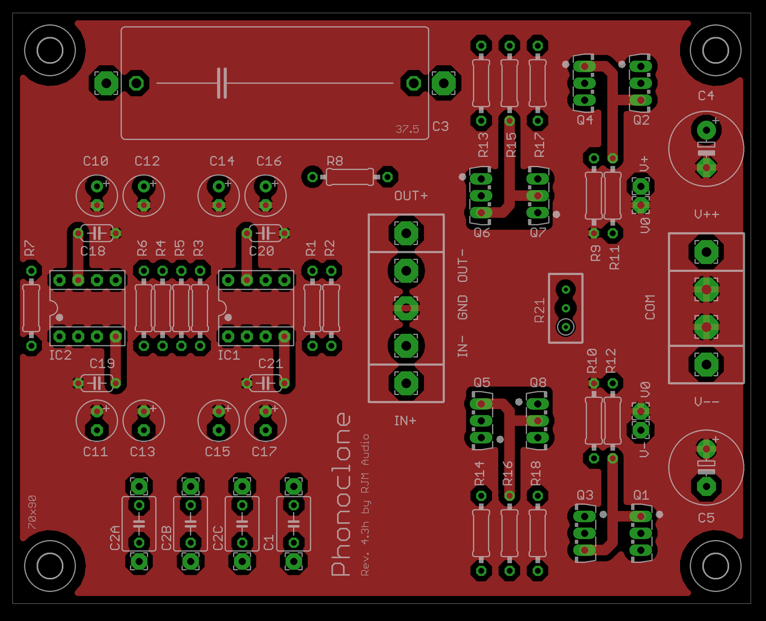

This is my latest layout for the phonoclone 4. I'm not really convinced this would make any difference, but it addresses the following two concerns:
The return connection is rigorous and centralized like it is in pc35h. In particular the S-reg output section Q5-8 and R21 are connected to the reference directly with a dedicated trace.
The V+ and V- planes are replaced with traces. I'm ambivalent, but the argument goes that having the voltage rails spread out over a wide area increases likelihood of noise coupling to the input.
Residual concern is inverting and non-inverting traces run on top of each other on opposite sides of the board. Generally you want them physically separated.

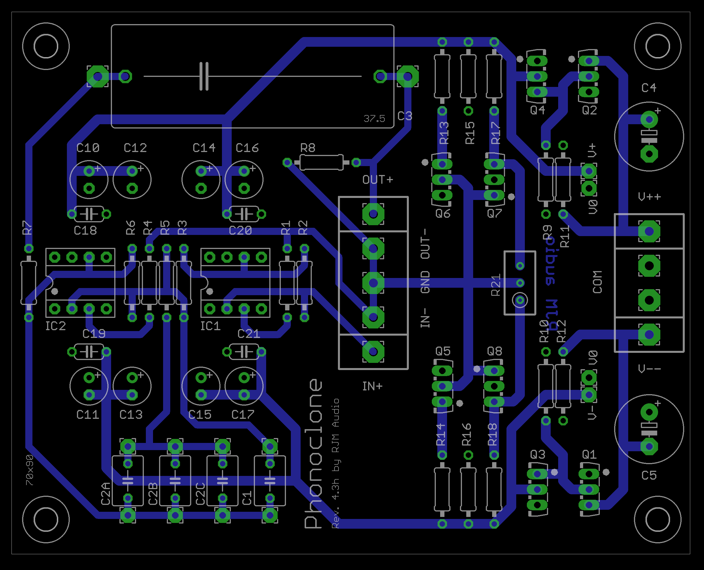

Granted, but EFI/EMI isn't so much the problem: ripple is. Ripple transmitted from the regulator and/or environs to the input section by methods unclear.
Layout 43h improves the ground plane coverage and puts all the signal traces on the bottom layer with the inverting and noninverting well separated.
The only downside here is a couple of instances where the noninverting signal traces duck under the V+ and V-. As for loops - the ground plane ensures current loops are minimized, at least inductively.

But how does this interference get into the input signal? How is it that it interferes? The physics I can grasp. What I can't figure out is the specifics relating to the board layout: the "this loop here radiates and is picked up by that loop there..." of it.

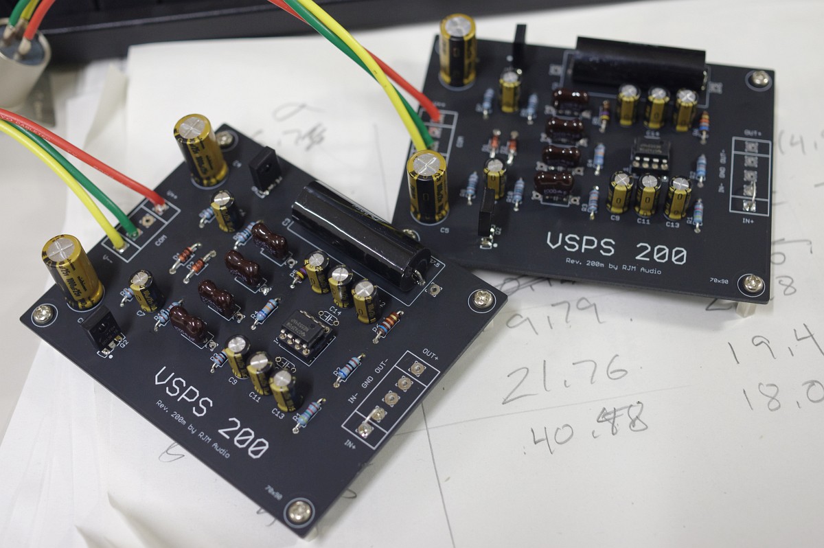

A big delivery of boards arrived this morning, including the new VSPS200m pictured. The quality from pcbcart continues to improve, with polished edges, high resolution printing, and a thick matte finish... nicest boards I've yet handled.
