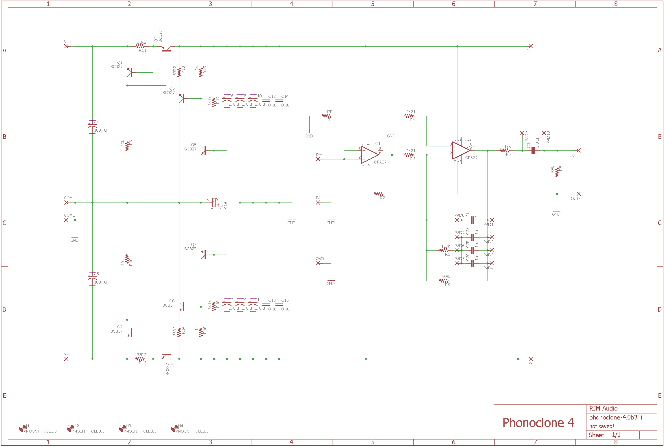

Today I built a fresh pair of phonoclone 4.0b boards and installed them in the old chassis. The component position was stock, but I changed quite a few resistor values.
R11-14 -> 33.2 ohms, reduces source current from 28 mA to about 18 mA.
R15,16 -> 1k
R17,18 -> 6.19k, I had the value on hand, and wanted to reduce V+ to allow the S-Reg inputs to be powered off 12 V supplies if preregulation is found to be needed later. The V+, V- are now 8.45 V.
C3 is 3 uF, as before, as that's the value I have. OPA27 reused from before. I matched Q7 and Q8 between channels to get the S-Reg outputs to be the same for both channels. Last time I had half a volt difference L/R for |V+| + |V-|, this time its 20 mV. I suspect I smoked a transistors last time.
I also replaced the ratty RCA jacks in the chassis, redid the ground wires with heavier gauge, and will wire it up with "extra twisty" 24 AWG solid core copper pairs for the I/O. This is made by unwinding the internal pairs from CAT 5 cables and hand-twisting into a tight spiral. If that doesn't work I'll move to the shielded cable I have, but it's terribly stiff to work with, I hate it.
After checking the DC operation (no issues) I quickly verified that there was no hum visible for a 47 ohm dummy load on the input. I had the case open however so not a final statement, but only as a "so far so good" progress milestone. This stock board layout is no worse than my modified version at least. It's now cooking overnight to settle in.
Tomorrow I will complete the wiring and run noise measurements.

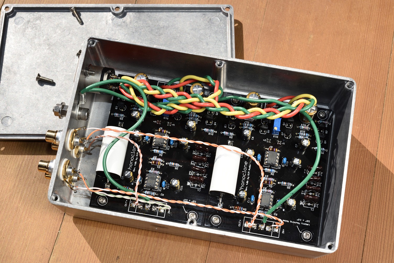

Phonoclone 4.0b mk II
Here you see RJM on his best behavior re. cable dressing, though none of it is shielded, just twist/braid.
And so, not only is there no hum but it sounds way better too. I have no idea why, either, but this version at least delivers what I had hoped for: clear and spacious, fast and dynamic. If it errs at all it is for being a bit too "brassy", but overall it is simply better than previous iterations. Best part is the "non op amp-iness" as sonically there is none of that grit or grain I associate with ICs, so from that point of view the S-Reg shunt seems to doing what it is supposed to be doing.
@Erik I don't see how any of the resistor changes could have made a significant difference to anything, but if you are wondering if I have any better explanations or advice at the moment the answer is no. All I can report is I have got my S-Reg powered phono stage working without any additional shielding or modifications of the board layout. At this point I'm starting to wonder if it wasn't something associated with solder messiness in my case, where flux or solder got somewhere it shouldn't have.

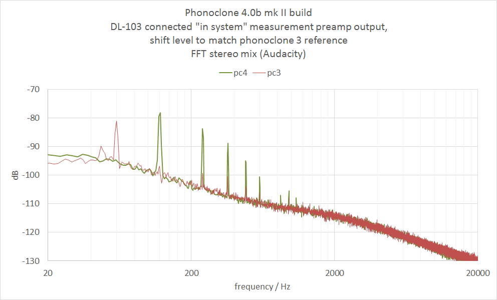

Ah, measurements. At least we see where we are.
A. Not bad, not super. The ripple voltage is visible above the noise floor, about 15 dB or more higher than for the X-Reg powered phonoclone 3. This is audible with the volume all the way up as a small amount of hum/buzz over the background hiss/rush.
I'm conflicted on this. No, on one hand it's not acceptable, but on the other it's really close to being acceptable.
What I will do next, for the purposes of experimenting, is to power the whole thing off a Z-Reg. I fully expect that to banish the hum, but I'm curious about how it will affect the sound.
What are the frequencies of the spikes?
50, 100, 150, 200, 250 etc?
The one to the left of 200Hz is about 20dB (10times) worse and the one to the right of 200Hz is about 15dB (5times) worse.
Is the plot of Noise + Hum showing ~1mVpp, or ~0.3mVrms?
The power cables in post3636 are braided. Is it worth re-testing using twisted triplets?
What are the two green cables taken to the bolted chassis connection?
The loop areas of the input/output socket terminations are very big.
Could you do a retest with these made very much smaller?

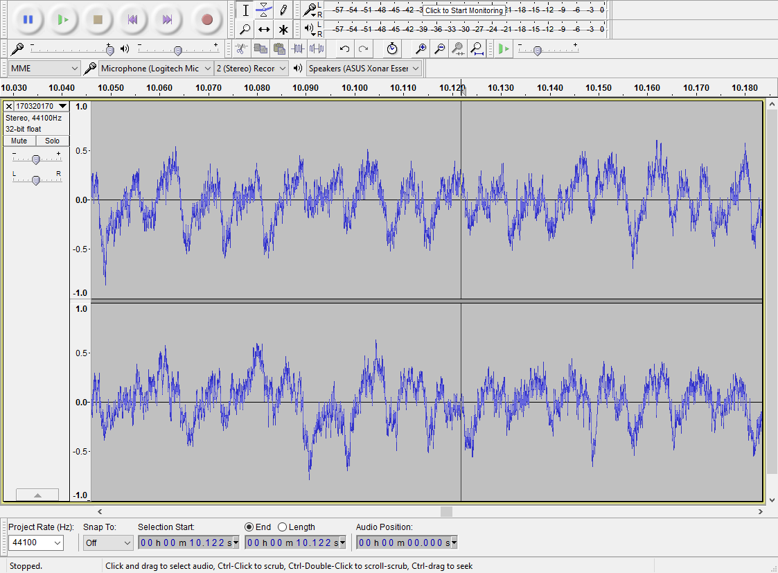

The pc4 FFT trace is from the waveform shown in the screen capture also attached, a 120 Hz triangle wave close to what is seen in the S-Reg power supply, the filter capacitor charging current.
The absolute magnitude cannot be read from the screen capture scale. (long story, I was not going to move my desktop PC over to the stereo system to measure this so I collected the data with my Kenwood digital recorder and scaled it to the noise floor of the pc3, calibrated data I had archived previously) It is estimated at -80 dB, 20 dB above the baseline noise floor.
